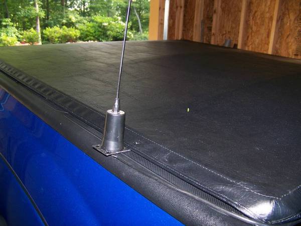

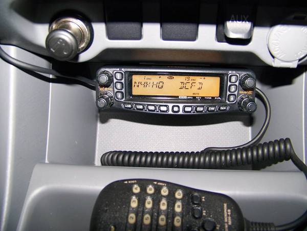

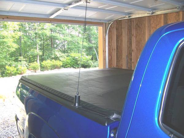

    Finished installation of Yaesu FT-8800 Dual Bander in 09 DC/
    73
    Mac
