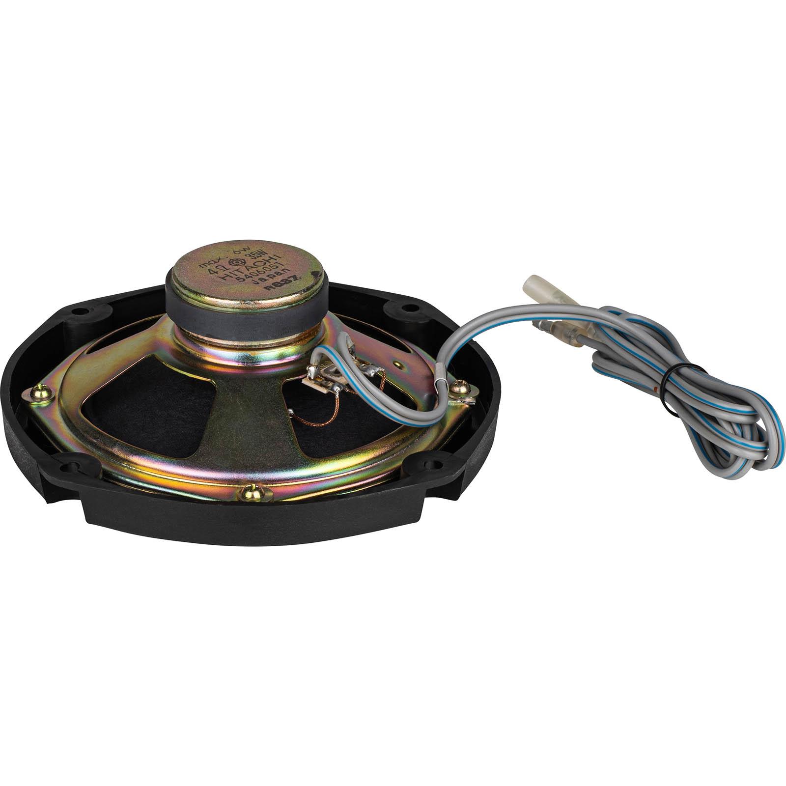

    lol, all i'm going to say is that rockford doesn't compete in sq events, so those terms tend to be extremely contradictory...

    Fancy whizzer cone there, lol. Wonder if that's 20 watts peak or RMS. :rolleyes:

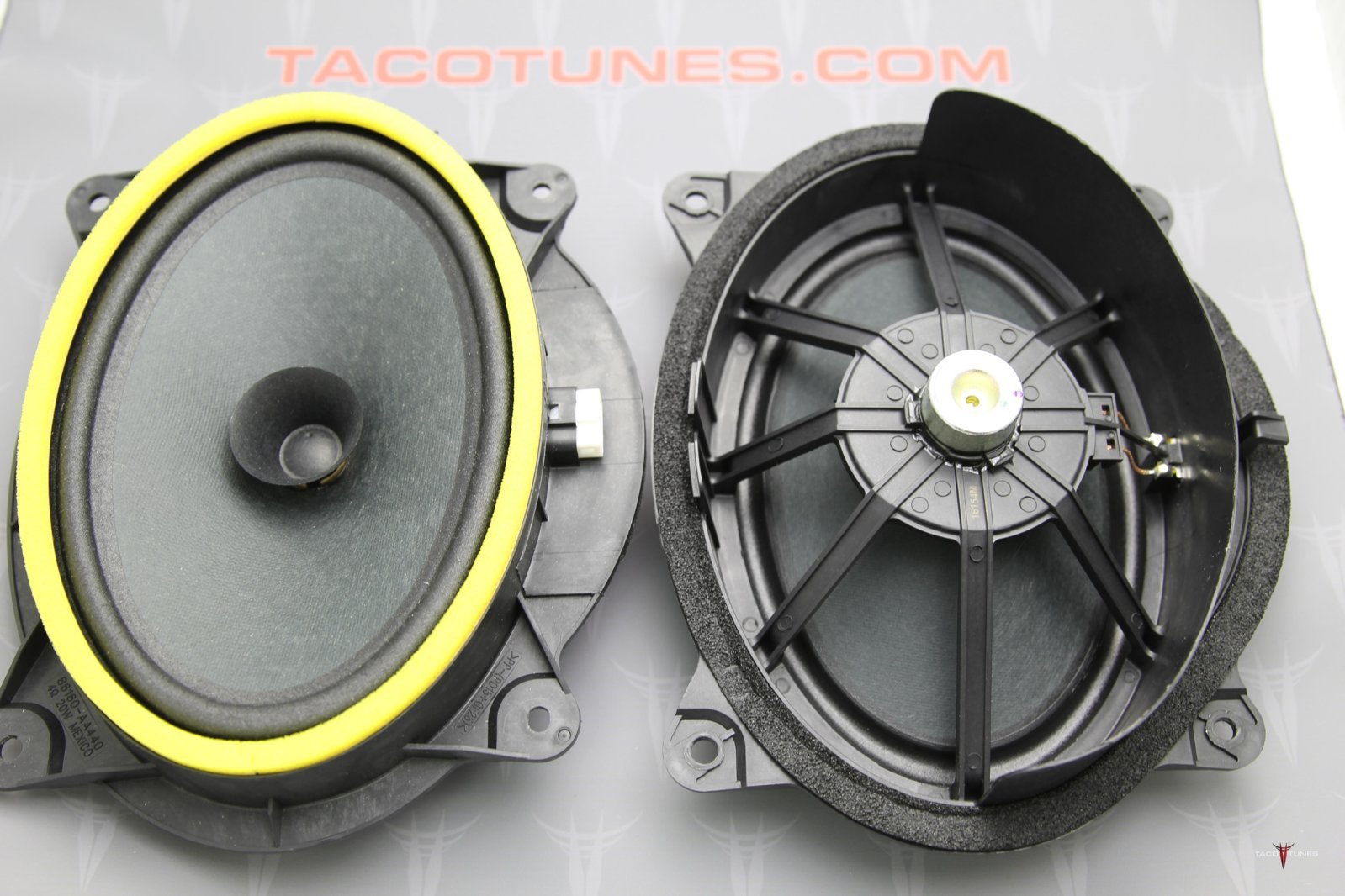

    The magnet on this bad boy is about 10x the size of the Tacoma speaker… that said I changed out the speakers with quality kicker units and it was only a moderate improvement. The tweeters offer a massive improvement as does a small sub

    neodymium magnets have a significant magnetic advantage over older ceramic magnets. just because it's smaller doesn't mean the forces are less.

    Its a neodymium magnet. The lowest grade neo magnets are still 5-6 times stronger than a ceramic magnet found on many after market speakers. Higher grade neo magnets are way way stronger that that too.
    Many high end speaker companies use neo magnets as they are denser and can provide a more confined magnetic field for the voice coil to sit in.
    For toyota, they can use a neo magnet over a ceramic magnet and save a couple of pounds of weight without making the speaker worse. In fact, toyotas speakers would sound just as terrible with a giant ceramic magnet on them.
