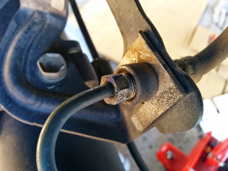

  15. Dec 4, 2015 at 8:07 AM

    The hard-line nuts, are they righty tighty, lefty loosey?
    Pic attached.
  16. Dec 4, 2015 at 8:09 AM
    #2036
    Rhyno
    Rhyno Well-Known Member
    Apr 28, 2015
    #154117
    2,304
    Shane
    2008 Tacoma DCSB TRD Sport
    Yes sir, spray them down with some penetrating oil and make sure you use a flare-nut wrench, not just a typical open-end wrench.
    Crom[QUOTED] likes this.
  17. Dec 4, 2015 at 8:12 AM
    #2037
    gordi
    gordi Only had a wheel fall off once
    Jul 16, 2013
    #108373
    2,905
    Josh
    North Idaho
    2011 DCSB trd sport
    Fox 2.5 extended travel, dakars, rear 5125 255/80/17 cooper maxx ST
    honestly i used penetrating oil a few days in a row on them and it helped a ton. But the flare nut wrench i used had a ratcheting mechanism from craftsman and it was trash and started to strip the nut. Why toyota didnt make it bigger is beyond me. I ended up using a regular 10mm box wrench and an adjustable with no issues. I did see at the auto store a single 10mm flare nut with no ratchet mechanism which would of been better im sure but it was doable on my mud crusted 2011. a pair of vice grips also was used.

  19. Dec 4, 2015 at 8:16 AM
    #2039
    Crom
    Crom Super-Deluxe Member
    Jun 22, 2009
    #18782
    9,642
    Nick
    San Diego, CA
    2009 4x4 DCSB Camp Supreme
    Millions
    In my picture if you look carefully, the nut is already deformed. I tried penetrating oil, but my problem was finding a quality flare but wrench. Fucking quality control doesn't mean shit anymore. I'm gonna do what Gordi did or use vice grips.
    Thanks for confirming that I wasn't wrenching the wrong way.
  20. Dec 4, 2015 at 9:08 AM
    #2040
    gordi
    Jul 16, 2013
    #108373
    2,905
    Josh
    North Idaho
    2011 DCSB trd sport
    Be very careful with the vice grips. Also with the flare nut wrench junk i assume maybe a non ratcheting one is better but i didnt have the time or didnt want to go back. 10mm wrench but then i also had a buddy or my other hand pushing the nut into the wrench from the open part of the wrench. the back ones were a bitch bc where they are and the front ones were butter, almost more loose than i expected, but 11ftlbs isnt much. The rears were the hardest and i just let the brake fluid drain from them as i worked while filling the front reservoir so in the end it got a full flush and not just a bleed. I used a different color fluid also so i knew when it got through.
