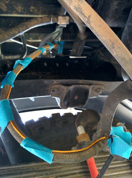

    The stock length rear brake lines on my truck measure out to 18.5" when I take octaco ext lines and subtract out the flared connectors, they measure out to 21.5".
    In essence they are exactly 3" longer than stock.
    So I think I'm good to start wrenching.
    Pic attached to show how I measured.
