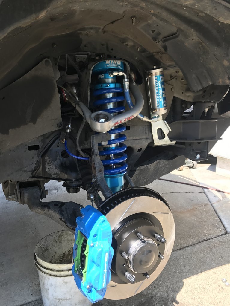

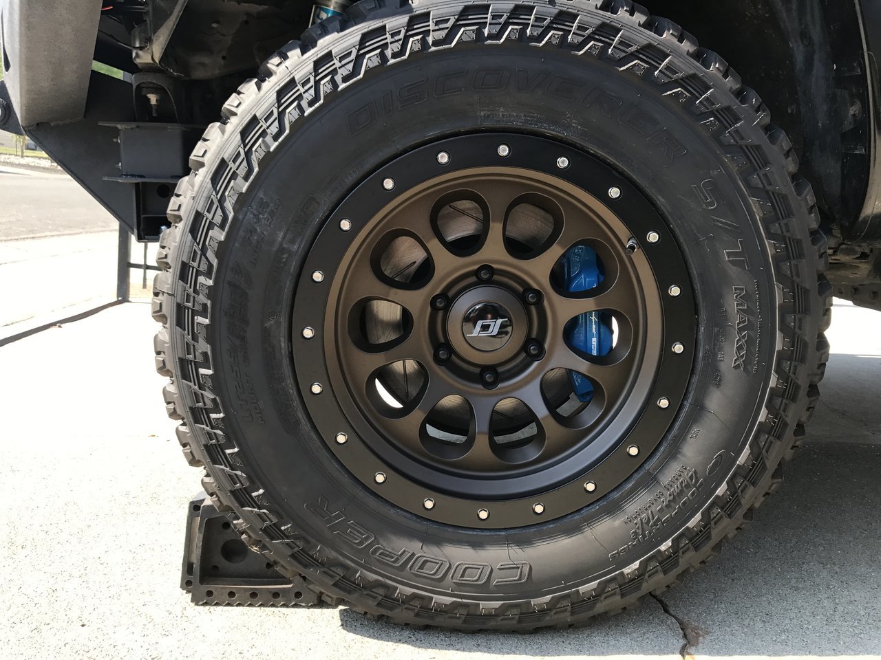

    The drivers side hardline from the caliper to the rubber hose, one of the flares was toast from the factory. Ran to Napa and grabbed a premade 8" hardline and bent it into shape.
    These lines work just as advertised and are great. Along with my 2014 T4R "BBK swap" these feel great
