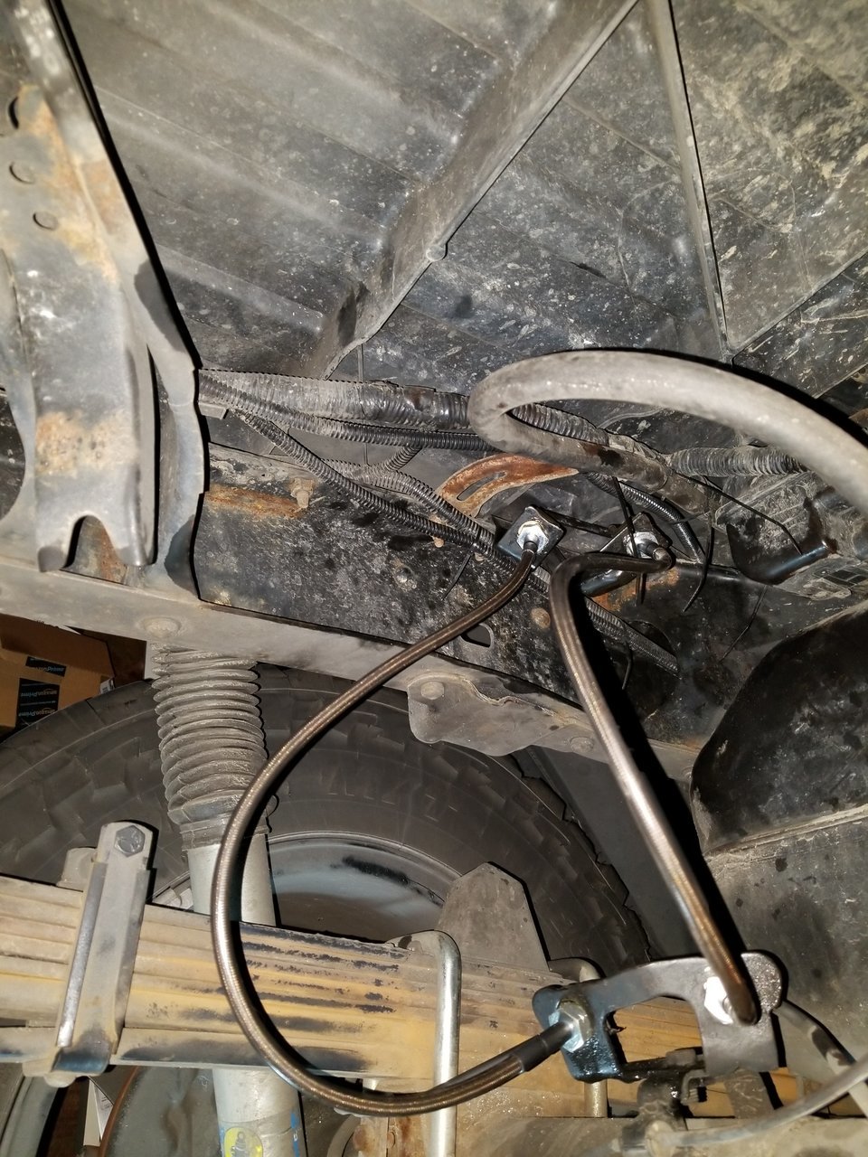

    I just got mine. The fit problems you had are a bit concerning. Anyone else have this issue?

    I had this issue today when i had mine installed. We had to use zip ties to keep them from moving around in the oem clips since i didnt have any washers on hand. Other than this minor issue, great quality lines and fittings

    I had a little opposite problem. I had to enlarge the holes on the front mounting brackets in order to get them to fit through. Wasn’t a big deal, just took a few min with a dremel

    Mine came yesterday and I put them on today. Had to bend the old retainer clips so they had more arc, but once I did that they went on just fine.

    I thought about that but since that metal is so thin, I didn't feel comfortable that it would hold securely long-term. I guess it worked OK for you though.
    The Crown lines my friend bought came with new retainers that were twice as thick.

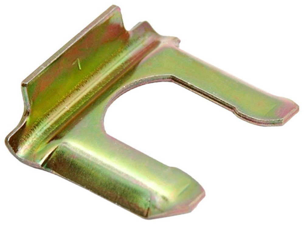

    Got mine today. Super fast turn-around. Full set of extended lines. Fit perfectly with a new set of these. Had to use a hammer, and it was kinda a tap it while guiding the clip in while holding the hose end in the bracket. Once I got the clips started, they tapped right in. Thank you!

    Nice I added those to my Amazon cart.

    Mine fit fine but somehow lost a clip while on a trail. It’s just zip tied in place now

    That was my fear and why I used the bushings but those clips on Amazon look like they'll work well.

    Nothin really happens when the clip falls out but yeah those clips look nice
