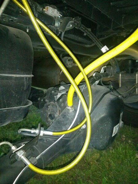

    It took quite a bit of work to install these myself. Here is some flex out picks i took for another thread. Got plenty more room here!
    Some tips i learned: dont cheap out on flare wrenches such as duralast. They flex too muxh and you cant tighten them enough to prevent leaking. This leads to leaking and rounding off nuts. I found all this out when i took the truck into get the stripped nut fixed. When they went to powsr bleed thw brakes they noticed it was leaking leaking around all of the ones i did.
