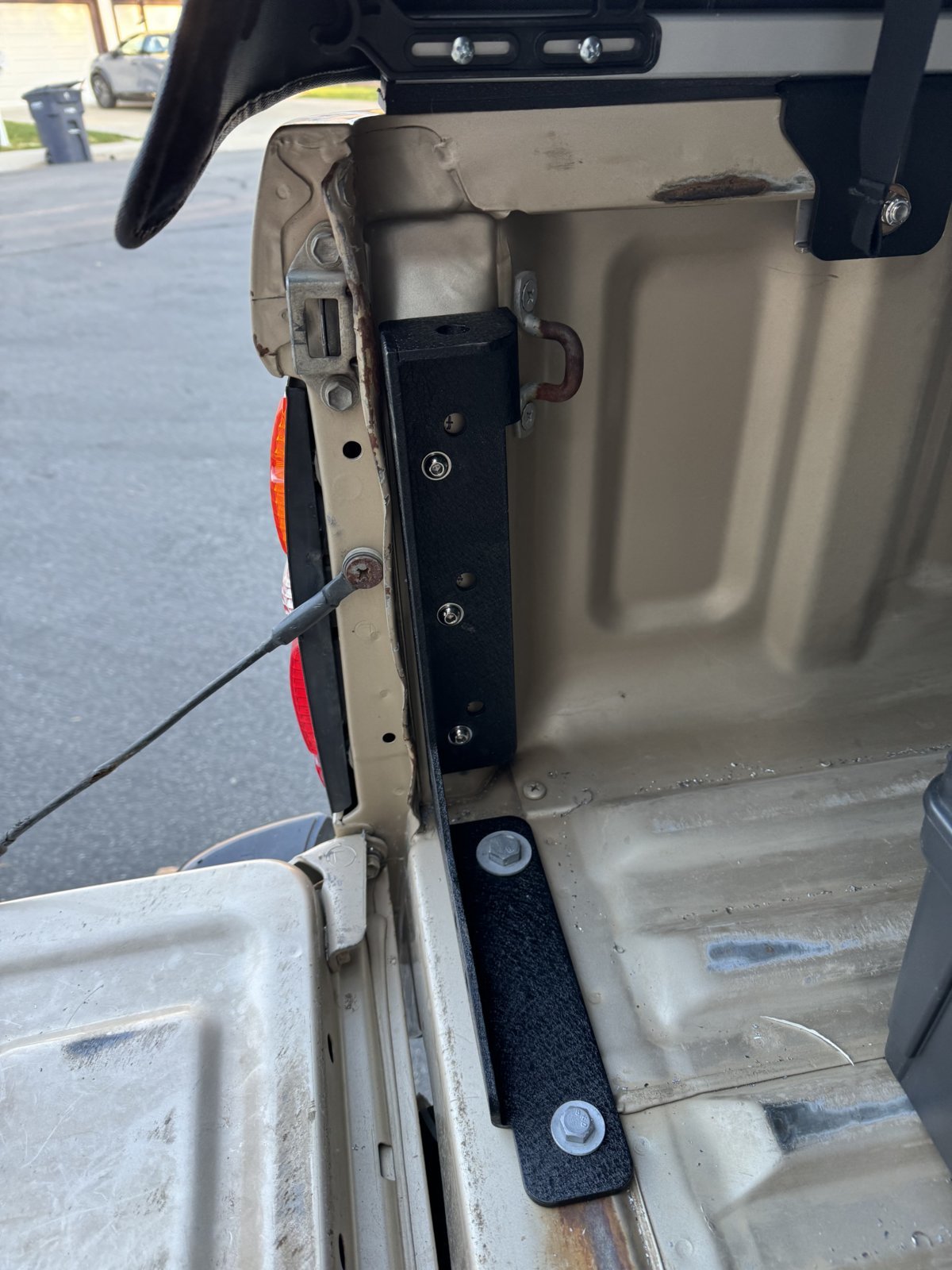

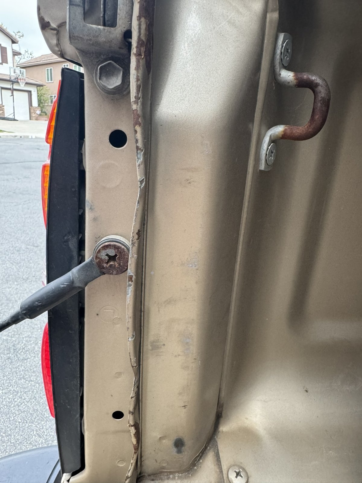

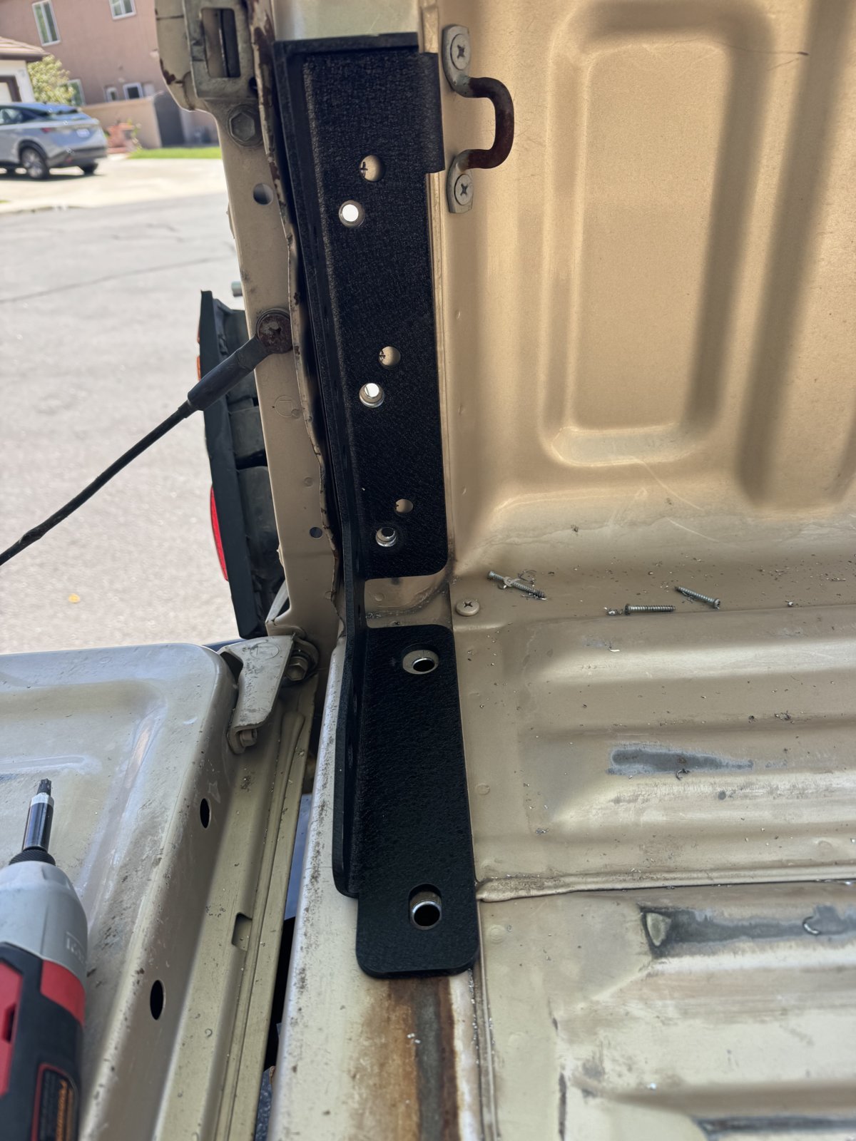

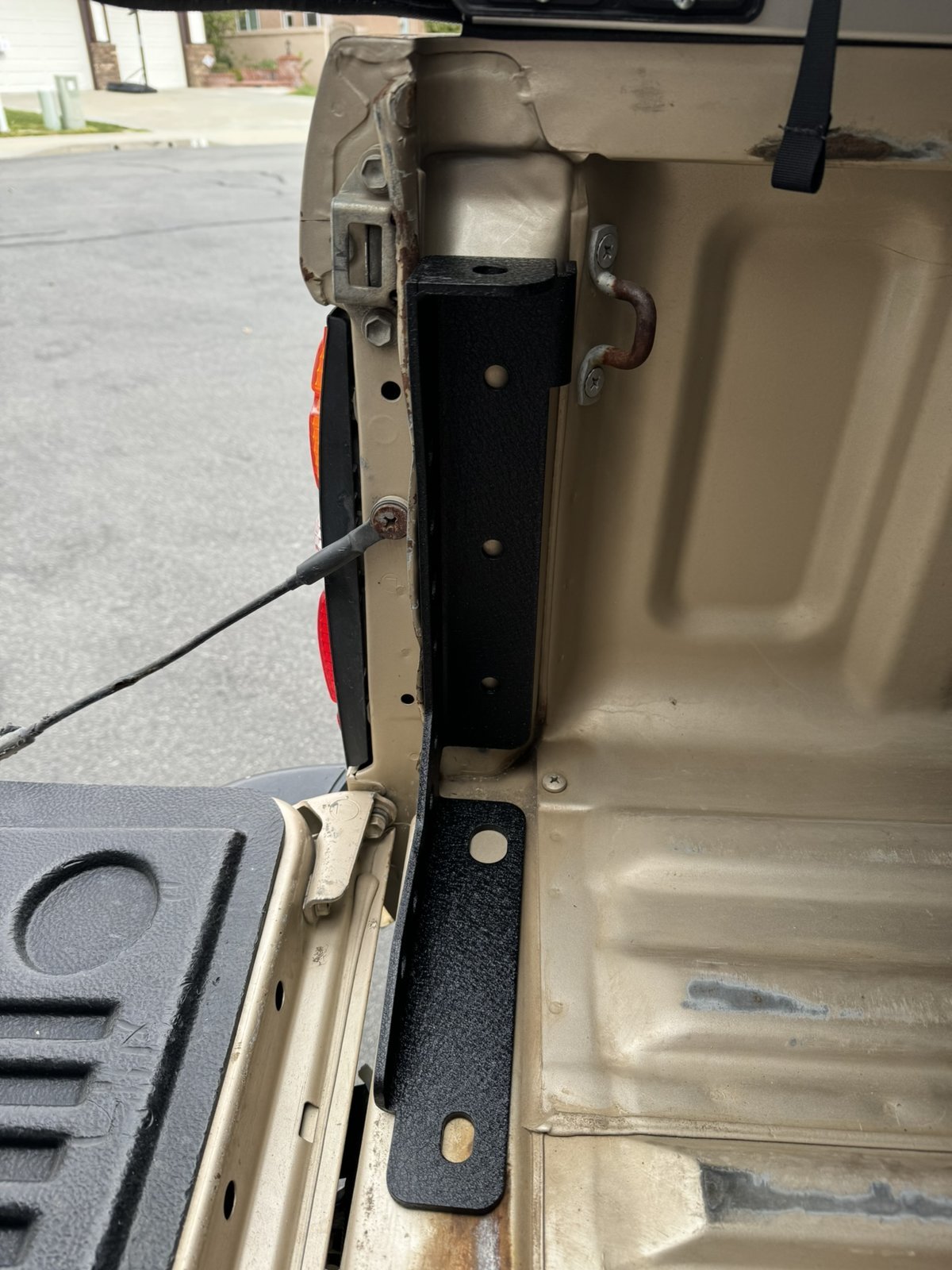

    Little update for those who are interested... Brackets came in today.
    Notes on Fitment:
    On the vertical strut that goes up the side of the bed, there are three holes that, unfortunately will not suffice for first gens (they partially go over where the metal curves). However, I believe I can redrill new holes holes closer to the inside corner of the bracket which should go right over the flush, flat part of the metal. As far as the holes on the bottom side of the bracket go, they will totally work (read hardware notes for more info on those).
    Notes on Hardware:

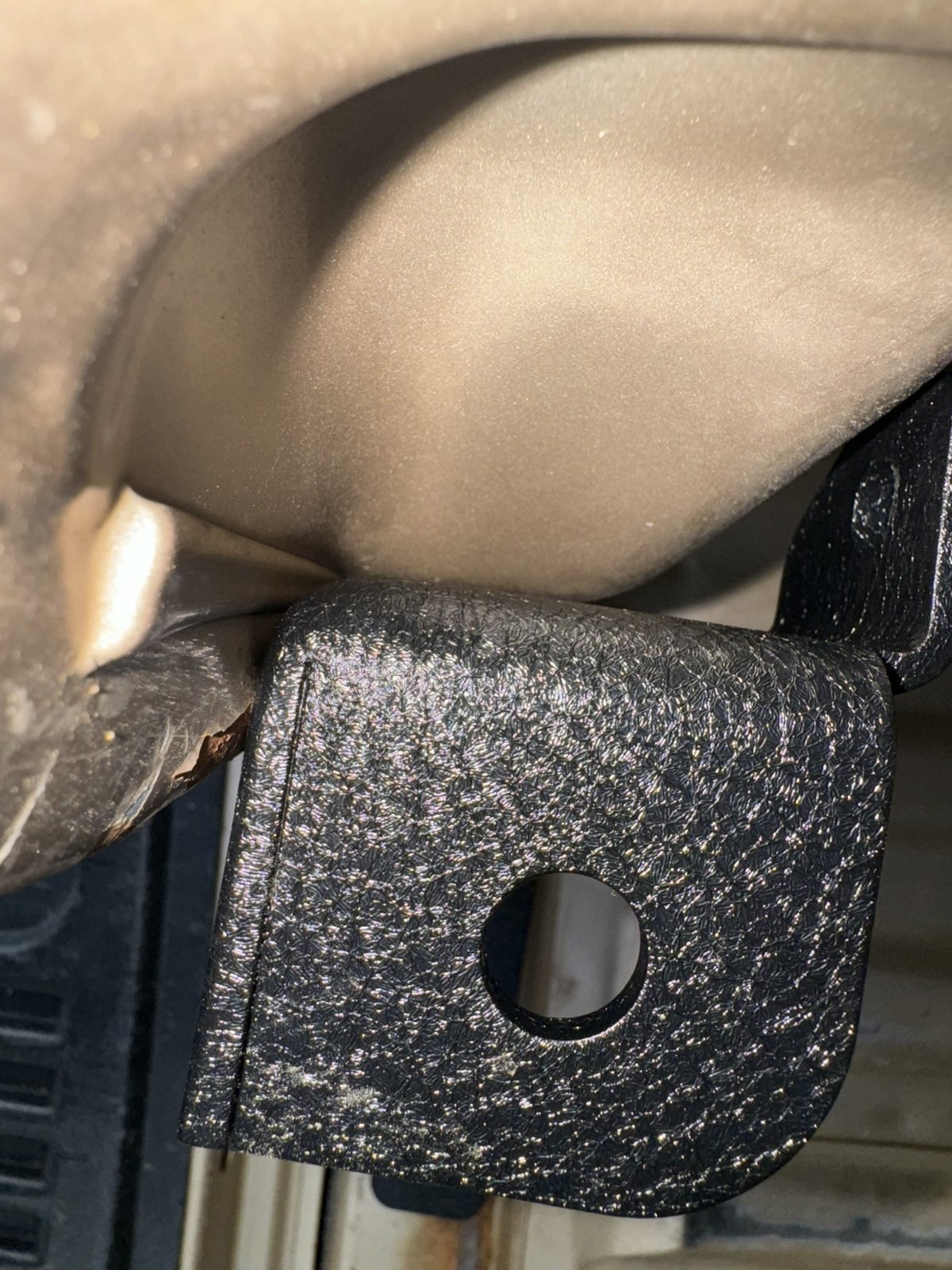

    The kit comes with bolts and nuts for the vertical part of the bracket, but it does not include hardware for the bottom side. This is because, unfortunately, the kit is meant to go with the bolts already included on Second/Third Gen trucks. That being said, I'll have to go to the hardware store and buy decent enough bolts/washers to make that work (you can see the holes are much bigger on the bottom to accommodate the stock bolts for the tailgate on newer trucks.

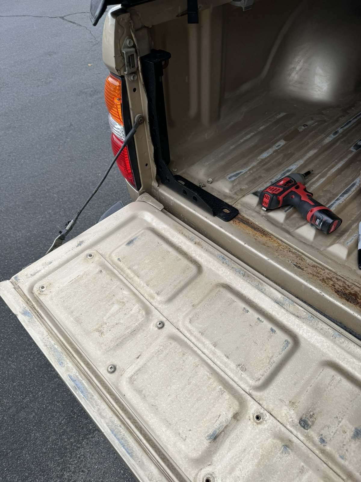

    As you can see in the photos below, I had to remove my old OEM plastic tailgate cover, otherwise the tailgate wouldn't close where the brackets were. Keep that in mind. Also, that little bracket that wraps around the top side - the one people thought they'd have to bend - it actually doesn't look like it'll get in the way at all :D
    All that said, with a bit of modification. I am thinking these will work. Kinda nervous to drill into my truck, lol.
    I'll take better photos when I install. Please ignore my rusted bed and dent-to-hell tailgate... previous owner wasn't kind to Bupkis ;)

    You might see how those fit up by swapping left/right. On my Rago's, the fitment was better installing opposite their instructions. (Remember, these are designed for multiple generation Tacos).

    He'd have to cut the ear off to bring the holes about 3/16" closer to center
    But "multiple" gens is a stretch; 2nd and 3rd are the same

    i was worried thinking the bed sill panel is 'encapsulated' but i just looked at mine and access NP from bottom
    pretty sure if the tail lamp removed, you will have access to vertical inner bed panel too
    think your fine!

    Yup. Plenty of room underneath. Just bought some hardware to make up for the missing stuff they don’t send you. I’ll prob install by the end of the week.

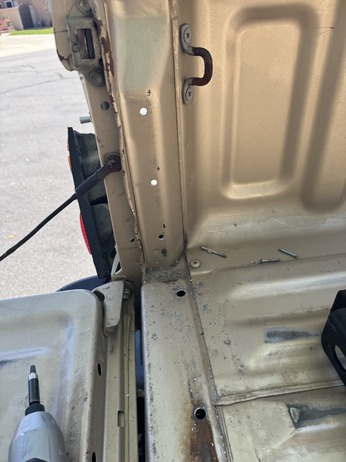

    UPDATE !
    Alright, so, I got the stiffeners installed! Like I mentioned before, I had to drill new holes for the upright portion; other than that, nothing had to be adjusted.
    Therefore, I hereby conclude that these stiffeners totally work for First Gens if you’re willing to put in a bit more effort into measuring and drilling :thumbsup:
