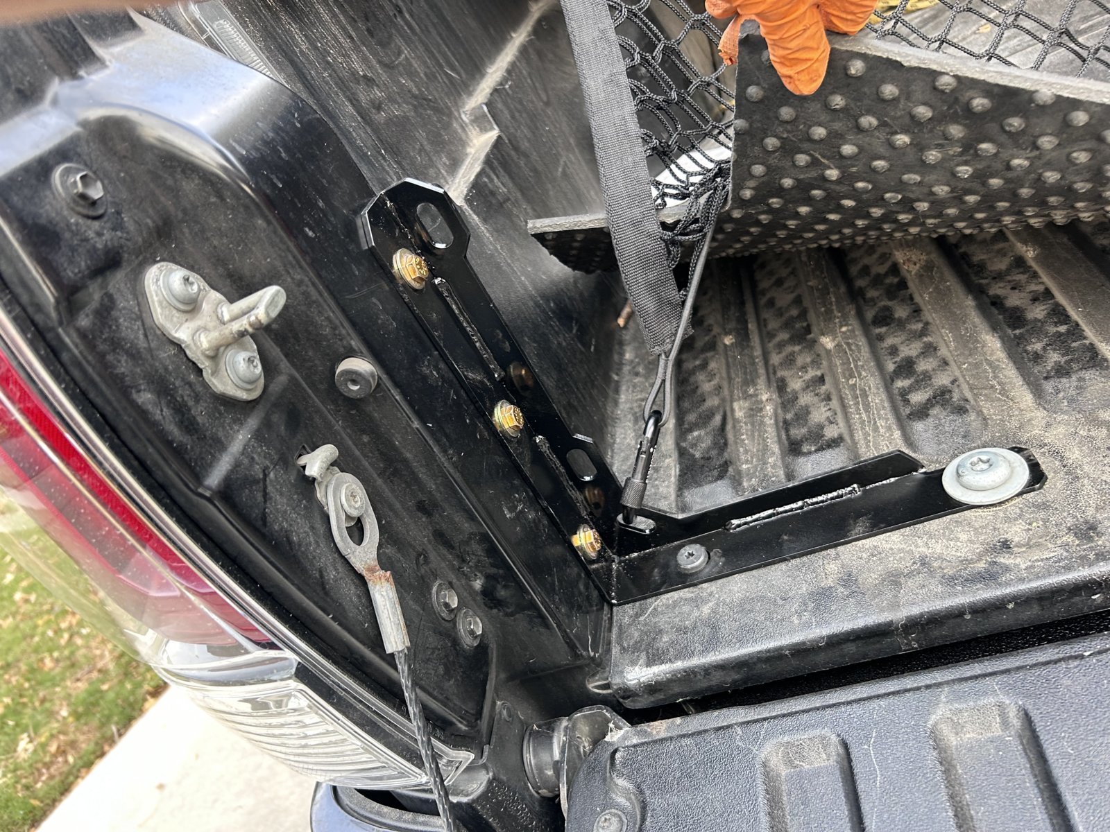

    Are you securing them with bolts on the other side? What are you drilling into?
  10. Apr 25, 2024 at 4:36 PM
    #50
    Kwikvette
    Feb 27, 2019
    #284735
    82,912
    Fresno County
    4 run, 2 don't
    First bunches were sold without any hardware, with a disclaimer stating you will need to provide your own hardware. After several installs I got some feedback (per my request) and began to provide hardware -
    For the vertical legs that mount alongside the taillight areas M8 x 16mm x 1.25 stainless bolts, nuts, and washers
    For the bed bottom area I provided M10 x (forget the length, maybe 20mm) stainless bolts, nuts, and washers
    So a total of six M8 nuts and bolts, four M10 nuts and bolts, and ten washers.
    You just place your stiffener in the area you wish to install them and mark where you'll be drilling. Place a washer on the side you run your bolt through, and fasten the nut on the backside and call it done.
    This is a set where I did not provide hardware, hence the missing washers.
    For 2nd or 3rd Gen, my buddy used different hardware for his installs (I provided several sets to him for local install) but I believe only the vertical legs need hardware as you can reuse the bottom stock stuff.

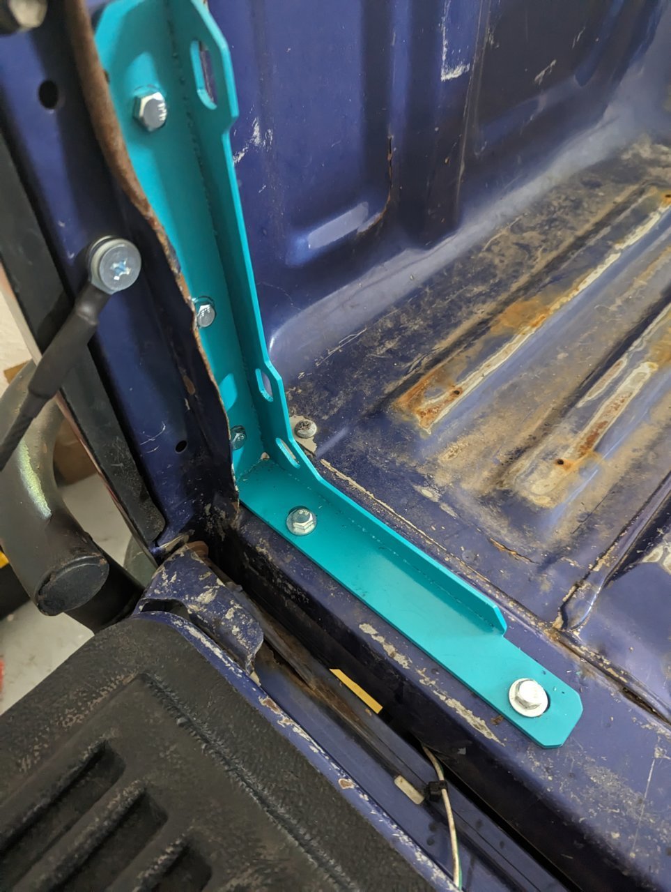

    I've got the Amazon ones installed on a second gen, they're pretty decent for the price. Like kwickvette mentioned they could be better designed in the corner of the gusset but for the price they're a bargain and their metal thickness surprised me considering they're more then likely chinese. My truck is 17yo and there's little if any bed side spreading so I don't expect issues. The way the 2nd gen is a piece together bed I see them being just as useful for keeping the bed components cinched together securely in that area with some stout metal.
