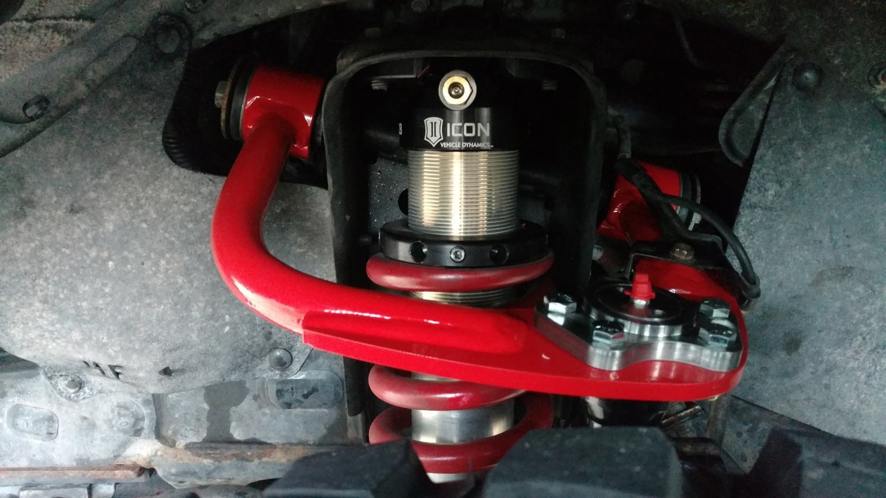

    Be sure to check out JBA UCAs as well. I've been running them with extended travel icons and love them. They claim more articulation than uniballs.
    Edit- NVM they are 2nd gen only :(

    is it just me or does the jbas look like they have little tire clearance. looks like even less than stock

    Great point, I'm on stock trd wheels with 35/12.5/17s and I need 2 inch spacers to not rub on the UCAs. I had 1.25 inch spacers back when I had 33s. I'm sure proper backspaced wheels would fix that, but certainly something to consider.
