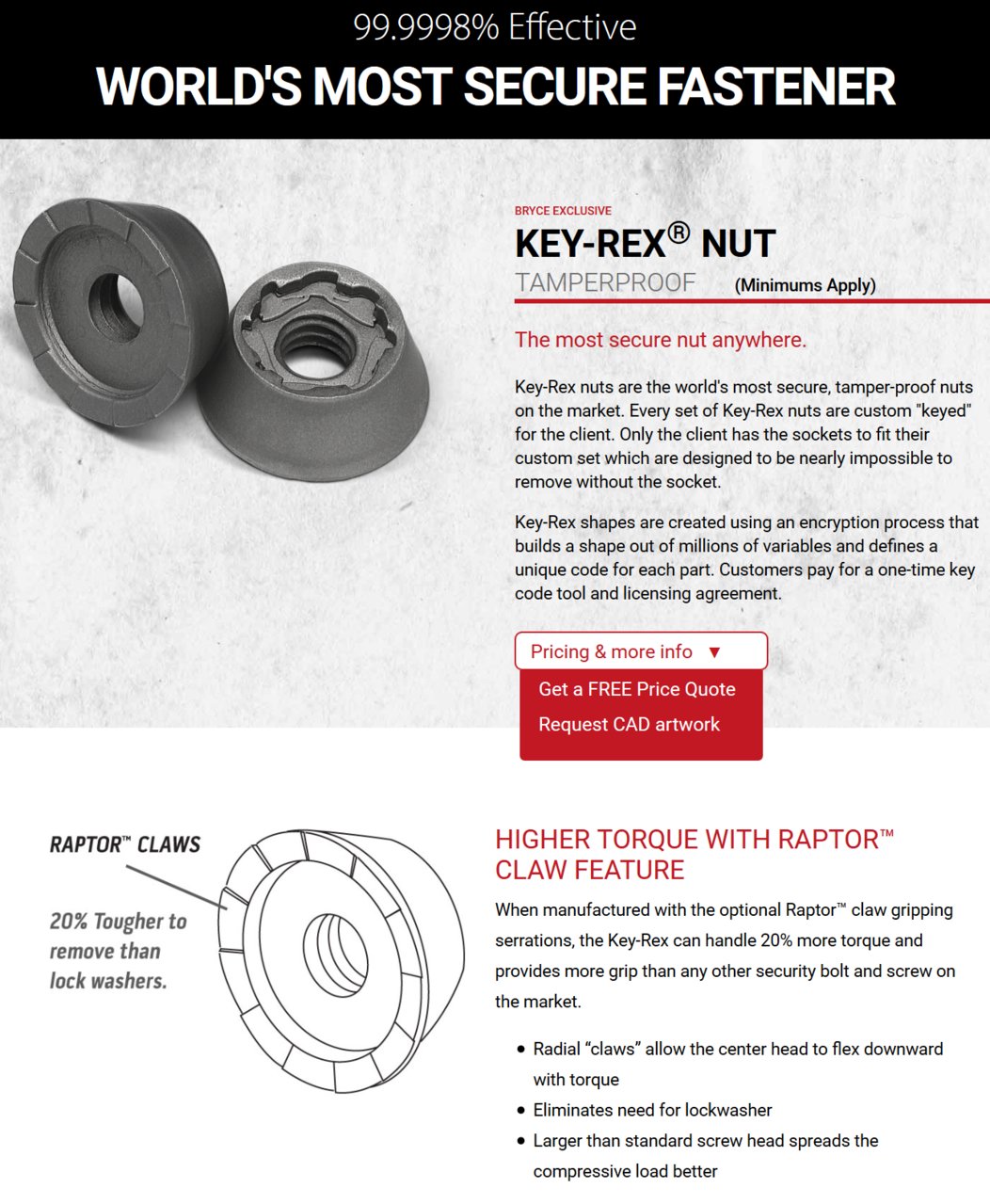

    I'm trying to figure out how to theft-proof my recovery board mounts.
    Here's some food for thought.
    A company that makes lockable nuts. They have other lockable nuts and it looks like minimums apply.
    Maybe a group buy is in order if enough people are interested...
    https://www.brycefastener.com/key-rex-nut.html

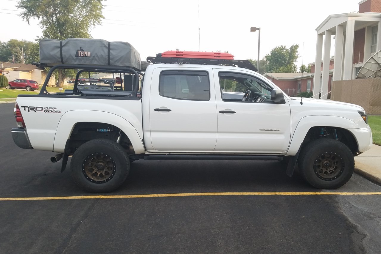

    I used a thick piece of plexiglass we had laying around the shop, drilled some holes for 1/2 inch carriage bolts to run through the mounting holes, and some 1/4 inch holes to mount via carriage bolts to the prinsu rail slots. Basically creates a poor man's "load plate" like Prinsu sells.
    The 1/4inch holes are hidden under the boards when mounted. I then used the plates off some 1/2 inch U-bolts I found at Lowe's to hold the boards down and keep them tight with wing nuts.
    Best pics I got at the moment:
    You can see the wing nuts sticking up:
