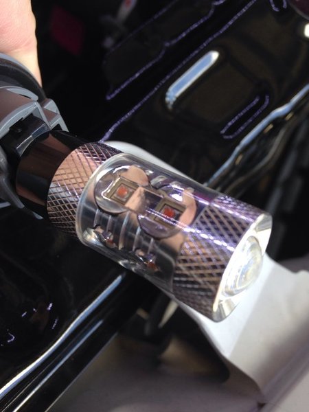

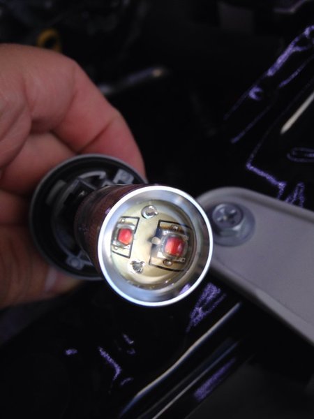

    This is for everyone who's considering converting their turn signals / DRLs to LEDs. After some experimentation I ended up with running single 3ohm resistor is the taillight cavity and haven't had an issue yet. For those trying to mess around with a new flasher or don't want to run resistors front and back this is a really good alternative. I like running my DRLs and having the resistors in the back don't come into play therefore nothing heats up unless the blinkers are actuated. the hazards run off a different relay so being stranded and having them on for an extended period of time isn't an issue either. My truck is a 2015 so YMMV with other applications.IMG_2007.jpg

    Correct. I did I direct swap of both the front and rear turn signals to 4157CK LED front and 3157 LED rear. Fronts are as easy as popping the hood and twisting a connector. The rear unscrews with two 10mm bolts. Once out pop the turn signal and replace. Once back in you tap both turn signal leads and jump them with a 3ohm resistor. Double stick tape the resistor to wall in the cavity next to the tailgate. It doesn't need to be screwed in as one might think because the resistor doesn't generate any heat unless the blinker is left on constantly. The DRLs function properly with full brightness and the LEDs will dim when your selector is switched to the parking or headlight position.
