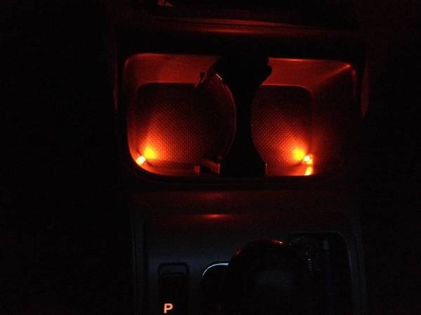

    I installed some of these in my truck in cup holders, side of each footwell, and a few other places

    My orange LEDs in the footwells don't really make anything hard to see. They work really well and aren't distracting at night

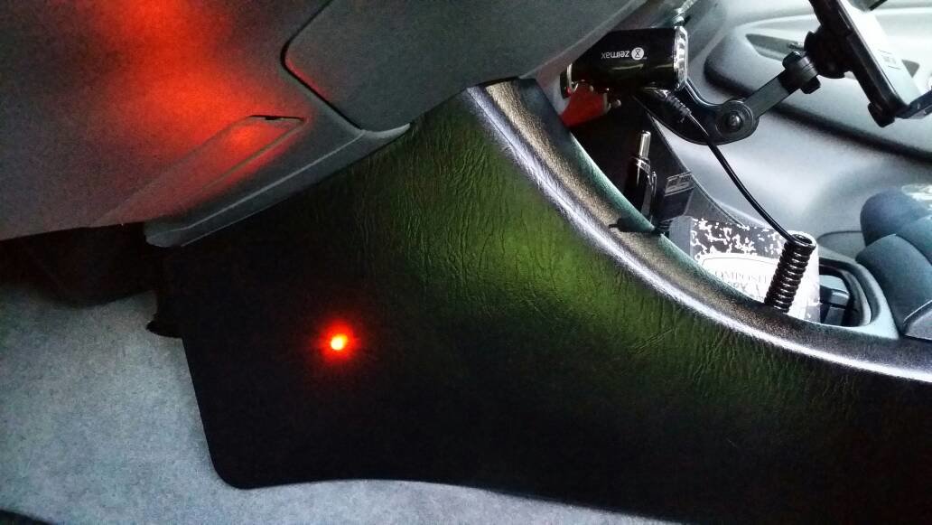

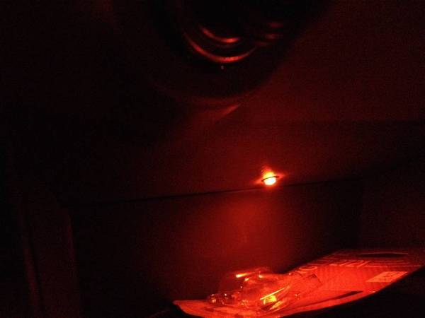

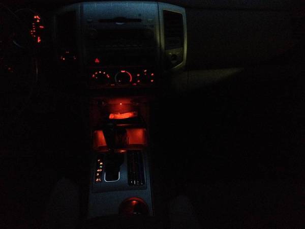

    I ended up using 5 of these -
    12v prewired w/ threaded bodies. https://www.radioshack.com/products/radioshack-12v-20ma-4mm-red-led-with-holder?variant=5717556933
    They are red, but they match the rest of the interior lighting very well.
    I placed one under each side of the dashboard, one under each arm rest to light the door pockets, and one under the HVAC panel to light the cupholder area.
    Mine are tied into the illumination circuit so the come on when the dashboard lights are on.
