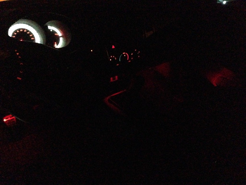

    This is my set up -
    0D317383-CD5A-4CD9-AE7B-2F6B9EBE3CAD_zps_39f46095b2686328f1e317b5a18928789398394e.jpg
    Excuse the awesome iPhone night shot. Notice the floor lighting isnt even as bright as the cluster/dash lights. Its ambient lighting and nothing more. Its not distracting. Its not bright. Its not obnoxious. The drive side seems really bright because its actually shining on the pedal covers, which are brushed aluminum.
    To wire them into the lighting circuit, tie them into the green and green/white wiring going into any of the switches. I forgot which is positive and negative at the moment though

    Thanks. The prewired Radioshack LEDs do not come in amber unfortunately, but like I said, the red matches really well. They arent a bright red.
    I did the lighted 4wd switch and used the same illumination source the switch uses. There is no fuse in the harness.

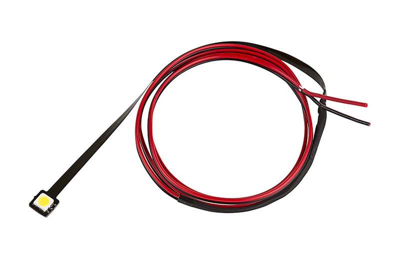

    Solid green is the hot wire. Black wire was connected to green w/white stripe wire, red to green wire. I used posi-taps. These are the lights I used:
