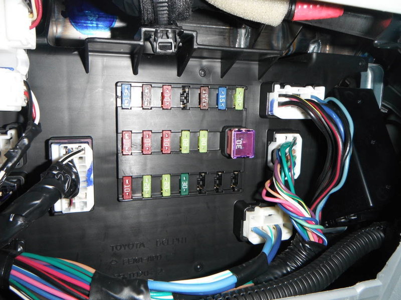

    I currently have wires coming in from the parking light circuit which power up another "project" so I just tapped into those.
    Some people have been tying into the dash illumination (not sure what wires at the moment)
    I did discover that the empty fuse location at the top center has 12 volts on it when the parking lights are on though. I might end up using it eventually.
