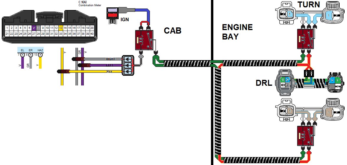

    How's everyone get just the amber running lights to work? Mine has led drl but not the amber lights that also work as the turn signal.

    There's a difference between the SR/SR5 headlights and TRD headlights. The TRD headlights have a white LED strip for the DRL while the SR/SR5 just have the amber turn signal as the DRL.

    Added cab relay IGN juices the relay(s) at turn signal added harness to illuminate with DRL & TAIL.
    DRL & TAIL have diodes to keep circuits from feeding each other.
    Upon TURN select or HAZ (engine on) juice is cut to engine bay relay(s), returning TURNS to OEM function.
    :typing: @daveeasa @Puppypunter

    Only SR/SR5 get amber DRLs.
