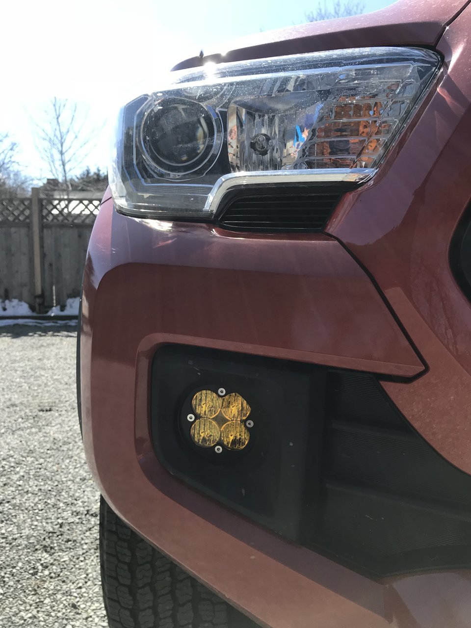

  14. Mar 15, 2018 at 6:54 PM
    nouel87
    nouel87 Well-Known Member
    Jan 22, 2018
    #242022
    64
    Jerimiah J.
    The Grey Lady
    2017 Tacoma TRD OR DCSB Inferno
    I just installed these today, and they are very bright. So bright, I fact, that they bleed above the stock headlight low beams and saturate everything in yellow light. There doesn’t seem to be any columnation or vertical cut-off. While I do like them, and love the way they look, as was mentioned above by Baja Designs, it is definitely clear that these are not street legal. I’m actually afraid to use them at night or in foggy conditions because of how bright they are, in consideration of other drivers. Has anyone any experience with night driving? These lights may only have an off road application. EE0E6C56-8E3E-42DB-A368-34B045A7251A.jpg
    Brie likes this.
  15. Mar 15, 2018 at 7:52 PM
    se7enine
    se7enine MCMLXXIX
    Apr 18, 2013
    #102322
    23,442
    Reno, NV
    They are not DOT and are therefore illegal for on road use. Off-Road use only.

  19. Mar 15, 2018 at 11:24 PM
    #19
    crashnburn80
    crashnburn80 Vehicle Design Engineer
    Jun 6, 2015
    #156893
    14,771
    Kirkland, WA
    2003 DCSB TRD OR

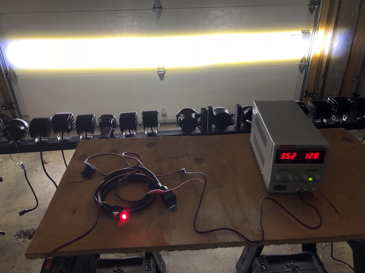

    I plan on an update to that halogen thread this month, which will push output higher at a lower wattage not necessitating a harness.
    Baja Designs squadrons, while producing some of the best quality lights with great low color temps, are not safe for street use. The wide cornering beam emits massive glare above the would be horizon (they have none) and should be considered for off road use only. This does not have anything to do with brightness, it has to do with beam pattern.
    Cali Raised Pods produce a spot beam, which emits glare in all directions and is not safe for street use. This is also a very limited beam pattern for the fog location, which typically should use a wide spread beam.
    Yellow filters on LED lights really hurt output. A yellow filter (lens) works by only letting long wavelength yellow light through. Halogens produce plenty of long wavelength yellow light, which many do not like, so while filtering out white light with a yellow filter reduces output, it is not to the level of putting a yellow filter on an LED which has very little yellow light to begin with. LEDs primarily produce light in the white/blue spectrum, yellows filters filter out white/blue spectrum leaving significantly reduced output from the original LED source.
    I’ve got 22 pods on a fog rack lined up which I am doing extensive testing on.
