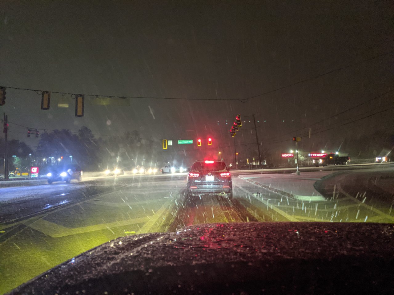

    Best example I could find from my camera roll, that's them on the Amber setting with my Morimoto headlight bulbs. I did a complete LED upgrade to all of my lights.
