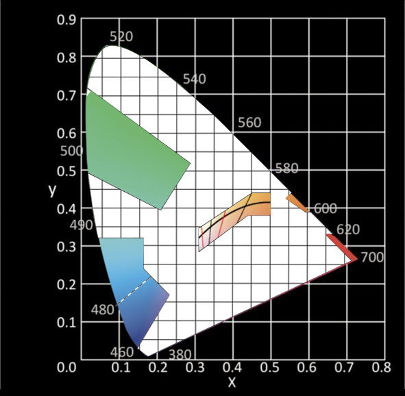

    The legal color is selective yellow for fogs (not amber, that is Baja who calls yellow lights amber and confuses everyone). Selective yellow isn't a kelvin color temp, it is a defined chromaticity window (or box) that the XY coordinates of the color output in CCT plot must fall in, to be a legal color of yellow. Below are my measurements for the Max selective yellow fog, plotted on a CCT plot with the X and Y coordinates, and then below plotting those coordinates in the legal chromaticity window. You can see the color coordinates fall within the legal chromaticity window (inside the box) and is therefore is a legal color of yellow for a fog lamp.
    Selective Yellow Max CCT Plot
    SS3 Max Selective Yellow Chromaticity window plot. With the 6000k emitters it still falls in the legal selective yellow chromaticity window.
    You can also point out to an officer the SAE compliance designation stamped on the front of a fog lamp, stating they are certified by the manufacture as a street legal lamp.

    So the Amber Stage series light bars ARE selective yellow? I was under the impression that they are not (I believe from Diode Dynamics themselves, but it has been so long I can't say for sure). And the KC G4's are selective yellow as well? I get the SS3 MAX still falls in there, but it is also listed as a 3000K YELLOW light. By definition, a 2000K and 3000K would have different dominant wave lengths, no? I ask from an honest point of curiousity, as the G4s are referred to as Amber (rightfully so in my opinion..)
    I would read that as Amber, not selective yellow? I would also read that as the KC's amber color being attributed to the color temp. Like I said, I am trying to ask an honest question, so don't take it wrong :)

    Also, it's been a while since I dealt with this in Physics, but isn't CCT measured in Kelvin? So selective yellow needing to fall in a certain range of CCT would be another way of saying it needs to fall in a certain range of Kelvin, no? I mean, even the graph the posted clearly has CCT = 3106K. You can't have an equal sign if they are different things. Apples ≠ Oranges and all that...

    Sorry I did not read the whole thread. Yes Diode Dynamics Stage Series bars are amber, as are the KC G4 ambers and Morimoto XB ambers. For fog use though, I believe this is more of a classification loophole with acceptable forward lighting colors (white/yellow/amber) as only white and yellow are designated for fog.
    No, note the color temperature lines on the plot, 4000k for example. There are a lot of different ways your can get a 4000k color temp as shown by the 4000k line plot and where it passes in the X and Y coordinates on the graph. You can see the upper end of the line will have a more yellow hue and the lower end a pinker hue, but they are all 4000k. So there is a defined set of coordinates light sources must fall in to meet a criteria like selective yellow. It cannot be defined by a color temperature.

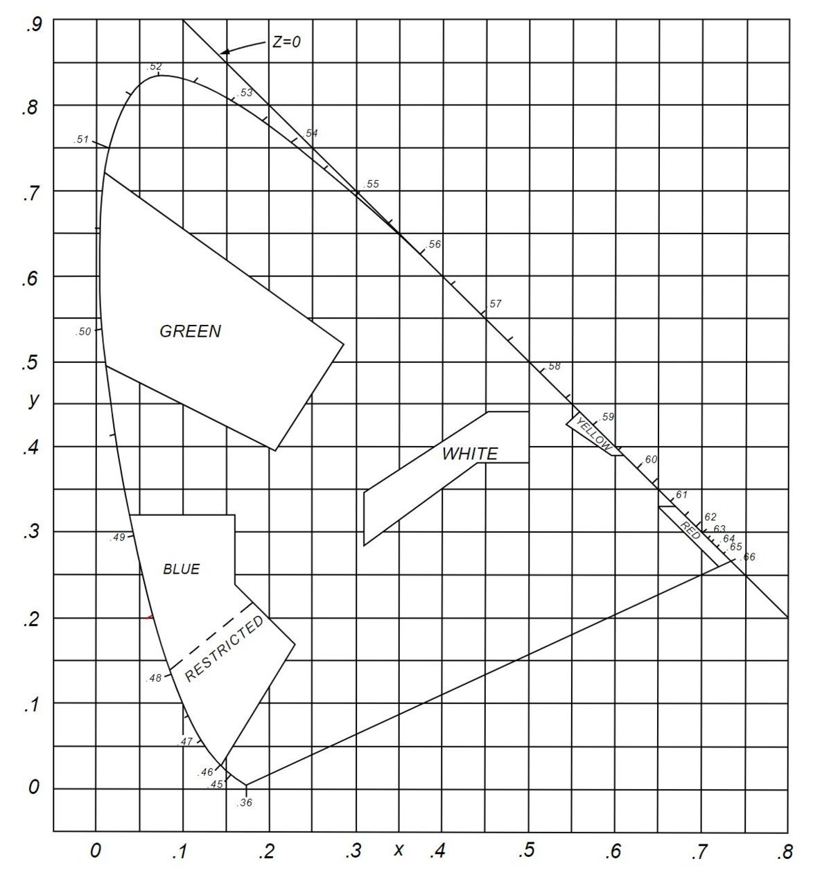

    Gotcha :) Thanks. I always understood Kelvin ratings to one very precise thing: Heating a piece of iron (? I think it was iron). So 4000K would always be the same color, regardless of how it is produced. Didn't realize there was that much variation. But once again, you taught me something :) And I hope the short of it is that Stage series light bars with the correct optic (and of a certain size) ARE street legal?
    I would think for the definition under the law as far as Amber vs Yellow vs White, the filtered light source is ALL that matters. I can't have white brake lights, but I can stick a white light behind a red lens and be fine. Thanks for the link though, I will have to do some reading (it's a slow work day if you can't tell :rofl:) I did look at it, and the only thing I saw (granted, I was just speeding through it to see how the law defines colors, because I have always wondered that) was this:
    Which looked awfully familiar. So I did this (it was a super quick job, so don't hold me to too high of a standard. Actually, never holding me to any standard is probably playing it safe)
    Which I quickly realized their proportions were off, so I spent more than 10 seconds and did this:
    Which helps me understand the definition of white, blue, red, green, and yellow. Still, no amber though :annoyed:
