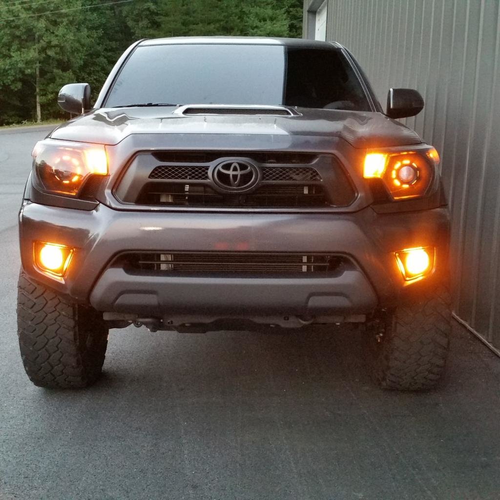

    How does this film holds up?

    I cant get enough Amber :D

    Pretty good..Have to understand your applying a film to a light that does get hot! A good install and a lil' knowledge about the film and you'll be happy with it. Cant really go wrong with fogs besides the burning issue. Just be smart about leaving the fogs running while sitting still. I always just cut mine off if I am in traffic or letting my truck idle for whatever reason

    Always get the light clean as possible before install..Even surrounding area's. bezel, trim work etc..all that stuff can come in contact with the film during install. After the install is done you gotta keep an eye on the film. Any spots that begin to "lift" you need to push back down immediately
