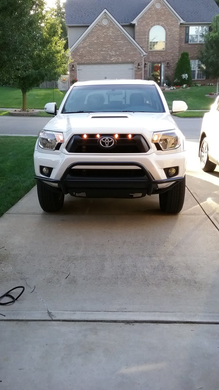

    F7C8E5BB-6802-4EC6-BD85-775FC489A822.jpg Tap the drivers side parking light purple wire is positive and white wire is negative and be done with it. Theses wires are already fused from the factory and the raptor lights don’t draw enough to make an issue.

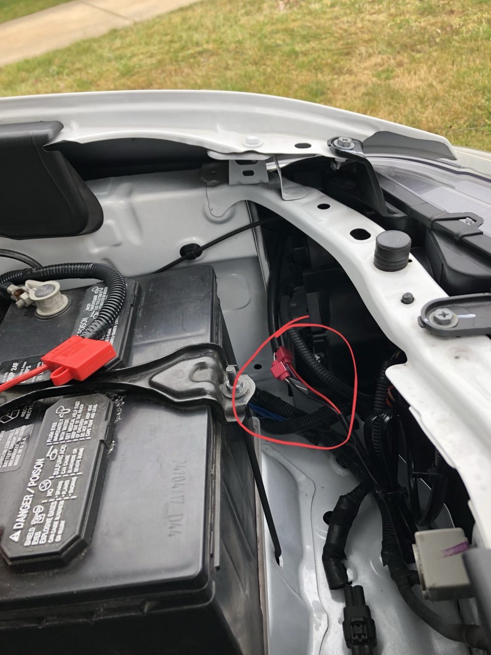

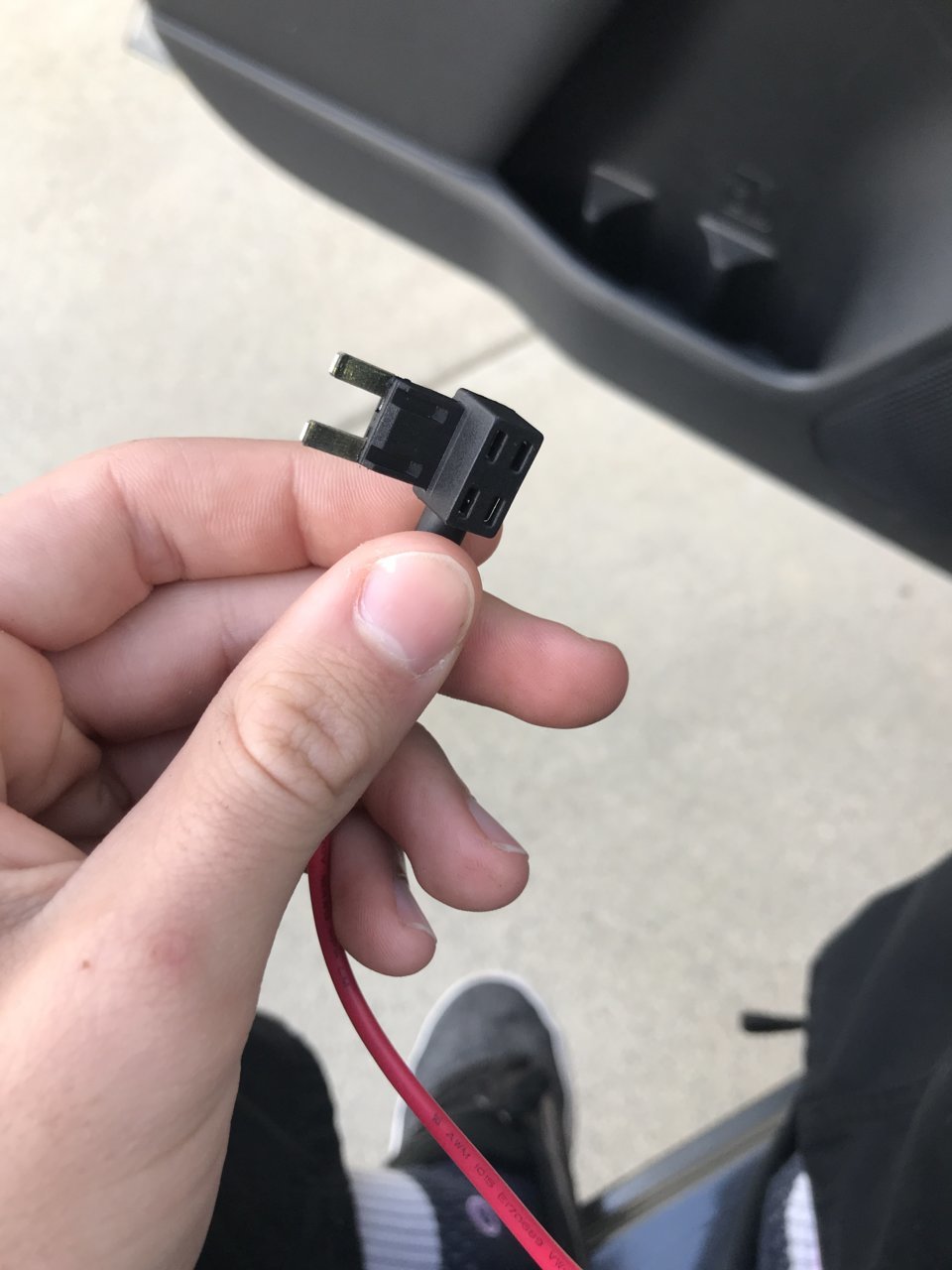

    SoCali_Guy likes this.
  13. Jan 31, 2019 at 8:57 AM
    SoCali_Guy
    SoCali_Guy Well-Known Member
    May 20, 2018
    #254074
    732
    California
    TRD OFF ROAD
    Is that the piggyback version?
