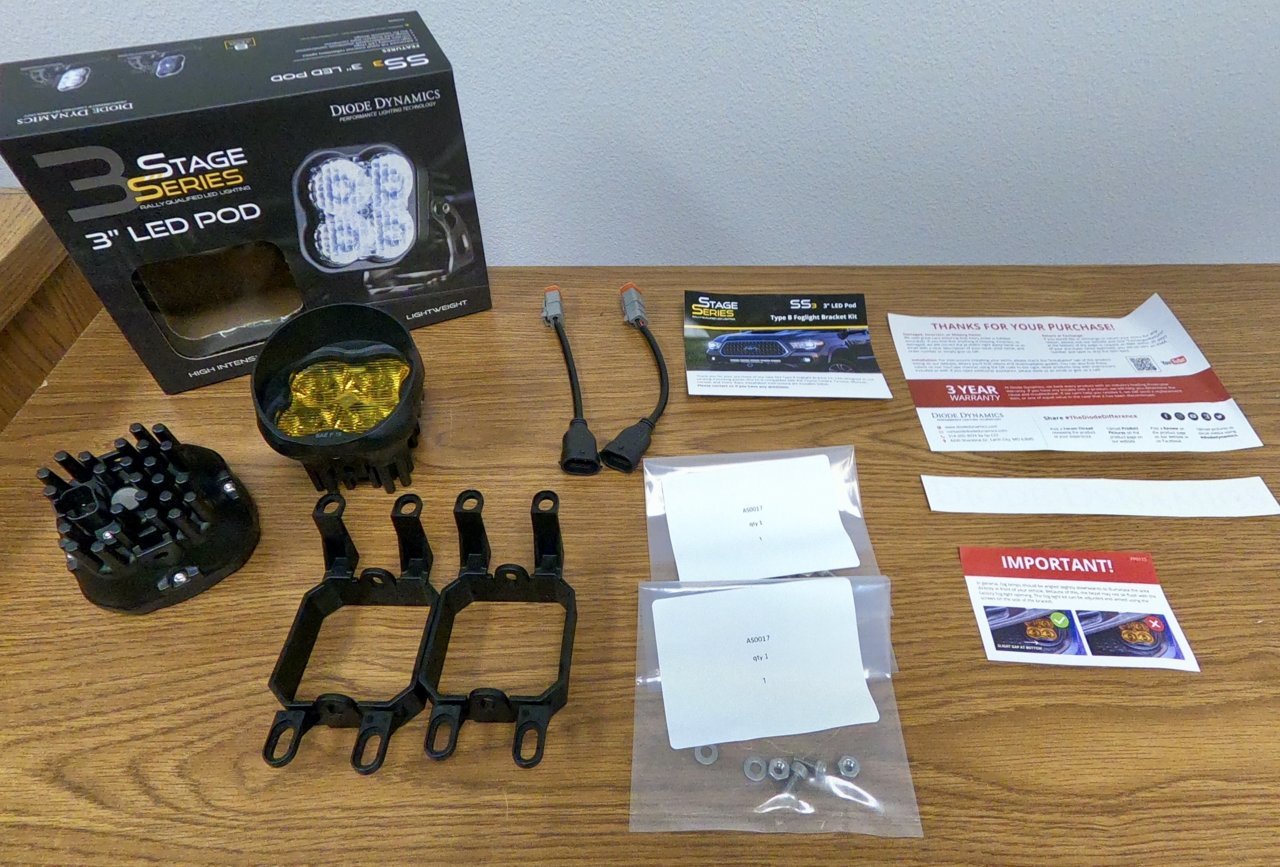

    That being said, I've just received the Diode Dynamics SS3 Amber LED DOT/SAE Fog Pods! Very exciting!
    I'm working on an unboxing, install and general comparison video between these, the Hella 2700K bulbs and the stock setup.

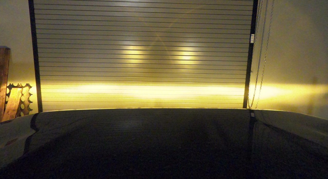

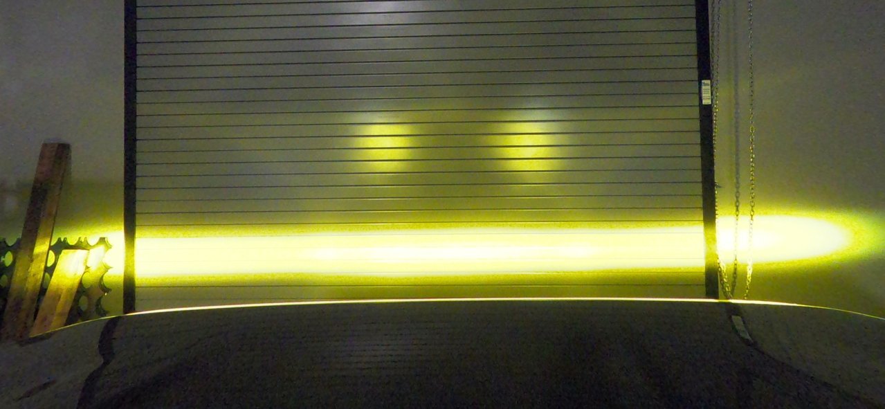

    Update
    I installed the DD SS3 Fog kit last night and got a chance to do some basic visual testing.
    My initial visual impression is that this product offers a brighter more yellow light projected in more efficient manor compared to H11 bulbs in the stock fog housing.
    Stock Fog Housing with Hella Xtreme Yellow 2700K H11 Bulbs
    Diode Dynamics SS3 DOT/SAE Yellow Sport Fogs
    These pictures were taken quite close to the bay door. The improvement over the stock H11s is more noticeable in person and while driving.
    Anecdotally, I can say the stock setup is about a 5/10 and the DD setup is a 7.5/10 (just an initial opinion)
