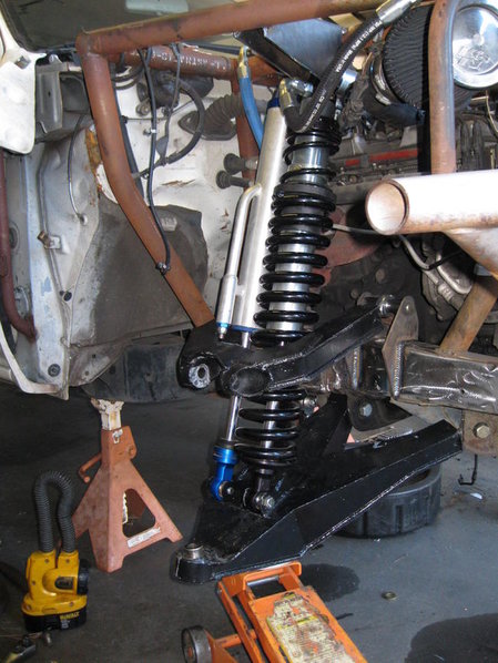

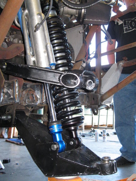

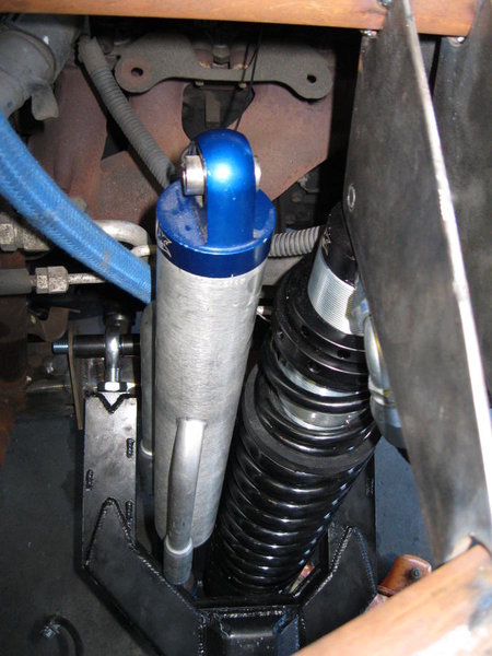

    So Alex (battlescars) came by the shop yesterday to make sure a coilover and bypass will fit in between the upper arms. perfect fit

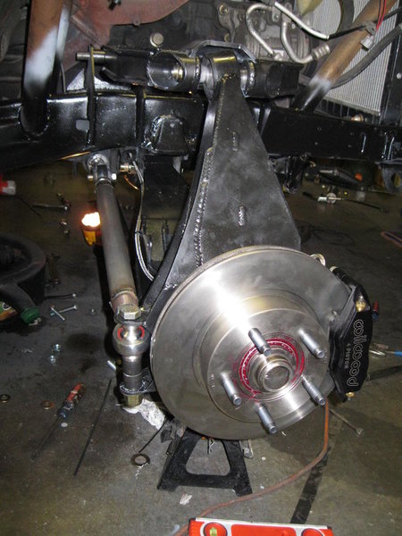

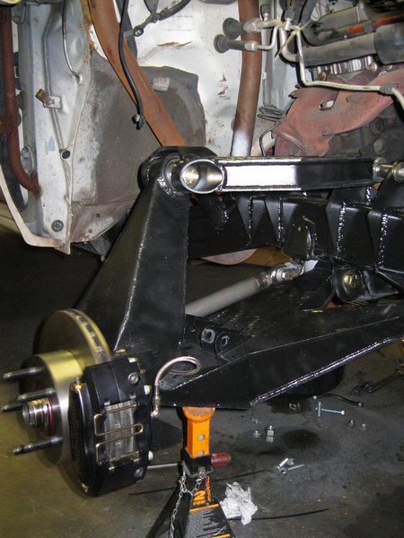

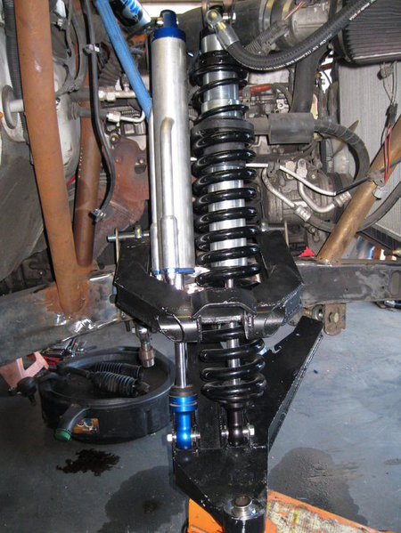

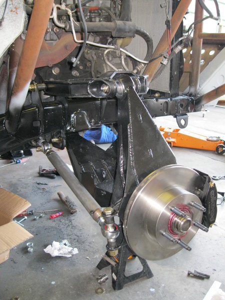

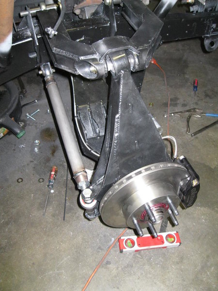

    Almost got it on its wheels today, but not quite there yet. Just finishing up some minor details and taking pictures for a detailed instruction packet to include with the kit, but Im Super happy with how things went together. Very easy and smoth. Here are some pics of todays progress.

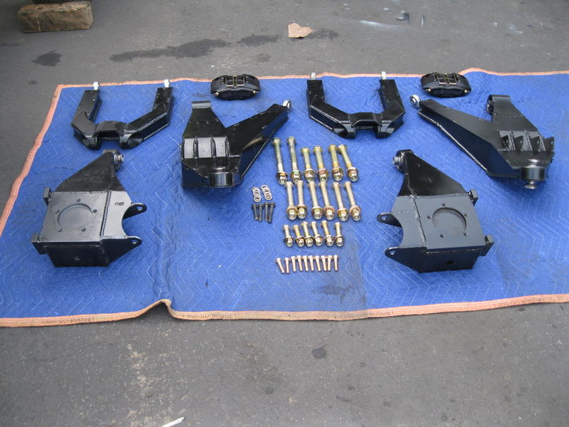

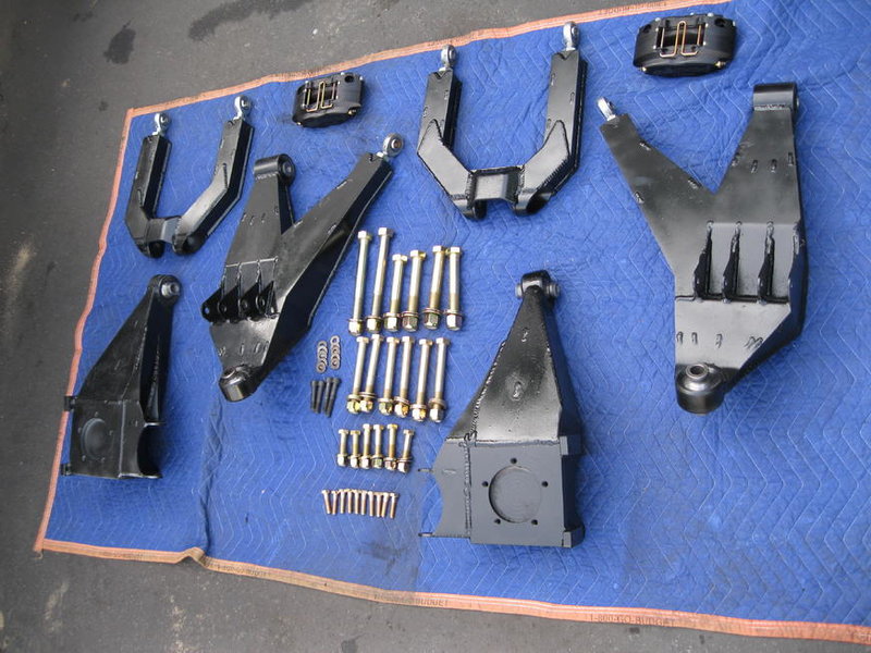

    Ive finally got my kit 100% complete and im super stoked on how it turned out, here are the kit details.
    96-04 Toyota Tacoma 5-lug long travel kit
    6in over suspension kit
    18in of wheel travel
    removal for 2 weak points on the 5 lug, upper arm cross shaft and spindle
    utilizing ranger hub to keep the 5x4.5 lug pattern, with the ability to change snouts to 5x5.5 lug pattern if you change the rearend.
    replaces stock caliper with 4 piston caliper for improved preformance
    coilover and bypass side by side
    2-upper control arms
    8-upper control arm mounting tabs
    2-spindles
    2-lower control arms
    2-tierods with 7/8 heims
    2-steering clevis
    all grade 8 hardware
    stainless steel brake lines
    2-wilwood calipers with brake pads
    Kit price with all parts listed and included $4000
    limited time offer ***free installation***

    Looks awesome:thumbsup:
    Price seems quite fair for a kit with 18" travel, full steering kit, brakes (calipers, etc). Can't wait to see what you come up with next :cool:

    That kit looks good!

    :thumbsup::thumbsup::thumbsup:

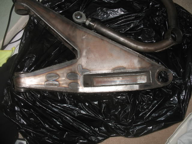

    Good stuff Brian , looks beefy as hell, I just talked to ya on the phone a min. ago..
    Wished your kit was out a month or so ago before we started Ryan's 5 lug
    Doug

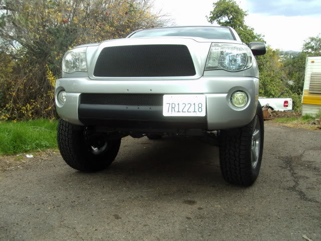

    heres a pic of Ryans 5 lug, went from 4.5" under stock to about 4" over......

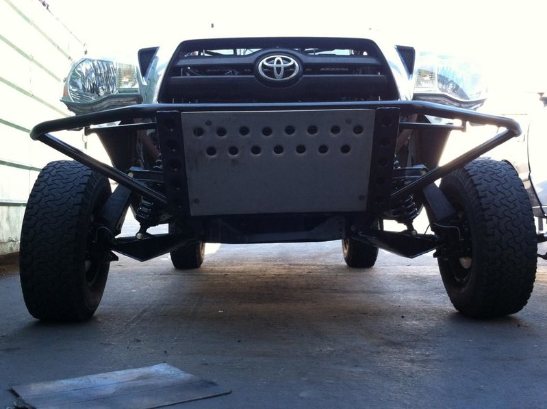

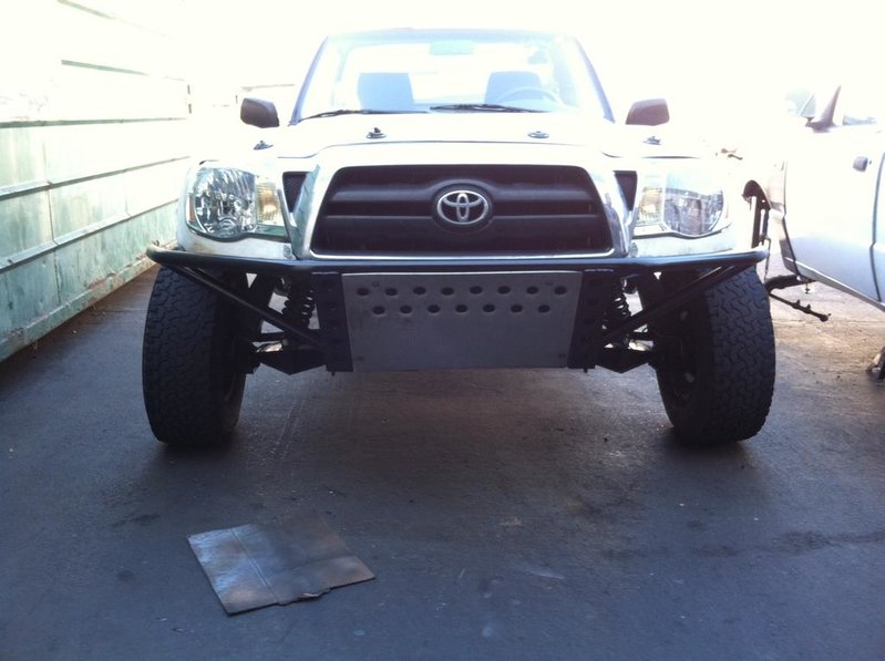

    drove it last night and it rides like a caddy.... Super smooth and responsive, ill post up pics after dinner. I need to download them from my camera.

    more to come

    Holy cow that is wide. Adjust that camber! That look more than 6" over each side

    Its not that much wider than your jd kit, espically with your fab tech spindles that also increase your track width.

    im getting it aligned tomorrow and ill have some better day light photos for you. Ill also be heading to laughlin this weekend for its first shake down run. So ill report back to you how it handled and more pics.
