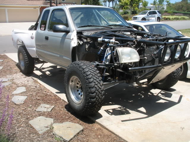

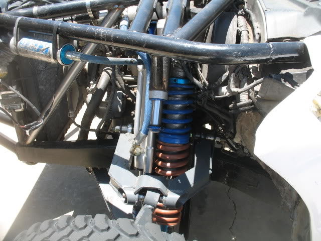

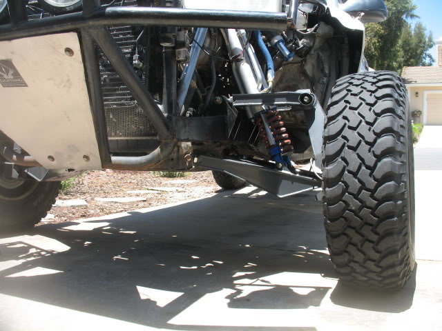

    Here's some updated pictures of the kit I installed. I went with the 12" 2.5 triple bypass, a 10" 2.5 dual rate coilover to be able to fit it under the brake booster, and last but not least, a 2.0 bump stop which I shortened to 3".

    Looks good! I missed it but how wide is this kit?

    Alex that kit is straight sex man. That is some serious 5 lug porn.

    How's that steering working for you Alex?

    Steering works just fine now.

    Now thats how a 5 lug tacoma should look. Nice job alex
