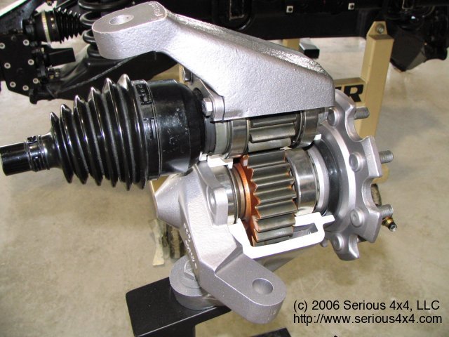

    its really not a lift spindle, 3/4" is the max you could get and you would get more plunge in you half shafts which is never good.
    the only way to really have a lift spindle with 4wd is to have a portal spindle like the hummer H1s have
