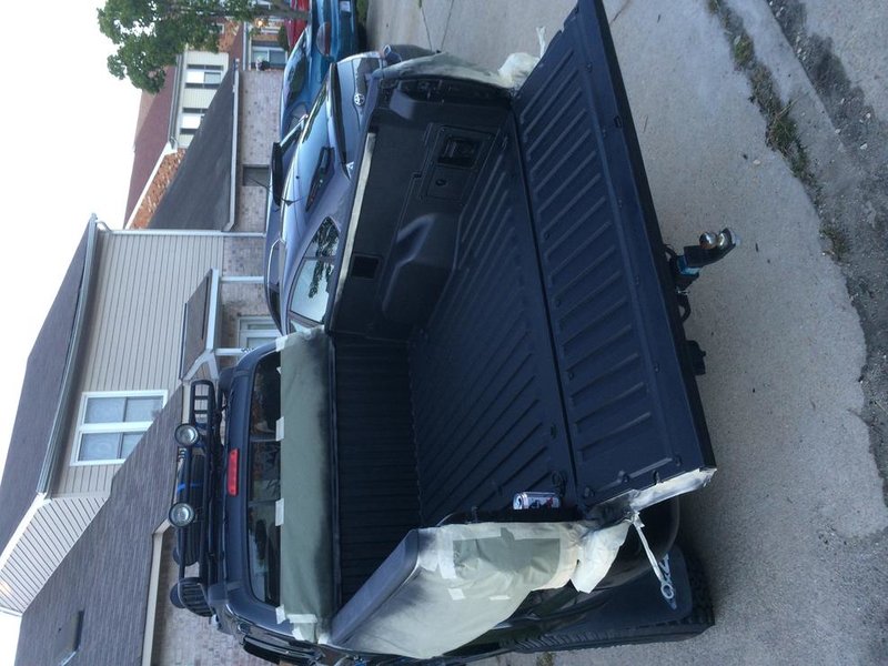

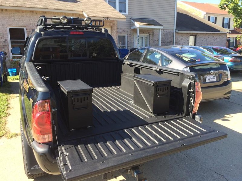

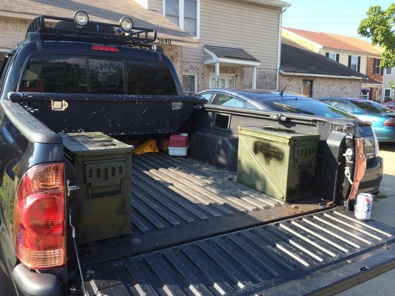

    not much to say I mounted these ammo cans for tool storage instead of my tool box. very happy with how it turned out!

    Pretty damn cool man. Are those cabinet drwer sliders? If so, how do you stop the boxes from rolling back against the tailgate under acceloration? What about if you forget to close the tailgate?
    Nice inginuity.

    Yea, Rustolium spray on bed liner. I bought the ammo cans at ammunitionstore.com. Great quality and price btw ($14.99). The cans are mounted on soft close under mount cabnet drawer slide. And no they don't move because the brackets are locking type. The cans they do not have a way to lock them although I'm sure a pad lock bracket could easily be installed. Oh and the Rustolium bed liner is AMAZING on plastic I did my bumper inserts a year ago and they still look great!

    $27 which I thought was expensive, but they do weigh 20lbs a piece! As soon as I got them it was fine by me though. The quality I can't say enough about, very little surface rust, and some paint and stickers, it took me and a buddy an hour to sand them down and paint them!
