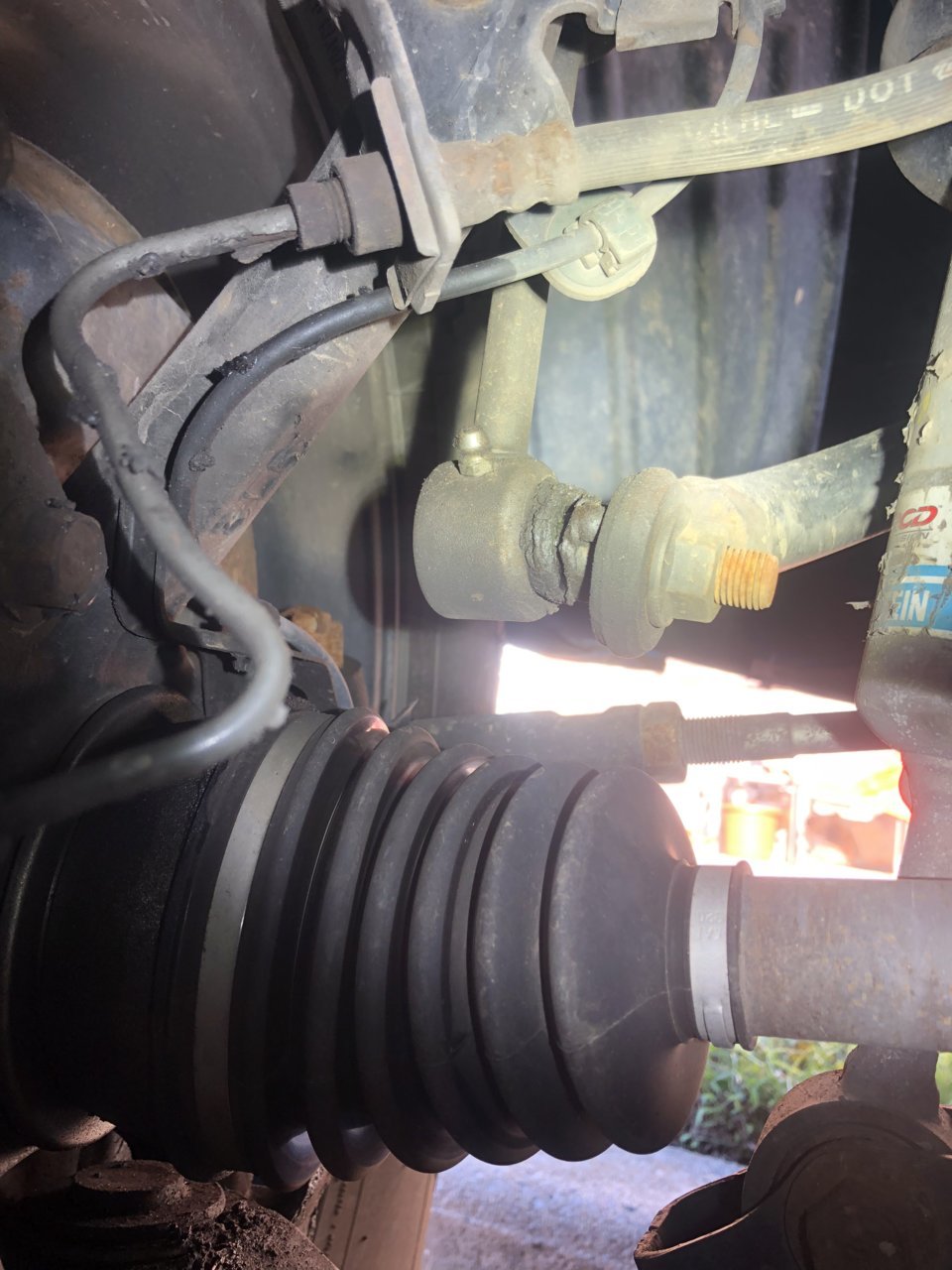

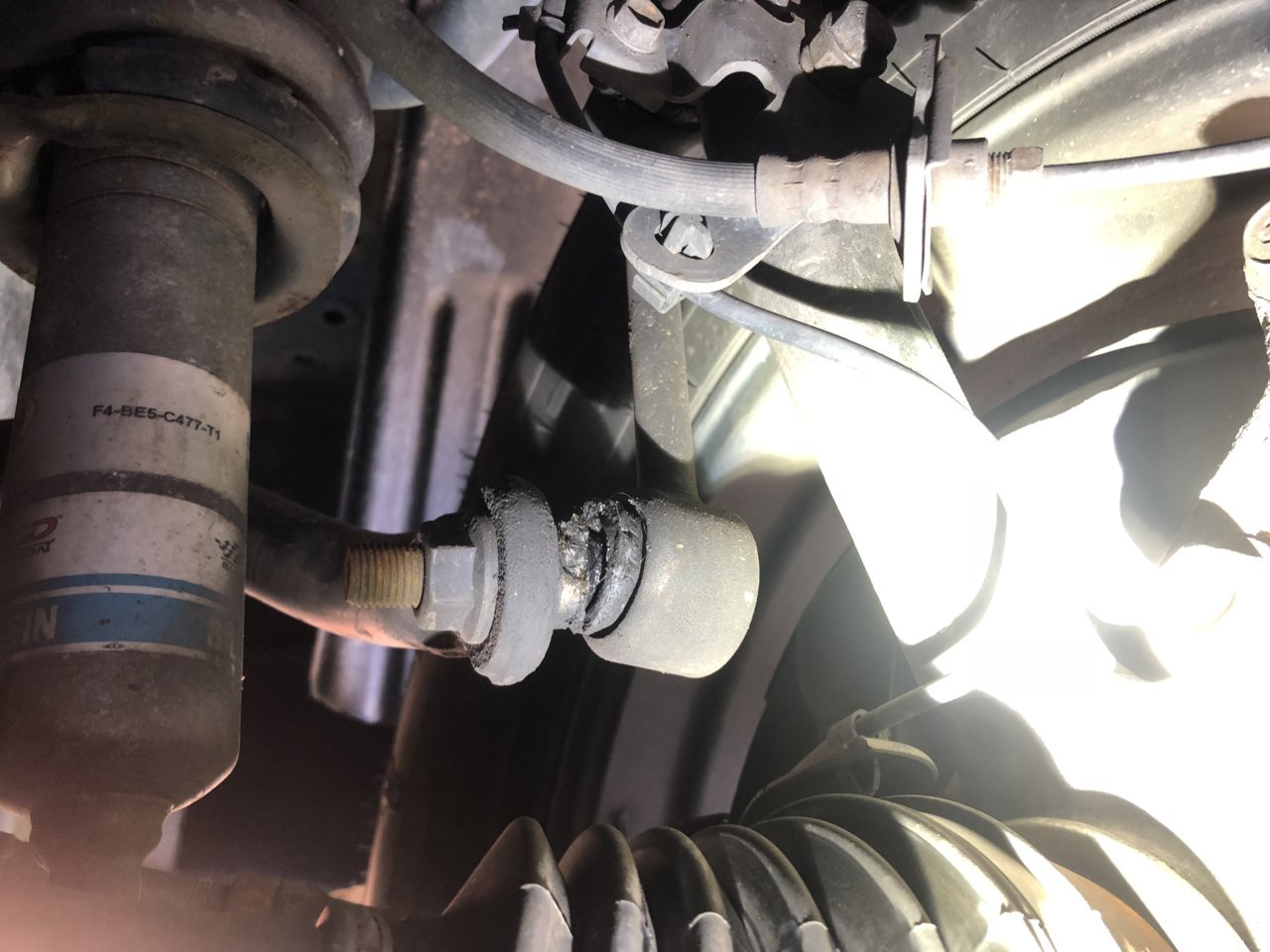

    Crawled under after hearing this faint metal on metal sound that got louder today. Found this while trying to figure out the grinding sound. Not convinced that’s where the noise is coming from. I think it’s the drive shaft possibly.

    I’ll check when it’s light out side again. But the big “clunk” came when the rear end hit the manhole.
    yep. *sigh*. Just getting frustrated, not enough time right now to deal with everything.

    So the sway bar end links, they were put on in June.. of this year. -_- Nasty gram being sent tomorrow morning.

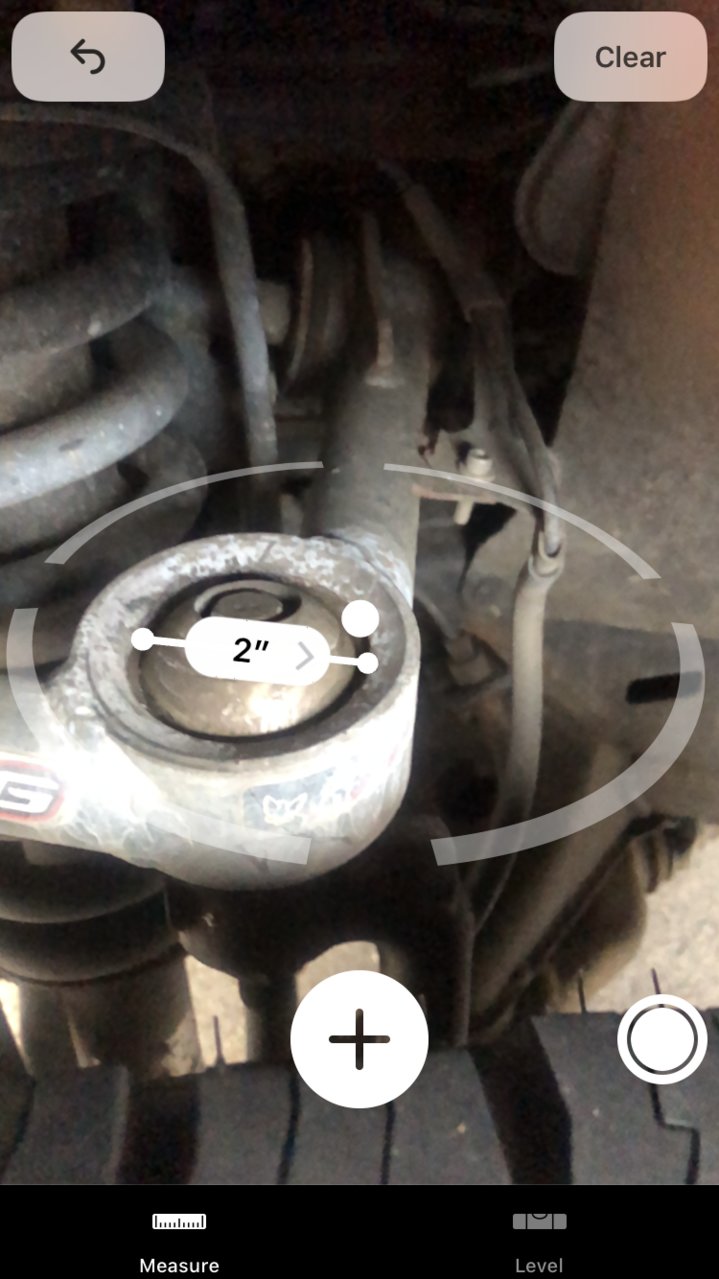

    When you say check the arms, their length or diameter?

    Uniball diameter.

    Sooo I’m not entirely sure I did this right.
    Arcticelf[QUOTED] likes this.

    I'm not sure. Pretty sure you want the larger one though.
