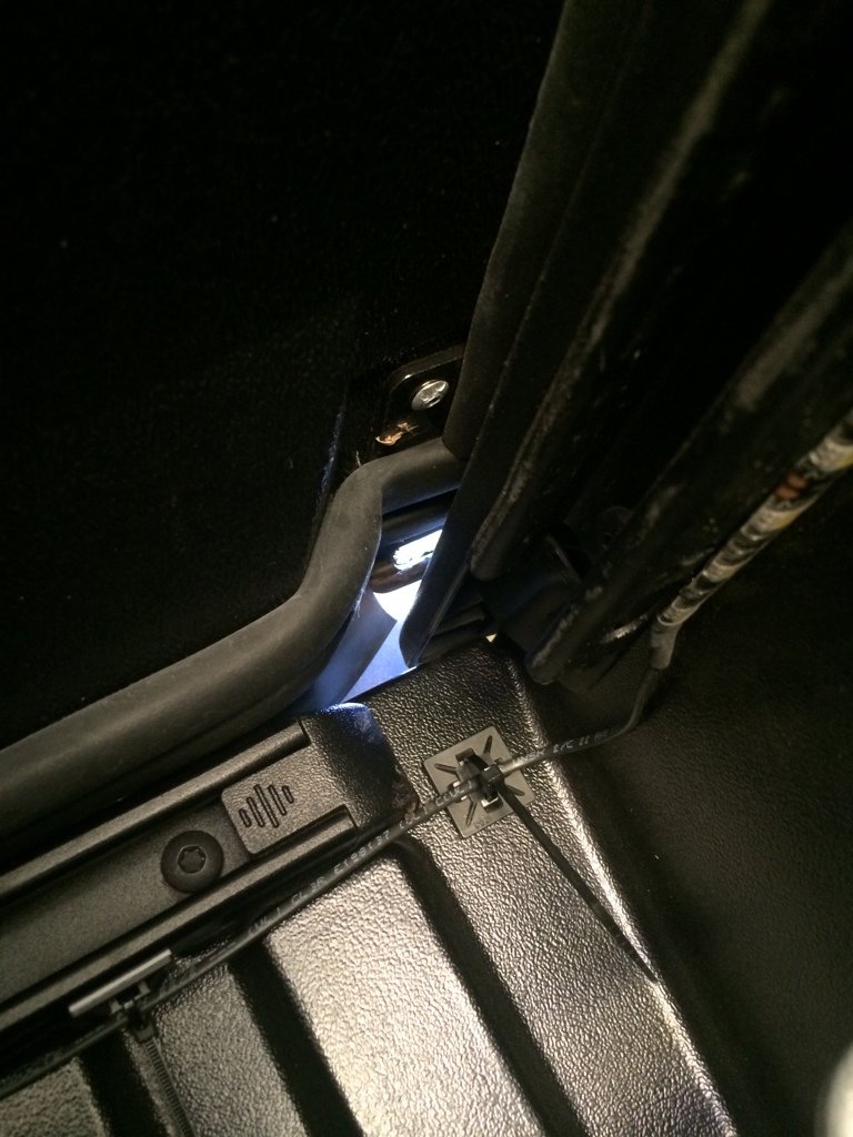

    So I bought a bed cover because I wanted to keep my equipment completely dry but my cover has gaps on the sides right at the front of the bed so a little water comes through. Was wondering if anyone else had a problem with this or have a solution? 6343dbf82f85ad4e2ecc4f73892b6507_d65f5ed7f77b7e4b373b12153f8b2c16415f1a64.jpg

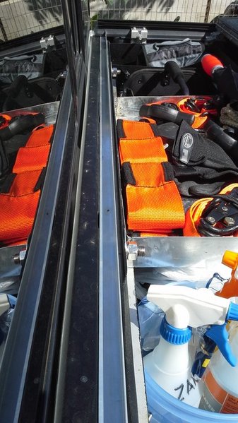

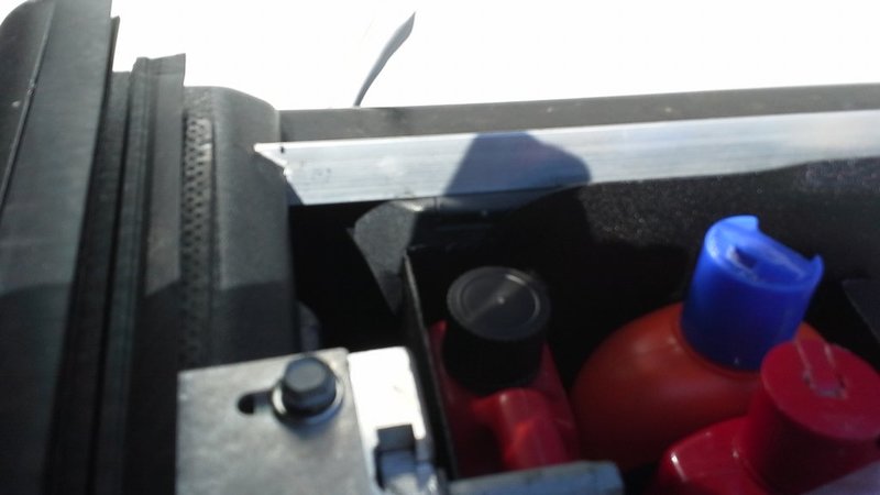

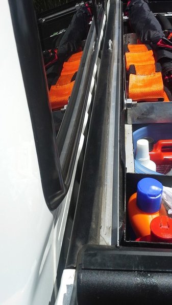

    Got g4elite and used 3/4 inch angle aluminum secured to bed with 3m outdoor double sided tape and sealed with bead of silicon .Don't know what kind of cover you got so don't know it will work for you. Trimmed aluminum to fit plastic rail then sealed with silicon
