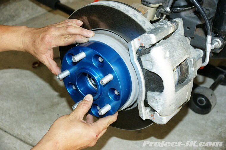

    Rims with less offset is preferable but many on here use spacers too to push the wheels out more.

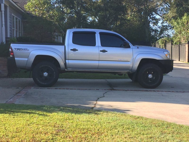

    So I want yalls opinions do you think I should go with wider tires? or stick with whats already on it?

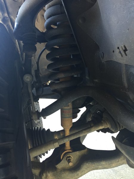

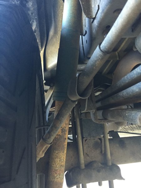

    also here are better pics of the front and rear shocks since the ones i took last night were horrible lol

    Truck looks good, you may want to go with a higher spring rate if / when you upgrade the front suspension due the the plate bumper

    Im not sure i understand what you mean by higher spring rate. I'm sorry I'm new to this and don't understand a lot!

    Higher spring rate means they'll hold more weight, this will add lift.
    One thing to keep in mind on your tires... The wider you go, the more you'll rub. This will require cutting more of your truck off. Tall tire are better for offroading, but width doesn't really give an advantage - just looks. Tall and skinny is functional, but not everyone likes that style.
