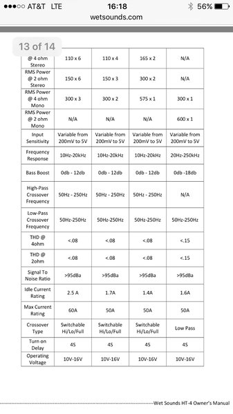

    image.jpg I've got a WetSounds HT-4 amp that's just sitting unused, so I figured I might as well use it to add some bass in my truck. I'm trying to figure out how to wire a subwoofer to take advantage of the full 600rms watts of the sub. I've attached the chart from the manual and it shows 600w x 1 channel at 2ohms. How would I go about wiring a sub for that?

    That 600x1 is in another amp's column. The HT-4 is a 4-channel (2nd column). But it can do 600x1 if you have a sub with two 4 ohm coils. Just bridge down to a 2-channel then give each coil a channel. Just make sure they're getting a mono signal and match the gains!
    And if you do have the amp in the last column, simply use a 2 ohm coil configuration.

    :facepalm: I don't know how I didn't realize each column was for a different amp. Is it safe to give each voice coil a channel? If it is, then I'm thinking about getting a single shok triton 8" sub @manethon

    As long as you're matching input signals & gain voltages and the coil impedances are identical it shouldn't be an issue. I know folks who have done it without problems. Or use 2 more efficient 8s fed 300W each?
