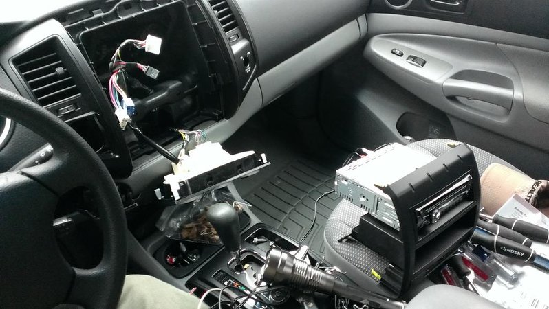

  4. Jan 5, 2014 at 8:11 AM
    4byota
    4byota [OP] Member
    Mar 1, 2013
    #98755
    20
    Upstate NY
    2010 Bone Stock V6 MGM Access AT 4x4
    I just installed my Sony first. It was a lot easier than I though it would be. Soldered in a harness and the snap connectors for the panels were real easy if you take your time with prying the right spots.... ("that's what she said")
