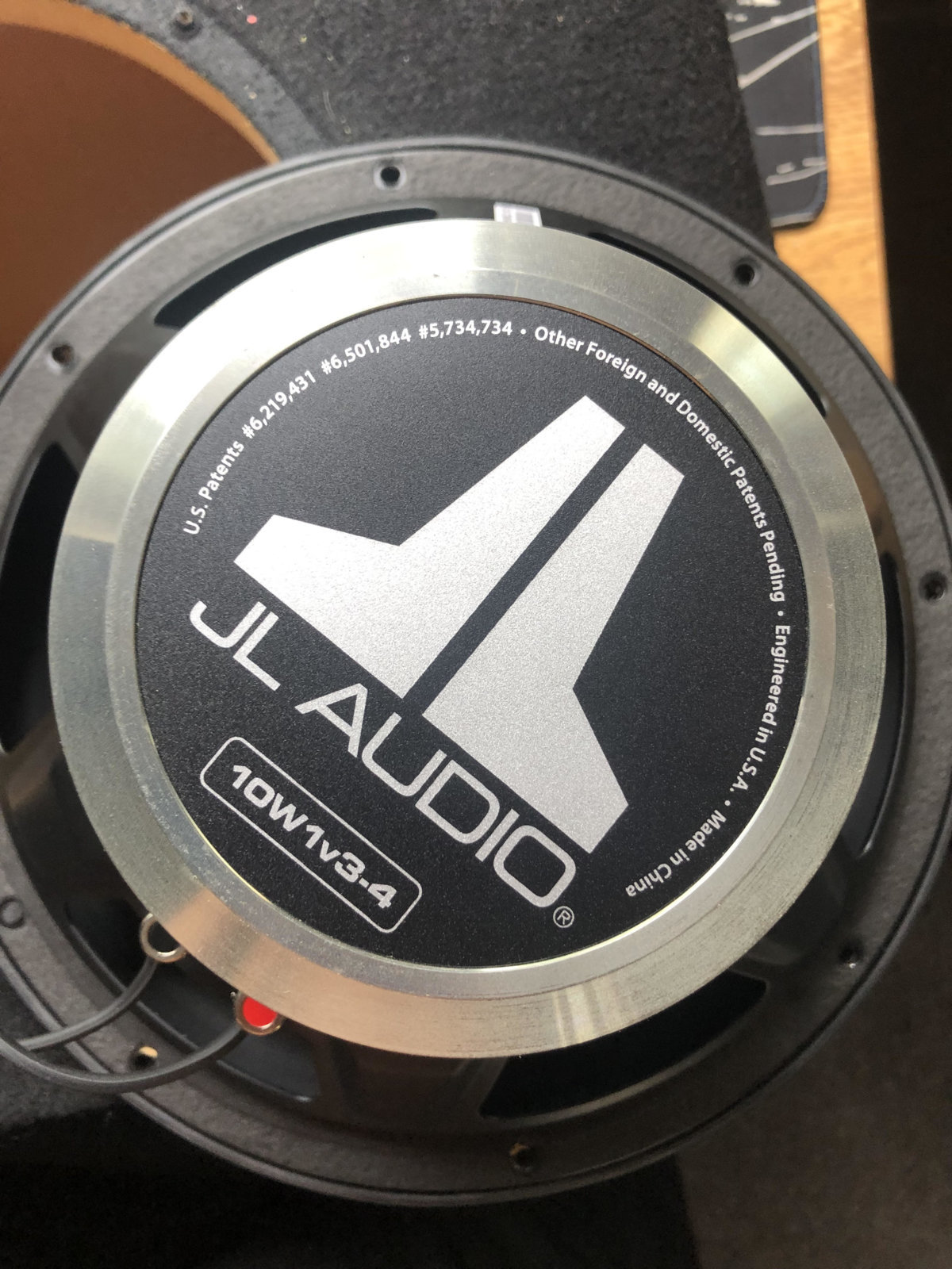

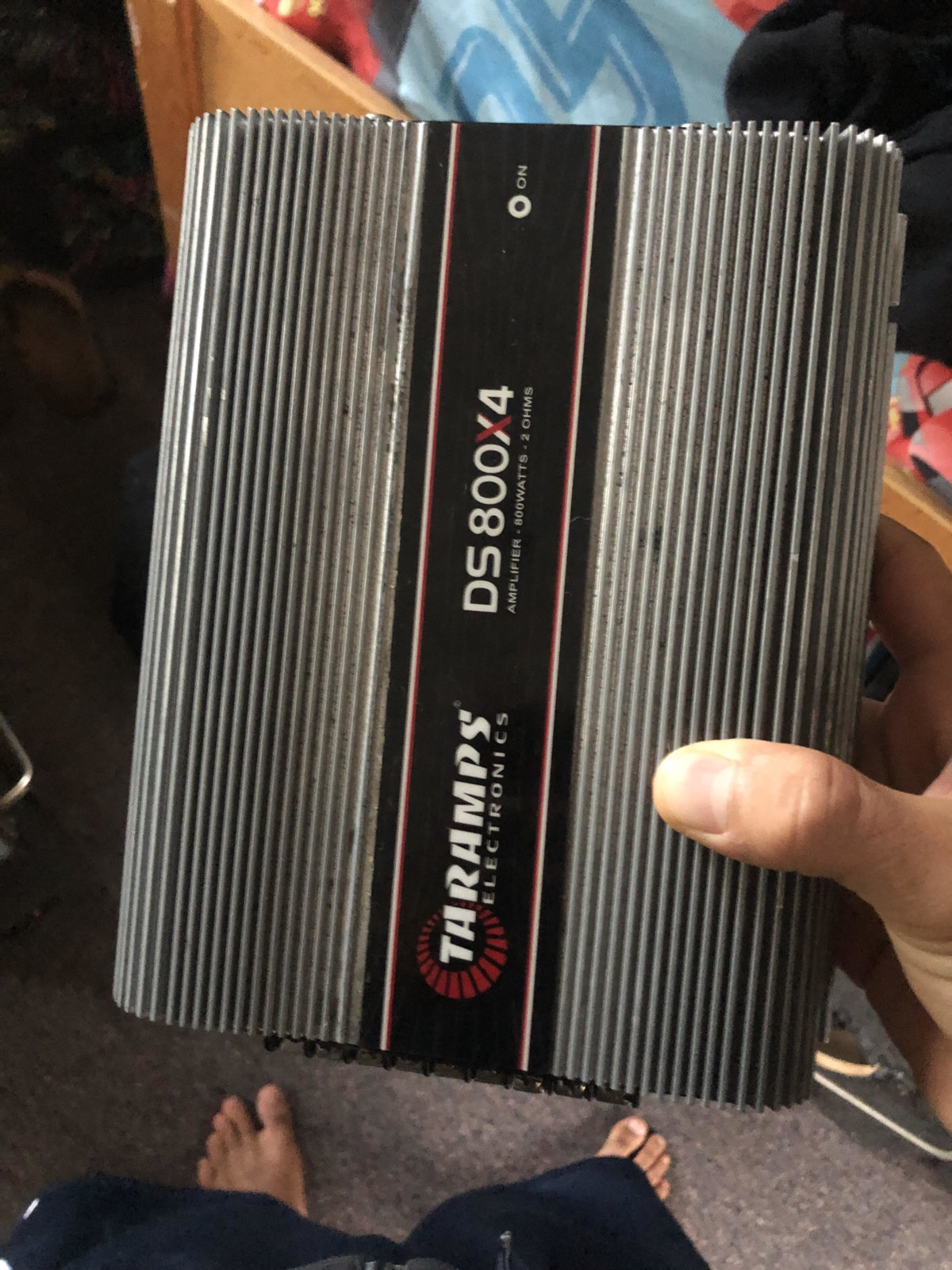

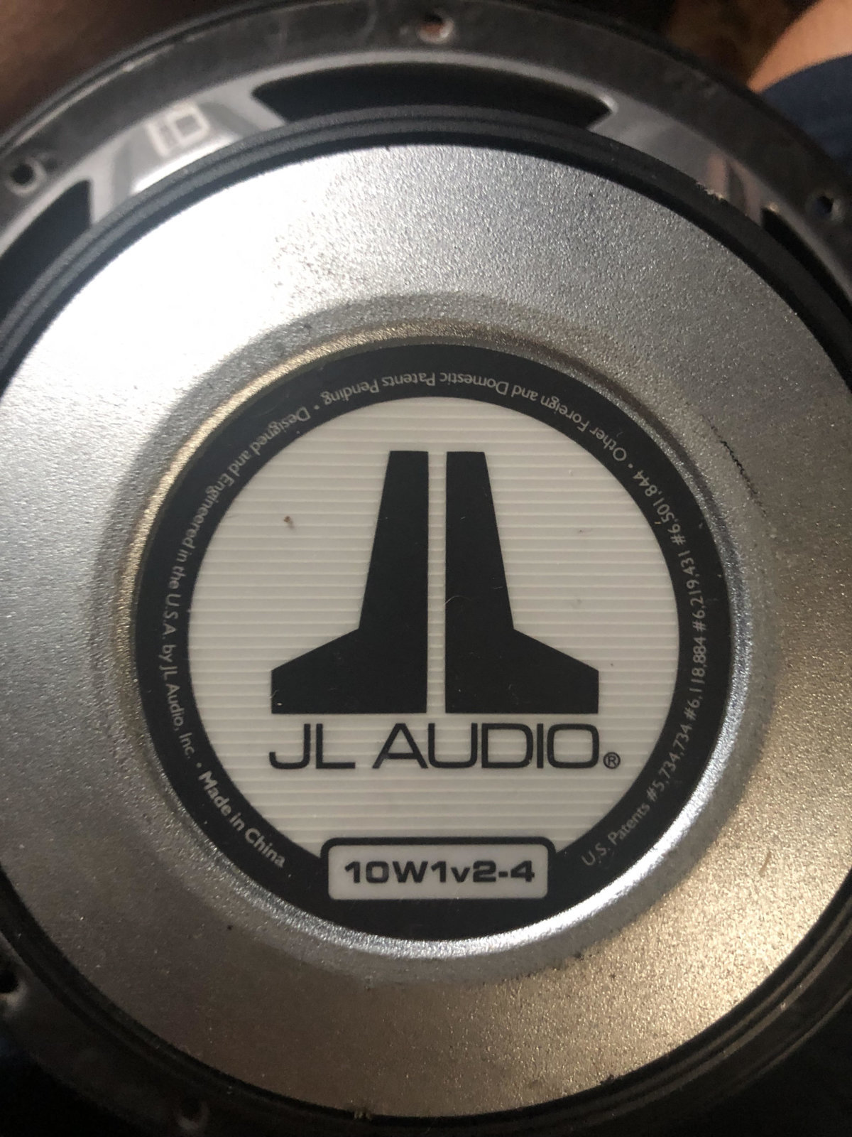

    Will this amp work for these two 10" subs (in two different boxes) or am I better off just running one sub in my 2004 extra cab taco.
    i attached images of the subs and the amp, let me know

    Compare T/S parameters and make an educated guess
    Not familiar with that amp or subwoofer set but you can get the answers yourself

    Look up the sub model numbers and check the ohm ratings for each. If they match then you are good to go. If they are different then stick with just one sub.

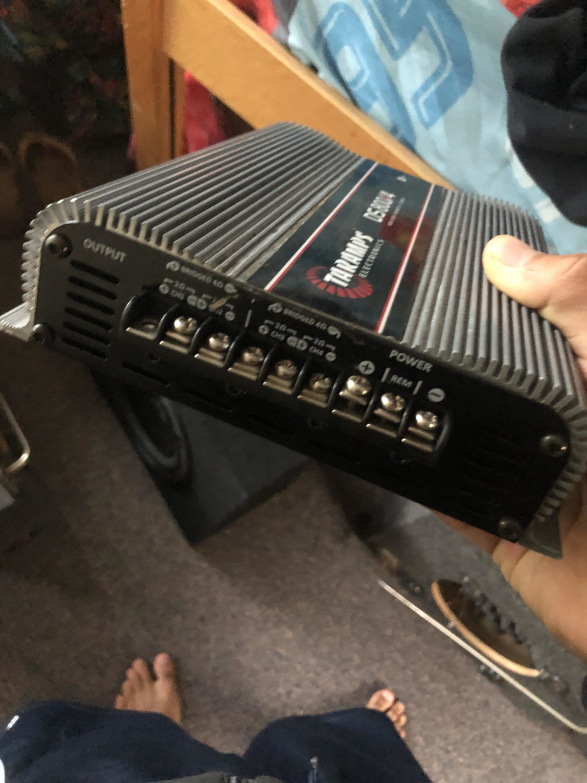

    It looks like your subs are the 4ohm single voice coils just version 2 and version 3.
    you should be able to bridge both 4 channel sides to make it a 2 channel amp and be all good.;
