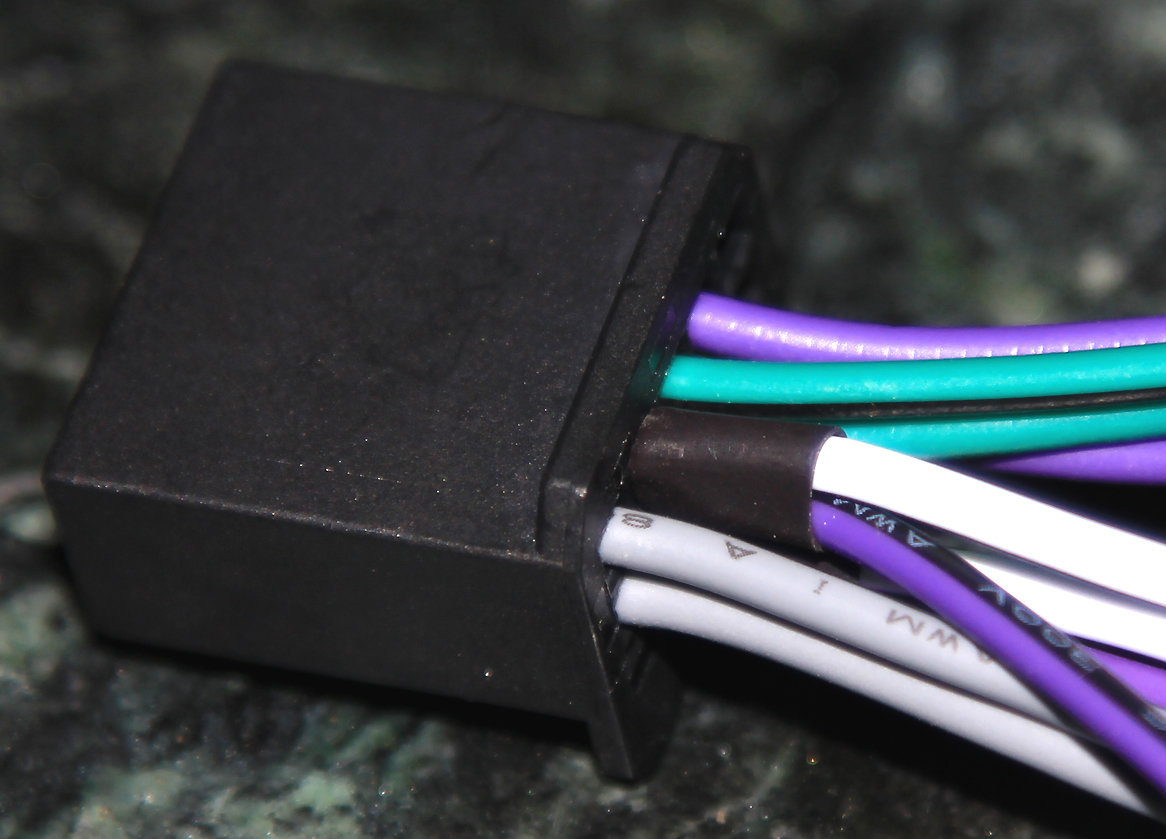

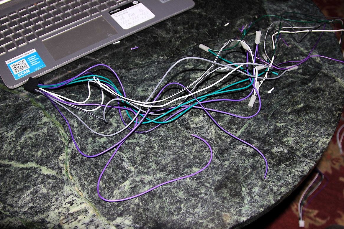

    I didn't want to have to cut any of the factory wiring at all. It appears those two purple wires connected with the white wires on TT's harness are for something else as I did not use them. I ended up just connecting all the colored wires together from TT harness to amp harness and left those two purple ones not connected to anything. Got it all together, installed, and everything works as it should. Sounds WAY better with the amp. Much better than just the factory head unit as my highs and mids were distorted easily. Amp has pretty much cleared that up and bass is much better as well.
    Here's a few pics of the TT harness showing how those 2 extra purple wires are attached for anyone else that might get that harness. Last pic is of the wires connected showing those 2 purple wires left not connected. If I had already known about the harness from Amazon, I would have probably bought it. But since I just got the one from TT, impatient me had already waited too long to wait any more to install it.

    @Hayward Glad it worked out. It appears from that look @DirtyGovnuh is correct. That appears to be an add-an-amp harness for adding an amp and sub. You’re set for future upgrades!:thumbsup:
