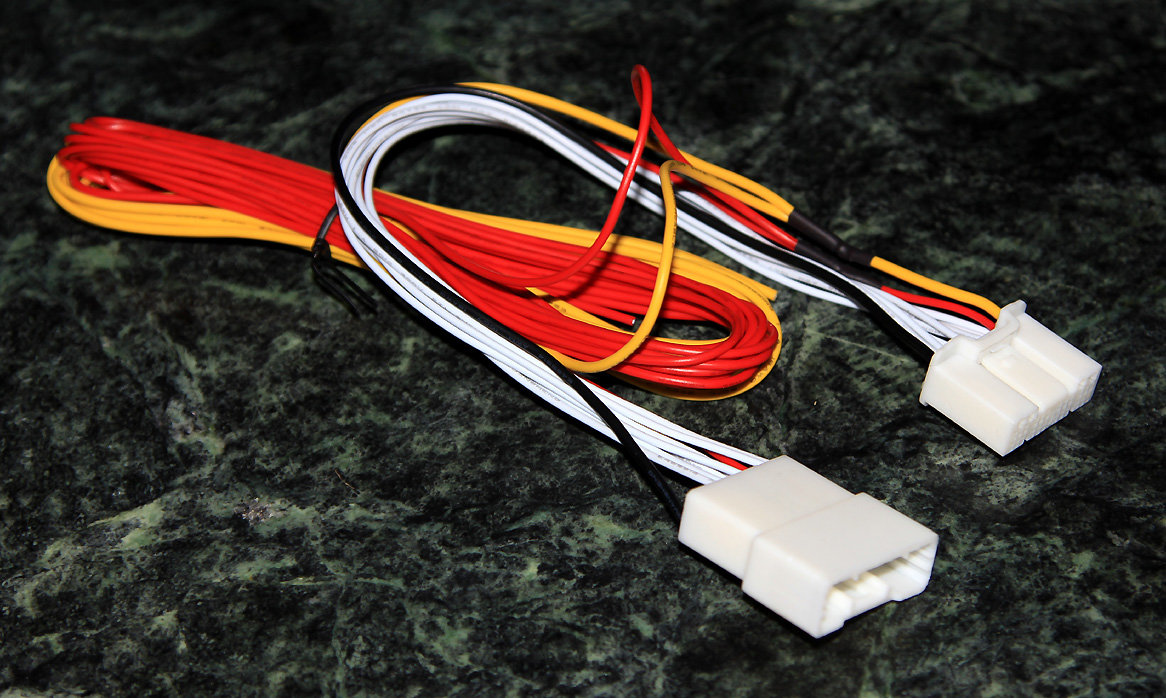

    That adapter ties into the +12V power on the back of the headunit. The red wire is the +12 ignition switched and the Yellow is +12V memory. I'm not sure if it would be the best idea to use this power wire for your subwoofer because you might blow the audio fuse unless your amp is pretty small.

    Thanks I want something I can put in the dash out of sight. I did order the harness that DirtyGovnuh listed so I will see how that works out. It was cheap if it doesn’t.

    This one easily fit right behind the head unit. And that harness should work fine as all you need to do is cut it in half, connect the colored wires correctly on the same colored wires that come with that amp and plug them in. If you have any questions, just let me know as I feel I've already learned how easy it is.

    Confused about the "from the amp back to the speaker plug behind the radio".
    Seems like all you would have to do is cut the harness in half, male end plugs into the back of the radio and splice the wires into amp harness on input side. Output side of amp harness gets spliced into the female side of the Red Wolf Harness. Female gets plugged into the factory harness. Power and Ground ran separately to battery and ground location of choosing, remote turn on not used.
    Did I say the same thing you did, just with way more words or am I missing something? TIA.

    Not the one you asked but I think you have it right. I don’t think of it as a “T” but a series harness. It seems you are just adding an amp in line. I have the red wolf harness I just need to buy the amp.
