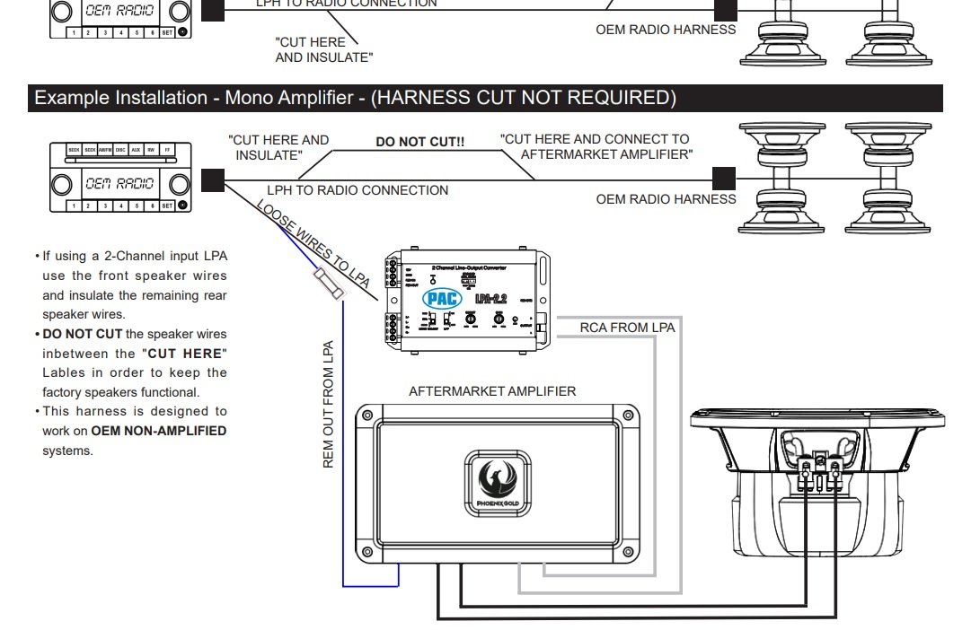

    Sorry didn't notice this right away. With the PAC one there is no cutting. They give you a harness that has the front and rear speaker channels split by a 4 pin connectors. They also spliced in power extensions that provide for a constant 12v, accessory 12v, and ground. Too make it really easy they give you various loose wires with a 4 pin connectors on one end. That manual you posted is outdated. The newest revision is 8/19/2022. No cutting is needed if you want to setup a monoblock or multichannel amp.
    To hook up your amp you just unplug both the front and rear channel from each other on the harness they provide. Then plug in the 4 pin connectors with the loose wire on the end. One set of loose wires goes in the input side of the amp, and the other set goes into the output side of the amp. Each wire has a description for the channel it represents and whether it goes into the amp or comes from the amp.
    The red wolf adapter posted around here seem like the cheapest option. This one is just basically too easy to screw up and gives you the power extension for remote, constant, and ground so you don't need to tap into the fuse box or splice a wire on the harness.
    If I were to do everything again, I'd probably just get that $14 wolf adapter. Especially if I already had the wire and adapter to tap a fuse.
