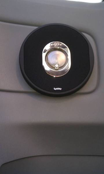

    I don't have an access cab so I haven't dealt with it personally, but it is possible to put speakers in the rear doors of an access cab. If you search within the Audio/Video section you'll see where a few guys have done this. There are places to mount speakers in the rear doors, but no wiring to them. So you'll have to cut the wires to the headliner speakers and re-route those wires to the rear doors. Then you'll either have to cut a hole in the plastic door panel, or buy a door panel from an older model with openings for the speakers. Here's what those two options could end up looking like.
  8. Aug 12, 2013 at 6:05 PM

    Hey Riverdog, the top picture with the homemade speaker grill, is there a thread written up for that one? it's really nicely done, i want to do the same thing.

    '05 Double Cab PreRunner
    I don't know if there's a write up on that or not. Its just a picture that I've seen in a few threads. You might try PMing evanmb31 since I've seen him post that picture in a few different threads. I think he's just reposting it from someone else, but it might get you one step closer to finding the source of it.
