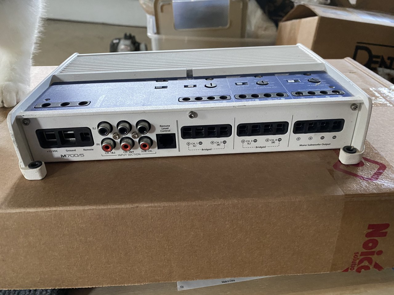

    3A5B8830-F9BE-40C1-BF8D-CA03B4E7CE01.jpg 8F2E34C6-AA52-46F5-8EE5-B1794902C444.jpg Here’s my amp

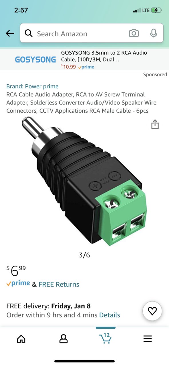

    DDC76452-4424-4A83-9D39-F90DDAE25556.jpg Is this what I need to convert to RCA

    Please use a minimum of 8 gauge Copper wire for the amp power wire. Stay away from Copper Clad Aluminum. Sure CCA works, but.... Oxygen Free Copper is just better.
    This might work for you. I had one when I was running a single amp. it worked pretty good for over a year. just find the one for your model truck.
    https://www.amazon.com/dp/B00CQUL240/ref=cm_sw_r_cp_apa_fabc_FsK9FbT6ZHQNA
    I would also recommend the wired remote for gain control. The factory head unit isn't easy to dial in if you listen to all types of music.
    I ran power wires down the drivers side and RCA down passenger side to prevent any noise. My amps are behind the rear seat
