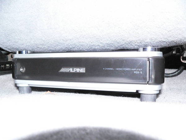

    Here in Mid GA my passengers need the heat in the winter so covering up the heater vent wasn't an option. I chose to lift mine over the vent using some 7/8" dowels.
    The above picture is with the passenger seat pushed all the way forward. Since the back of the seat sits lower than the front it looks like a tight fit but when the seat is in the normal position there's plenty of air space around it.

    ^Titties...nice work!

    ^Thanks ItalynStylion. That's high praise coming from you.
