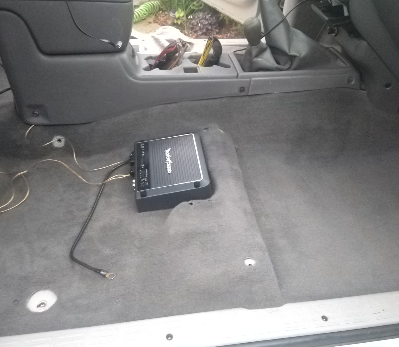

    My amp is mounted under my passenger seat, and with the 2004 I have tweeter mounts on my door panels.
    The door panels on the 2000 don't have a place to mount tweeters, so the easiest option is going to be getting some 4Runner door pods. You can get a set on eBay for $25-30. You'll have to run your tweeter wires through the wire bundle that is visible when you open the door.
    Here's a pic of my amp positioning. I use the rear left passenger seat bolt to ground the amp to the body. The power wire is run from battery, through the firewall grommet, under the driver's side scuff plate, under the carpet towards the center console and then out the other side. The subwoofer out line just goes down the center console.

    Thanks Todd! That is very helpful! I really appreciate the picture too.

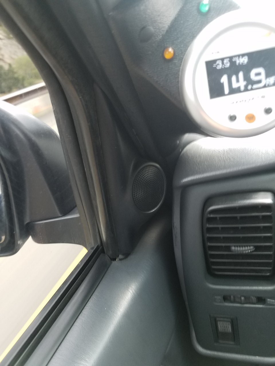

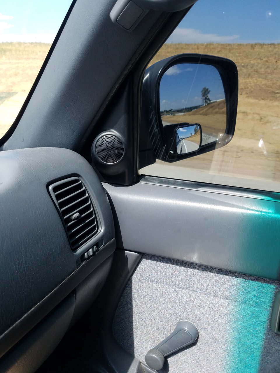

    V6 5sp,RegCab,TVS1320 Supercharger, 56mm pulley, methanol injected Haltech ECU, AC Tvs1320 supercharger,(MUST DO) every 125,000- 150,000 needs rebuild Projector headlights HID 5 speed manual Amsoil for all drive train Smaller 56mm custom pulley, (MUST DO) 2004 DESNO fuel injectors, zero ping ping, 2004 side door mirrors Dick Cepek Rims, Michelin tires LTX, ATM Pathfinders Dynopro ATM ( that last 100,000 miles) Now running Dynopro ATM mud and snow tires KN cold air intake Cat back dual exhaust with ss exhaust tip, Raised exhaust tail pipe to 2" below body line Optima*dry cell battery,red top Alpine sirius radio, 200 watt amp, focal is165 split door pod speakers Focal door speakers Subwoffer behind seat Viper alarm, Electric Locks Dark tinted windows, bucket seats corbeau lg1 Tacoma Rubber floor mats TRD fender extenders, Bilstien shocks, King shocks JBA UCA trailer iv hitch, electric brake control, Drilled slotted brakes, High carbon steel (MUST DO) EBS green stuff 7000 series pads(MUST DO) TRD engine oil cap TRD stick shift, Marlin crawl shift kit. Rear sliding window 2002 4Runner functional hood scoop cut into Tacoma hood, 4Runner dual overhead map light Gentex Auto dim + Compass + Temp, garage,rearview mirror Snow Methonal kit stage 2 Custom 3 core aluminum radiator Linex bed liner Haltech stand alone ECU, Intake supercharger gauge. Stainless steel brake lines, Custom leather wrapped steering wheel, Haltech stand-alone ECU,
    300 watt Alpine amp, component speakers, 4runner sail pods for tweeters, 10” subwoofer,

    4runner pods
