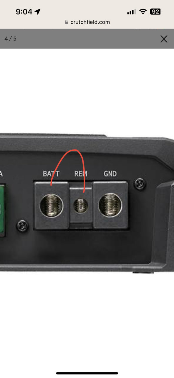

    Run the remote wire to the regular amp. Disconnect the remote wire from the sub amp
    Your sub amp should have power inputs similar to this. You want to jumper the power and remote connections and that will turn the amp on.

    No this is just a test to see if both amps stay turned on. Trying to just narrow down the possible options

    Ok both amps stay on and play fine with jumper attached. Weird thing now is I turn off the ignition and the amp green light stays on!! This wasn't happening yesterday. When I undo the remote wire to the amp it turns off. But with the vehicle off should the amp be measuring 12v at the battery and ground input of the amp on my multimeter?

    That’s because the power wire is always hot, and the jumper is making it stay on.
