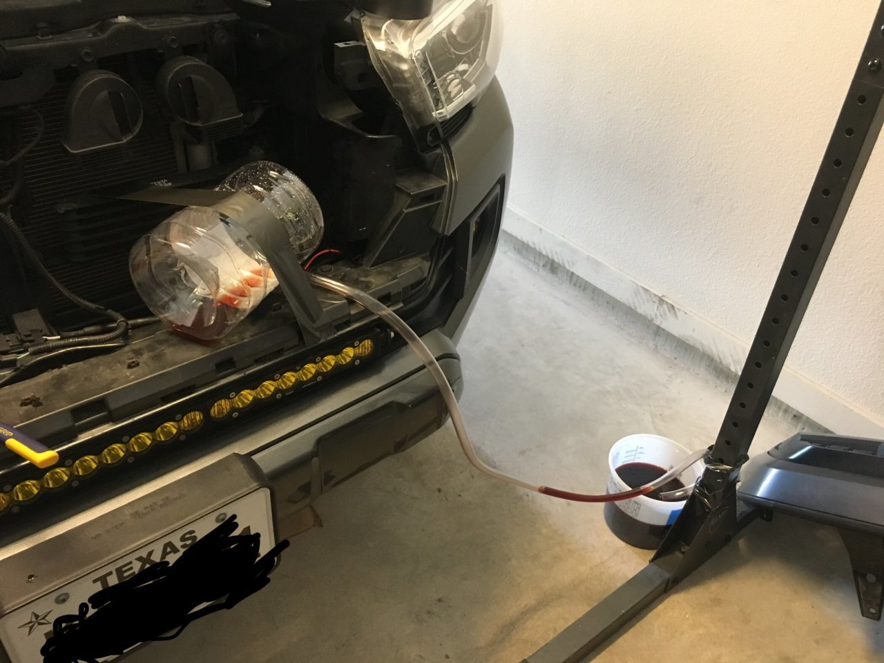

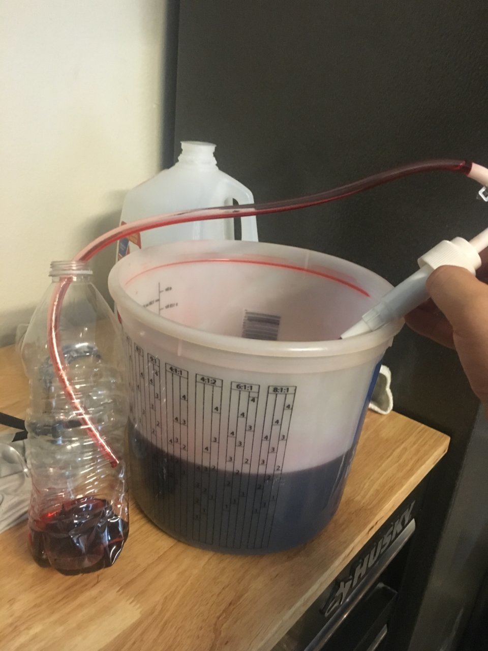

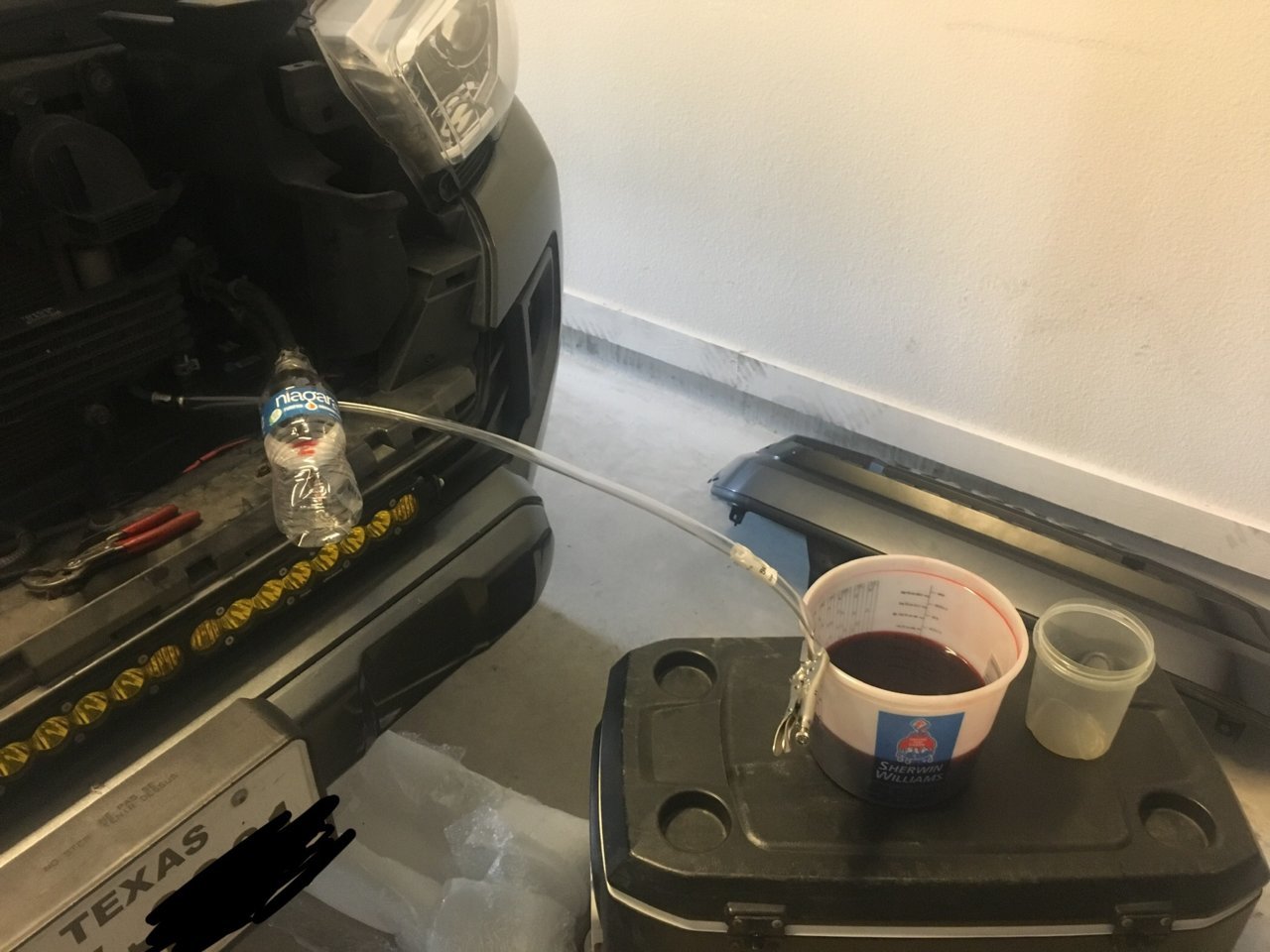

    Hit 50k miles, doing a transmission drain & flush in my garage. This is what Amsoil ATF Signuture looks like after 25k miles in my 2017 Tacoma. I previously done a complete drain & flush just shy of 25k miles on odometer. Complete flush of Toyota WS via draining, topping off, tapping trans cooler line, crank over, repeat. However this time around instead of draining out 10-11 quarts, I just drained and replaced 6 quarts since the Amsoil had plenty of life remaining. I’m quite happy with the Amsoil ATF Signature. Likely do next 6 quart flush at 75k(if Taco is still around, eyeballing Tundras at the moment).
    FYI, I mall crawl in Texas heat, tow a single axle utility trailer with SXS 3000 lbs gross a few times a year on 6-7 hour road trips. My scangauge TF1 & TF2 hangs out about 195-203 normally while driving. Sometimes it’ll go up to 208 on occasion with my spirited driving. While towing it’ll sit about 198-205, but will jump up to 215 if I attempt to pass or going on prolonged incline.
    E2C46F86-7688-42C8-B914-0CEEDB970A72.jpg B7832087-445D-477F-AA05-7F1D6ABA52B6.jpg F392FC0C-4956-44B4-AA23-46550B94B13C.jpg 2699409C-91D3-4379-BA77-9CBA857AC4D9.jpg

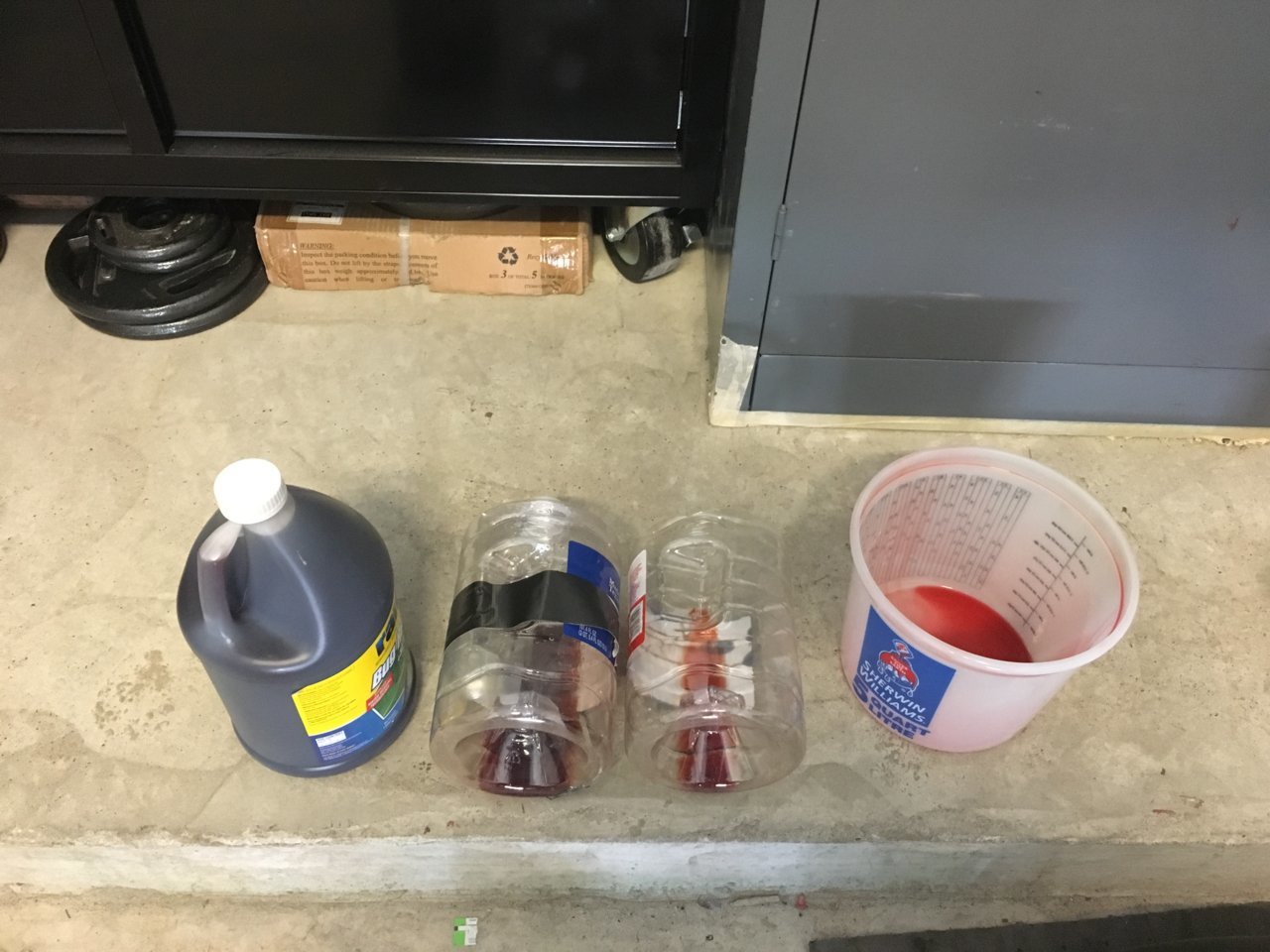

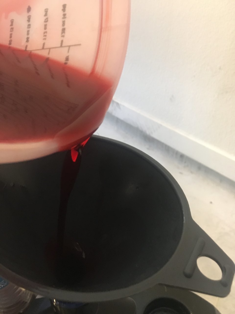

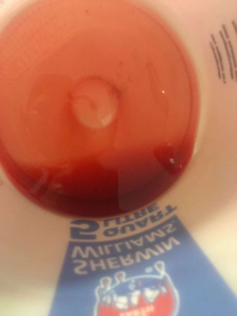

    Didn’t get better pics(down below) back then at 25k miles, but you can see in pics the Toyota WS fluid is darker. I remember seeing much darker red color. It wasn’t burnt at all, just deeper red. The first pic below from left to right:
    Gallon of WS with 25k miles first few quarts, gallon from return line(using as drip can), gallon with WS & Amsoil ATF Sig finally pushing thru at transcooler, paint bucket with fresh sample of Amsoil ATF Sig.

    you should send in a sample to a company like blackstone. The color doesn't really tell much. All fluids will get darker with heat.

    Yep not exactly science what I'm doing, just visual from my point of view. My previous 2007 Tacoma is currently over 250k miles without issues. I never touched the transmission fluid ever, been riding the same fluid since day one. On this 2017, decided to do transmission fluid drain and check the fluid level from factory.
