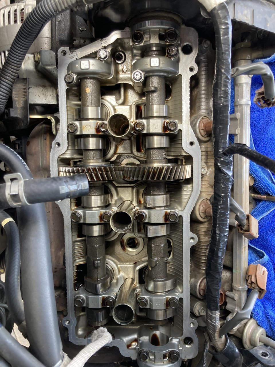

    I don’t know. My pops runs Amsoil in his 2004 Prerunner with close to 300k and when he finally replaced the valve cover gaskets this summer the top end looked like this. Maybe there is something to it. Personally, I run Mobil 1, so I have no dog in the fight on amsoil.
