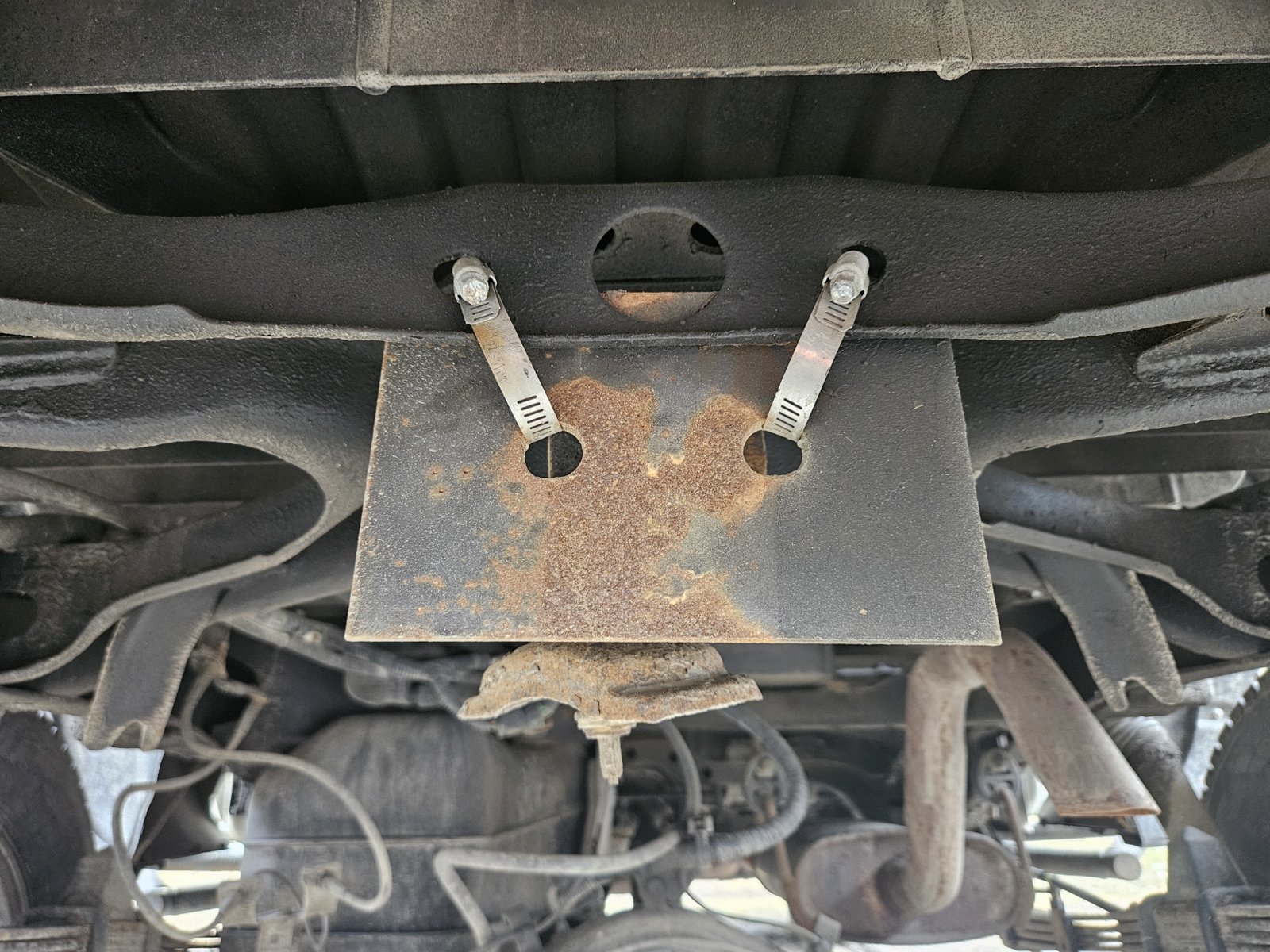

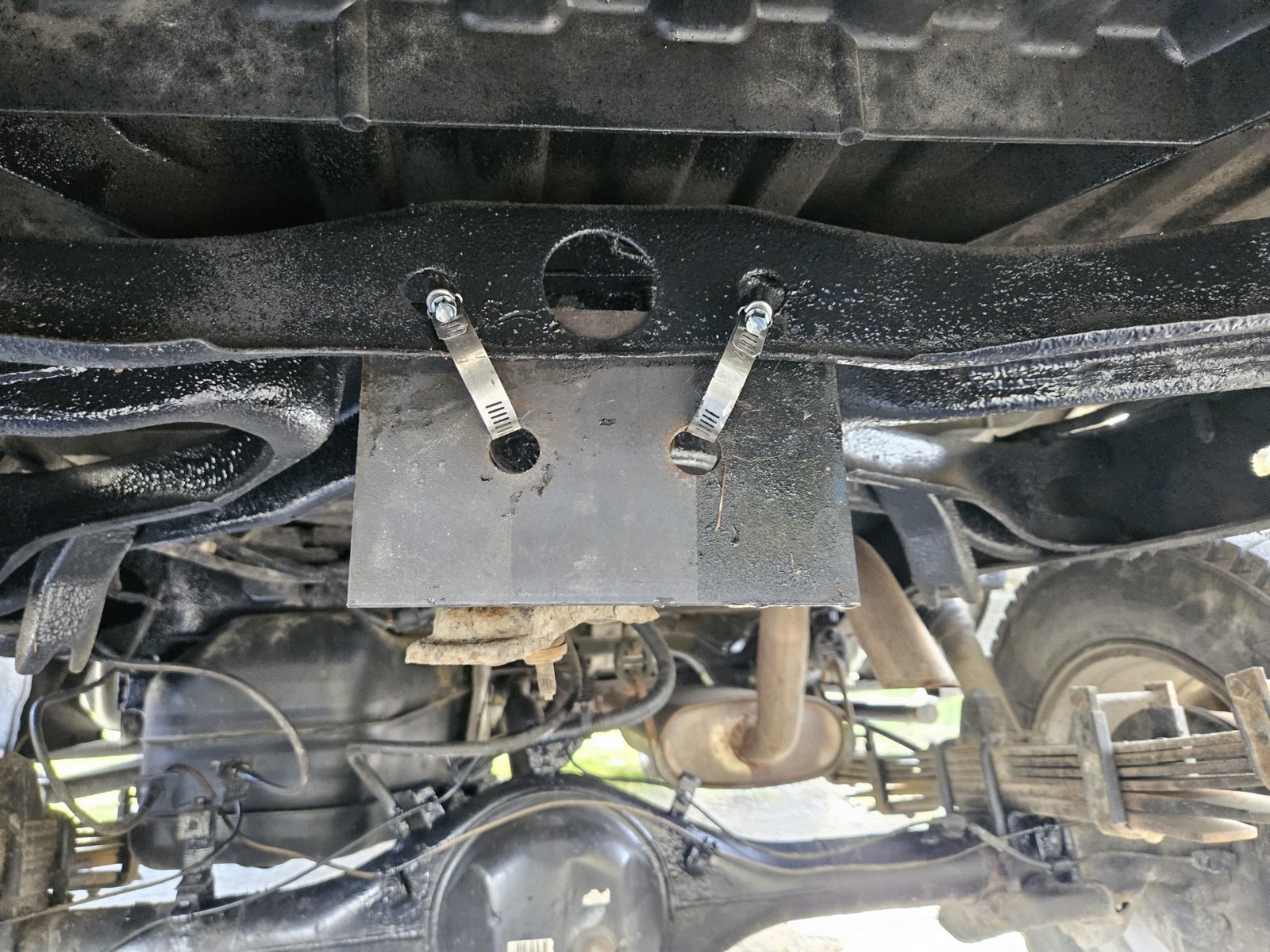

    Before they started salting this winter, I hung a piece of clean scrap steel off of my spare tire carrier.
    I treated one third with Amsoil HDMP (left), left a piece of bare steel, and did the right third with Woolwax.
    Now that one salt season has passed, here are the results:
    The WW is completely intact, and the HDMP has visibly eroded. It's even worse on the side facing the front, which was treated identically:
    You can see the HDMP is as good as gone, while the WW is, other than some dirt, pretty much unchanged.

    I'm not aware of different grades of WW - I use the same product that comes in their "includes gun" kit with 4 ea. quart bottles, and top them up from a larger container when they empty. I will assume it's the "standard" or "regular" grade.
    I haven't tested FF this way, although I coated a piece of chain in it years ago to lock up my HiLift and it has been in the open bed since then. It isn't directly exposed (threaded it into/ziptied on a piece of innertube) so it isn't a fair comparison, but even the exposed ends look great compared to untreated chain only a year old.
    Regarding it melting off, you can see in the above results that the thick outer layer as applied with the gun has definitely been blasted off, but it has clearly penetrated/clung to the metal well enough to still be protective. I would say as far as exposure for the test plate goes, it's not gonna get much worse underneath the truck except maybe the front face of a mudflap.

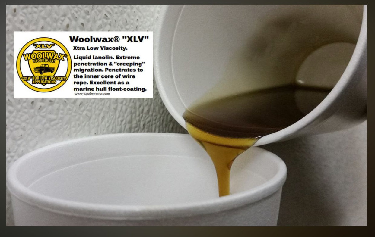

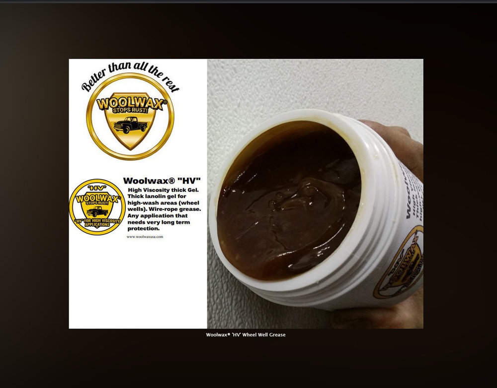

    WW has regular grade, XLV grade for doors tailgates that creeps well ultra thin
    and then the HV grade that is pastelike that is super thick in the cold and WILL Stick to even body panels
    goes on best in the hot summer sun with a small brush
    this is the XLV

    and the HV grade
