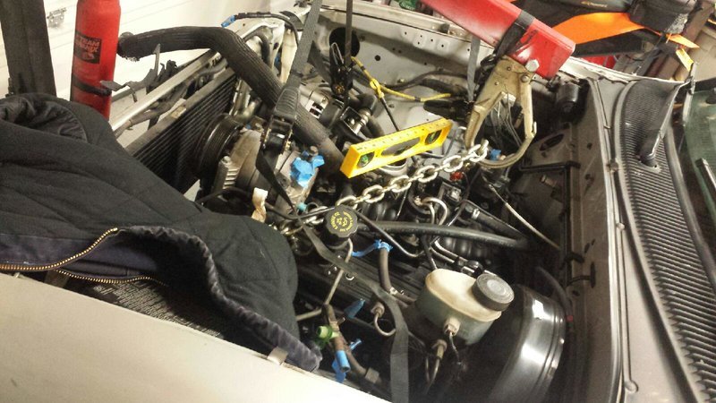

    I am beginning my build of an 03 Tacoma doublecab. Bought the truck in july with 160k on it. Drove it home ran awesome. Had the 3.4L auto tranny and 2wd pre-runner with e-locker rear diff.
    My plans for the immediate future:
    5.7L Vortec 350 SBC
    nv4500 transmission
    t-case, undecided, np205/ dana 300/ eventually an atlas
    Dana 60 kingpin front axle 3 linked and full hydro steering
    14 bolt rear axle 4 linked
    That's on deck soon. I started mocking up the engine and transmission in. Ill post up some pics soon.

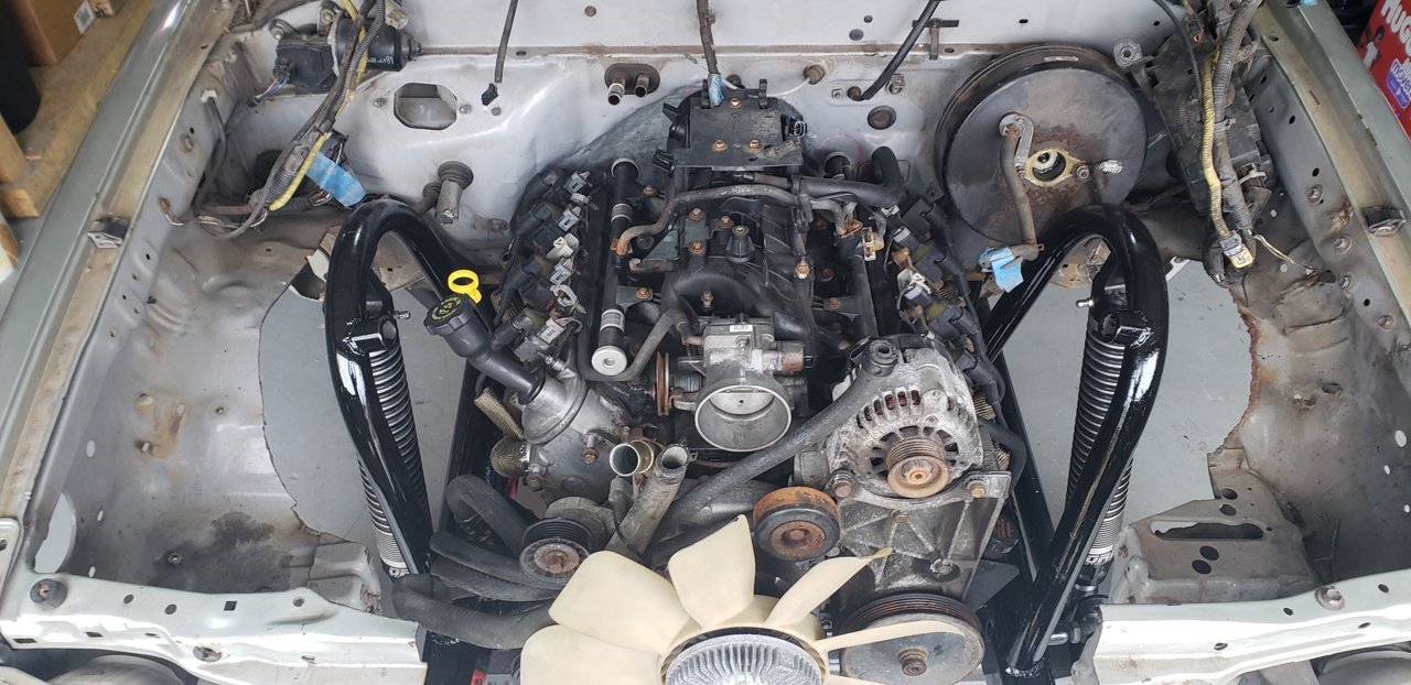

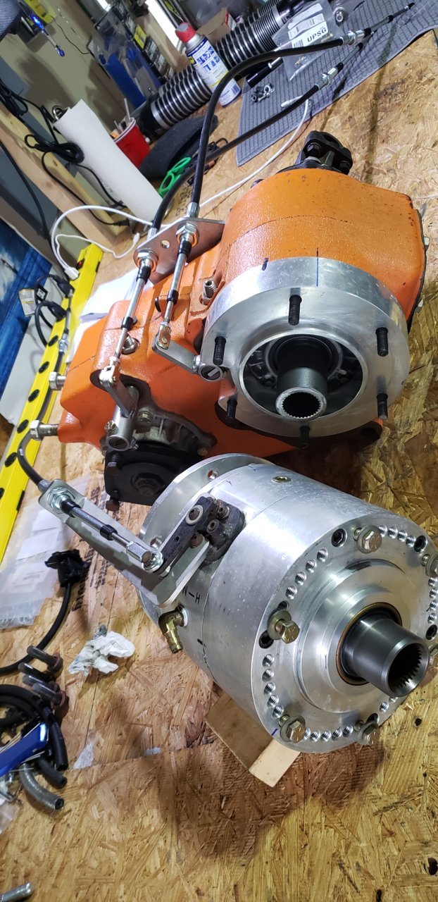

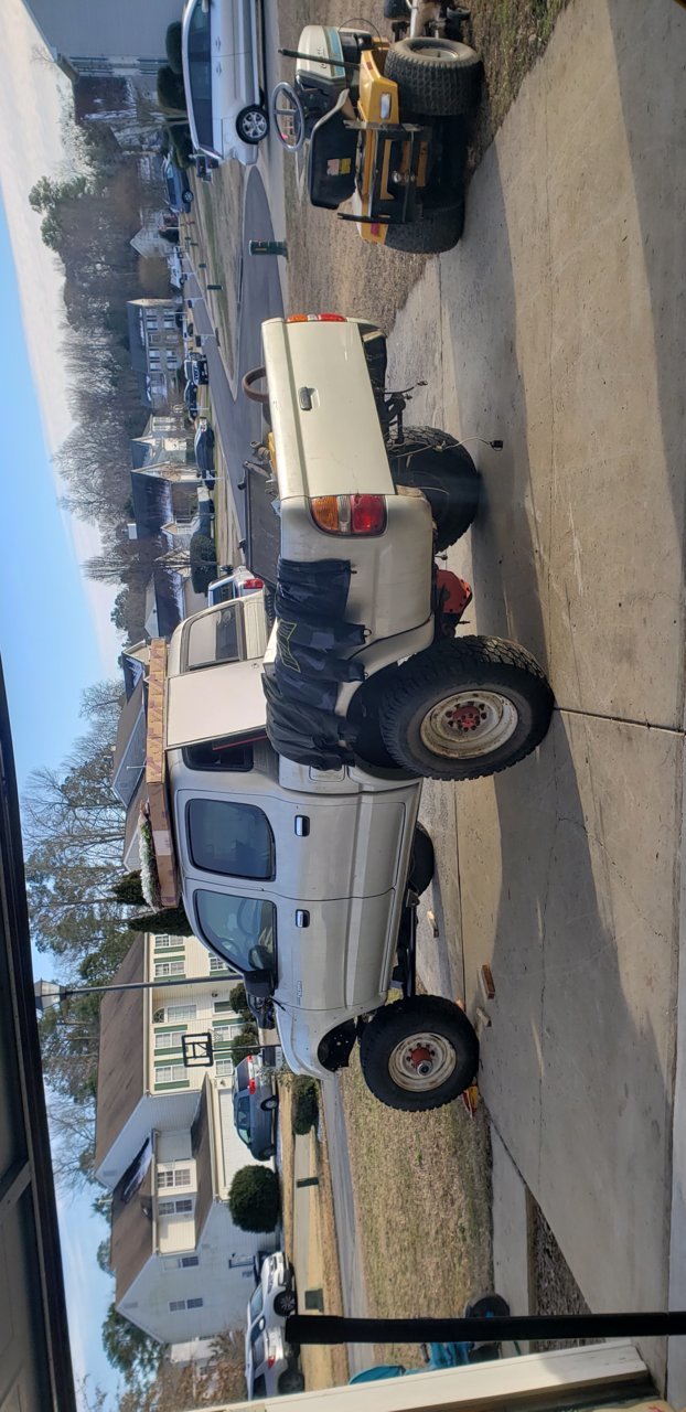

    current update:
    moved this summer so the build has slowed down/stopped. The new house has a stupid steep driveway but we might be moving across the street to a better spot. Truck is on the trailer at the storage unit awaiting surgery.
    But I finished up the 3 link in the front. Front axle is welded in solid on 18 ORI struts.
    Engine, tranny, crawlbox and t case are mocked in place and somewhat welded in for the cross country journey it took. Need to build my tranny/tcase mount and skids. I ended up putting a behemoth drivetrain crawlbox infront of my np 205. I rebuilt the 205 to allow for twin sticks and front dig. So I will have some pretty low gearing options when I cut it to low low.
    The rear end has the 14 bolt wedged into place on the stock suspension setup. Once I get the front end fully welded (link mounts etc) I will spin the truck around in the garage, take the bed off and start 4 linking the rear.
    I moved the front axle forward about a foot id say. Mocked placement for 44" tires. with enough room to clear the firewall.
    I plan to keep the interior as stock as I can. With the exception of a triple stick tower in the tranny tunnel. And upgraded seats with 5 point harness. New stereo obviously.

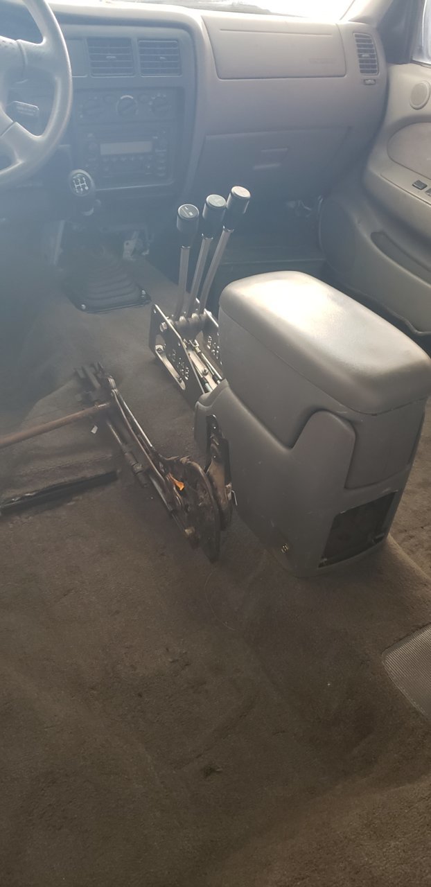

    Alright next update:
    I pulled the 5.7 out and went with a 6.0 vortec. Im currently working on the rear 4 link with 18" ORIs.
