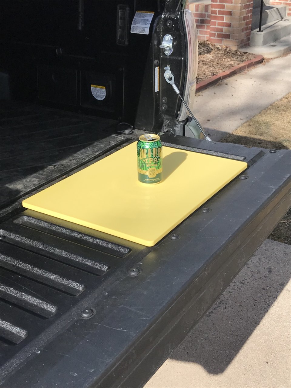

    I've seen a few drinks spilled while tailgating, I'm sure we all have. I also didn't want to spend a couple hundred bucks on a flat tailgate liner to solve the problem because I wouldn't use it enough to justify the price.
    So here ya go, don't say I never did nuthin' for ya. The total cost was roughly $25 and 15min of effort, links below for what I used.
    My local restaurant supply store doesn't require an industry account to shop there, so I do! In general, it's the best place to get good stuff for your kitchen. I got a 15x20x1/2" polyethylene prep board:
    https://restaurantequipment.com/collections/cutting-boards?uff_jipwdb_vendor=WINCO
    Rubber bumpers from Home Depot:
    https://www.homedepot.com/p/Everbilt-1-in-Heavy-Duty-Anti-Skid-Surface-Pads-4-Pack-49644/203661092

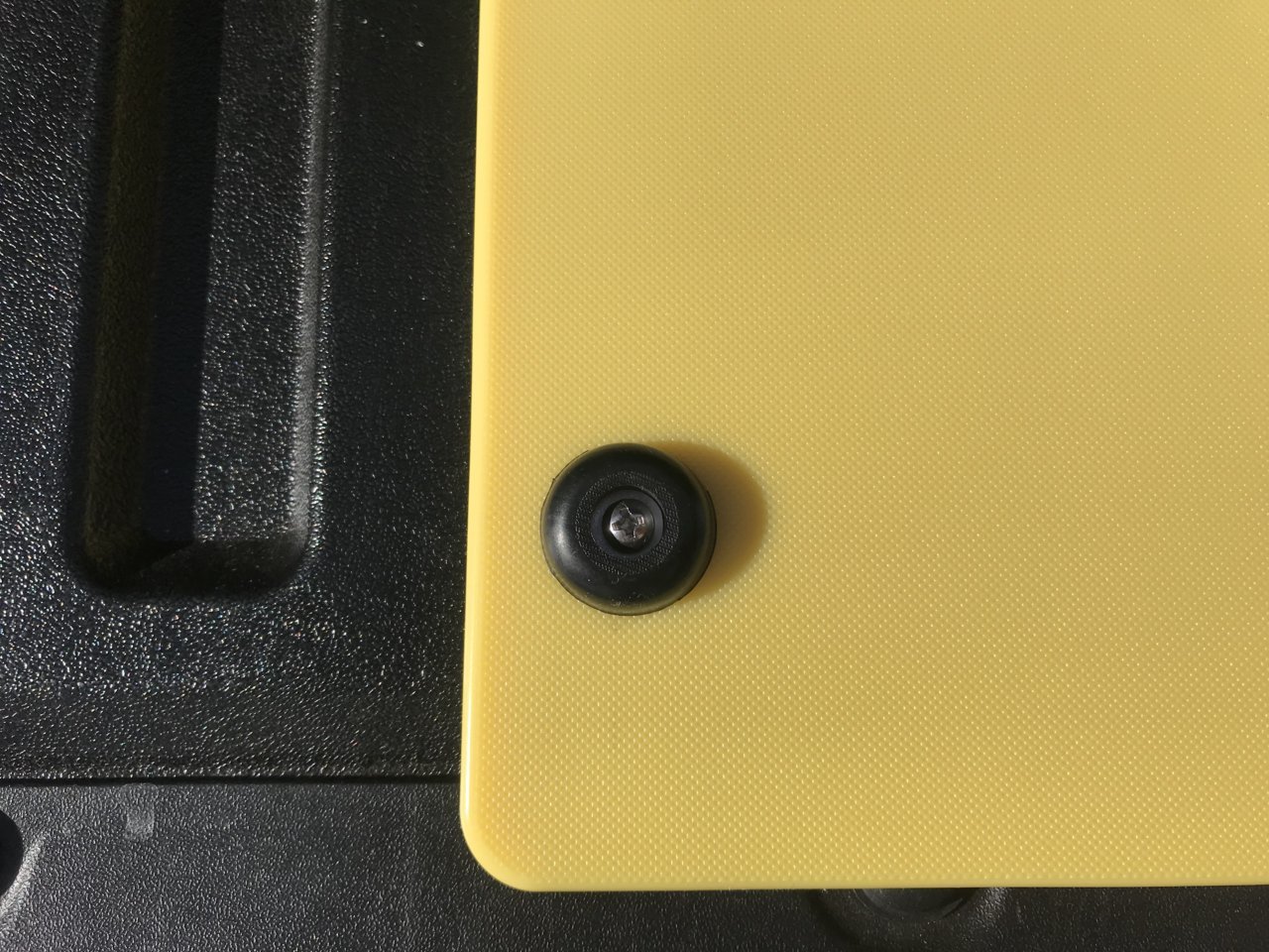

    Since the provided screws were too long I also picked up a 5-pack of #8 x 1/2" stainless pan head phillips screws from the sheet metal section (~$1.28), and the smallest pack of #8 split ring lock washers (~$1.28) to choke up the length of the screws a bit more (and I guess, to lock them in...)

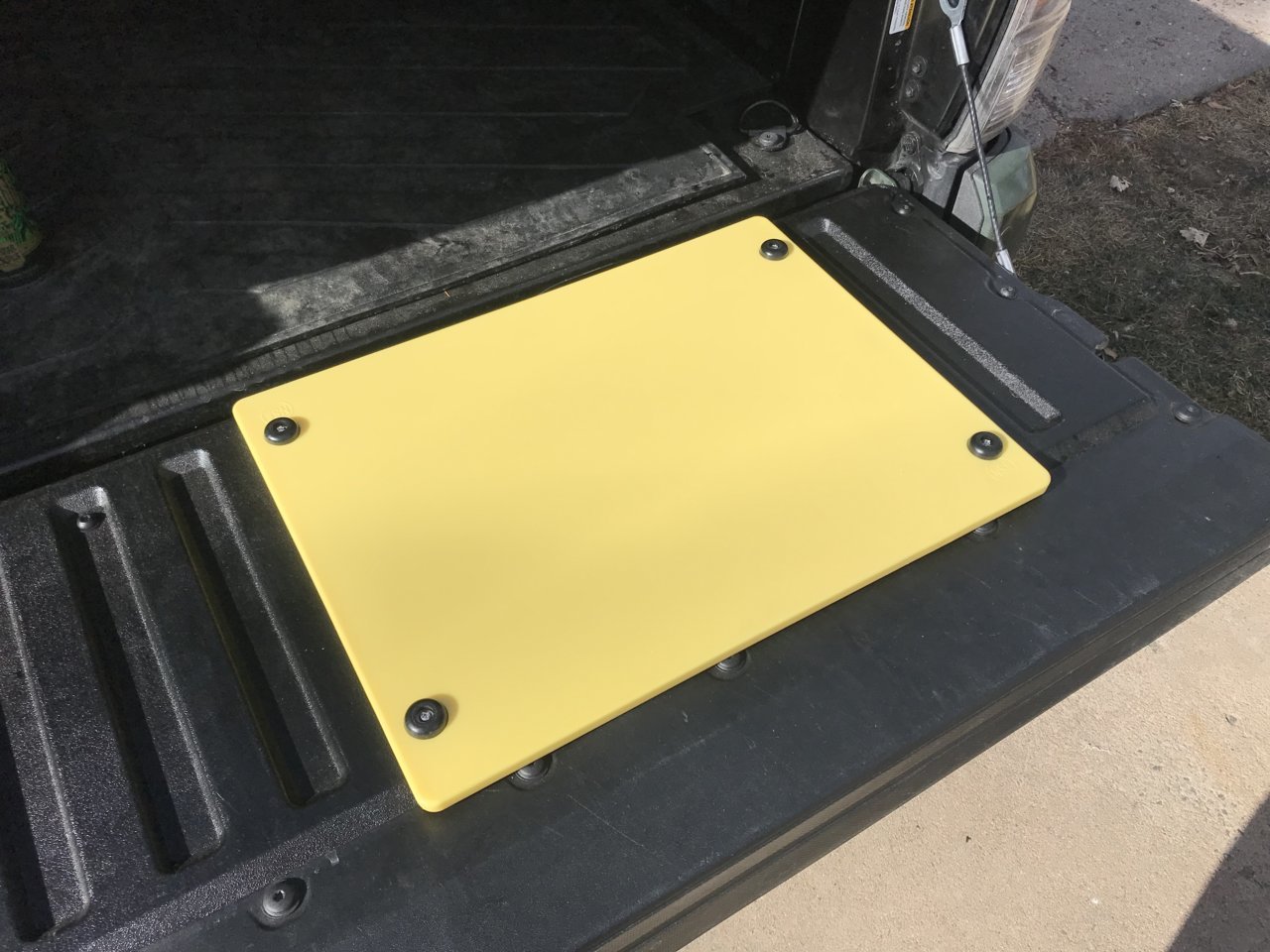

    I dropped the bumpers into the slots to measure the layout such that it wouldn't wiggle, and taped the depth on the bit to not drill all the way through. The screws bit and held nicely, but we'll see how it holds up. This is more than enough surface area for me and a tailgate's worth of folks to have a place to set their beers. Since it's a prep board, it's good for food at the tailgate or campsite as well. I just flip it over and leave it in the bed when not in use. Enjoy!
