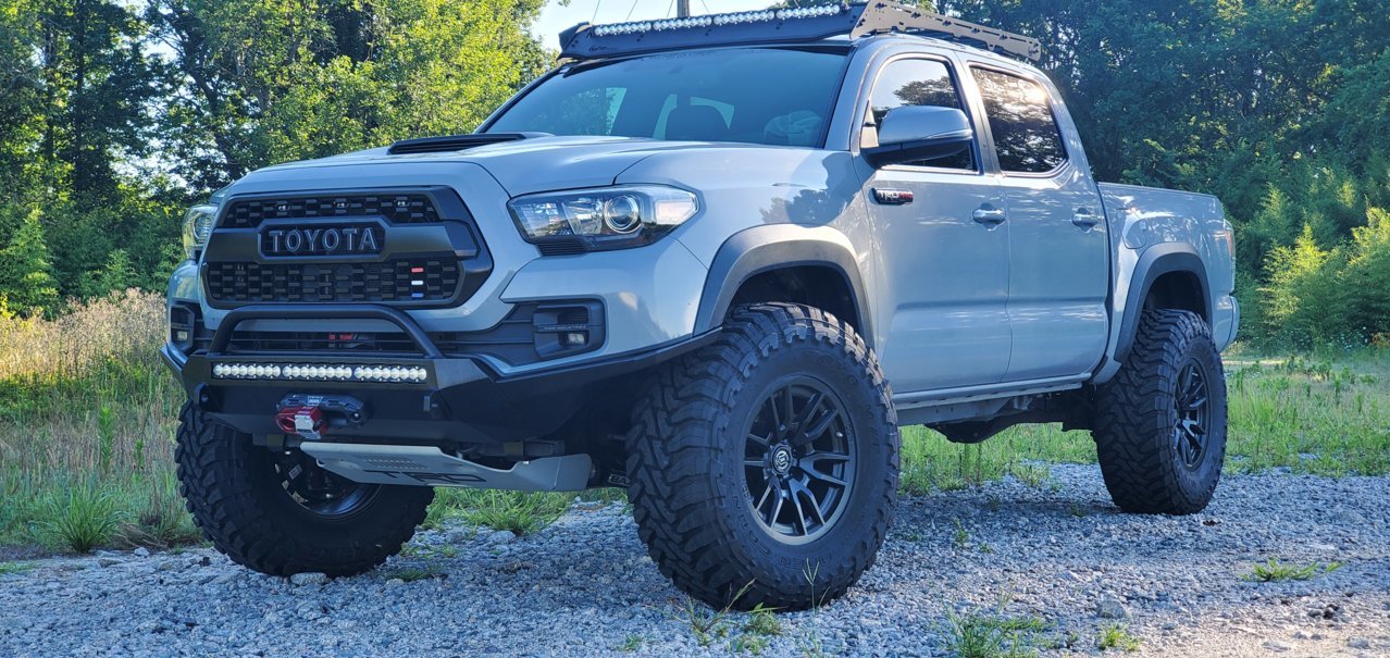

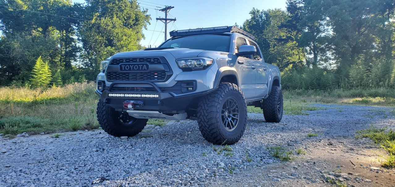

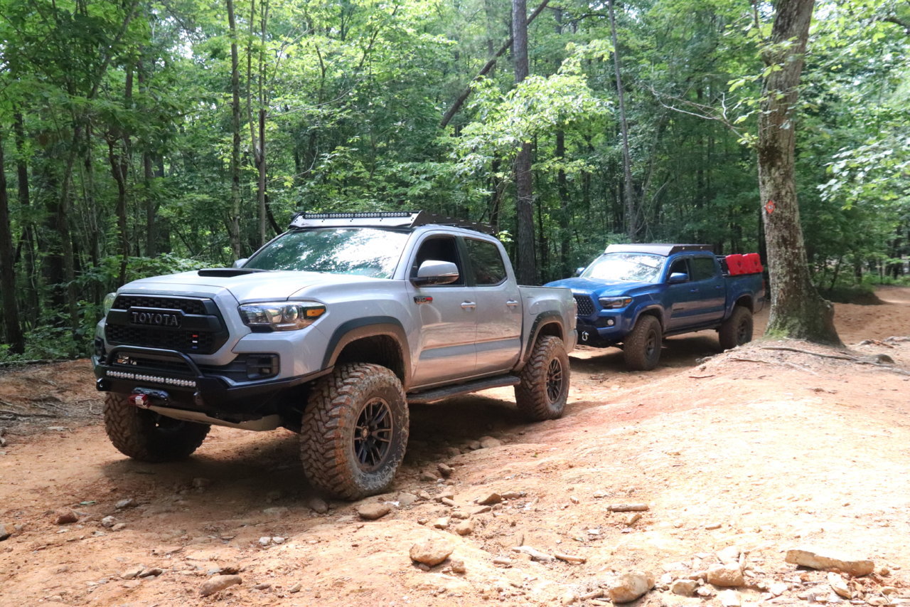

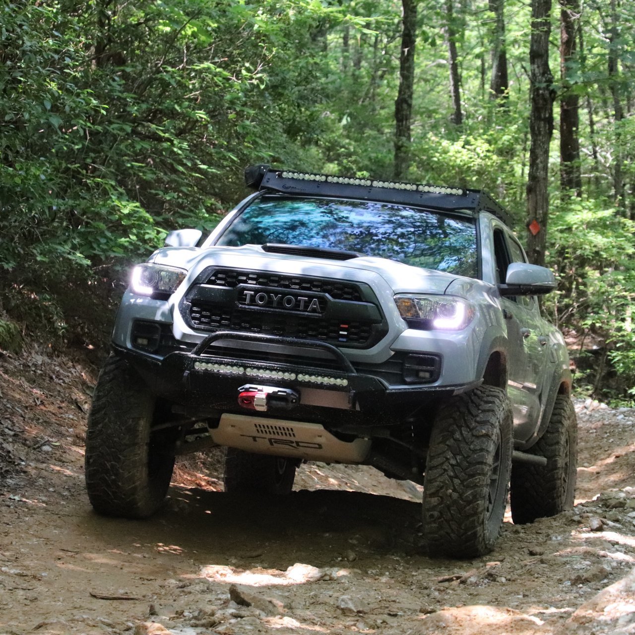

    Just added the SSO Front hybrid bumper, Stage 2 wings, Warn evo 10s platinum, factor 55 flatlink e and a 30in s8 baja bar.
    3pooches, MGMTacoGuy and GundyTRD like this.

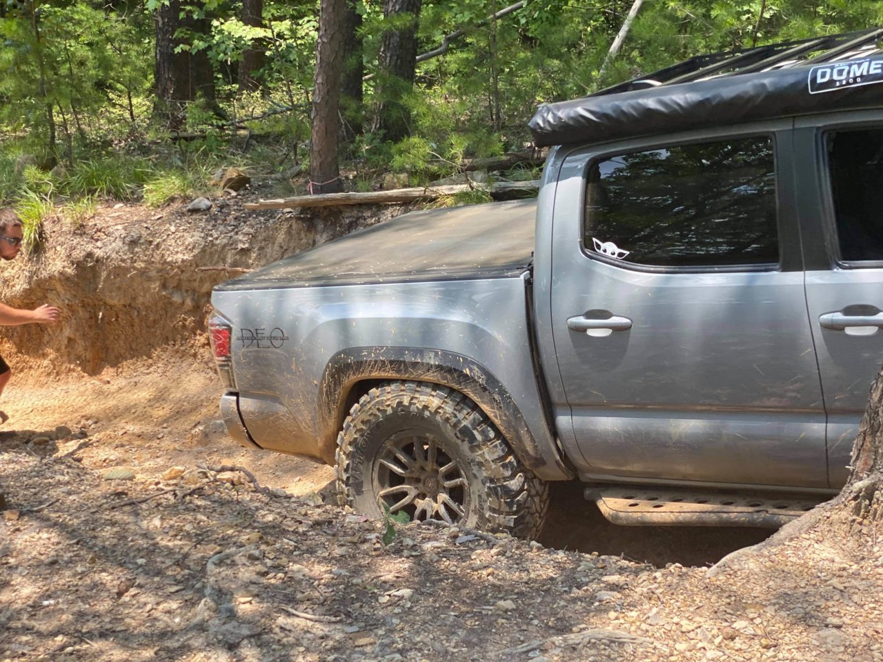

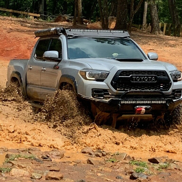

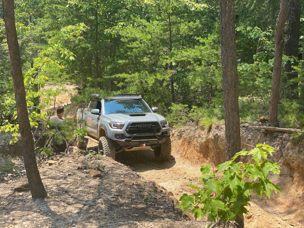

    Finally got the truck to the trails. I'll tell you if you got the money and the time this suspension setup is amazing. This truck made it thru places you would never thing it could.
    3pooches and naptime810 like this.

    wow nice. i like your post 19, very last pic; looks sorta lunar rock. tell me im wrong!

    Nice looking truck!
    Got the same winch and bumper. Just getting ready to install the stage 2 wings. Any tips? And what did you do with the fender liners? Thanks!
  13. Aug 15, 2020 at 8:22 PM
    #33
    Deo taco
    Deo taco [OP] Well-Known Member
    Jan 11, 2020
    #315775
    598
    John
    2017 trd pro in cement grey.
    Lots to come
    watch the video sso has out on cutting them. then watch it 5 more times and get a sharpie and 2in painters tape. use the painters tape to mark the measurement points along the way you will be cutting. then use a straight edge to connect those dots on the tape and use that to cut. have a nice sander to help sand the edge back as you need to. it just takes time and patience. on the inners i cut high and straight across from the corner you make in the wheel well

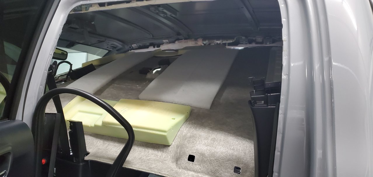

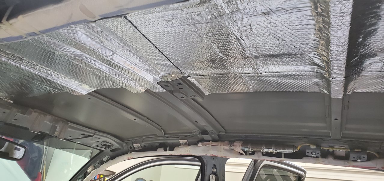

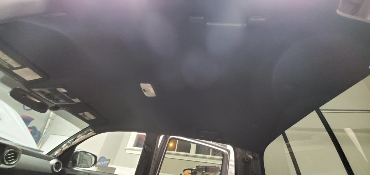

    Hate to bother but have to ask how you removed the headliner? Always been fearful I’ll mess something up if I were to venture on to do that without knowledge of how to and haven’t ever seen a YouTube video of it in action. Thanks
  15. Aug 16, 2020 at 8:47 AM
    #35
    Deo taco
    Jan 11, 2020
    #315775
    598
    John
    Lots to come
    To remove the head liner. You have to remove all the seats, all the a pillars, b pillar and c pillar plastic. Then the roof console and the rear o shit handles. Then it will drop down.

    Thanks. Will order the sound deafening and have a weekend project later.

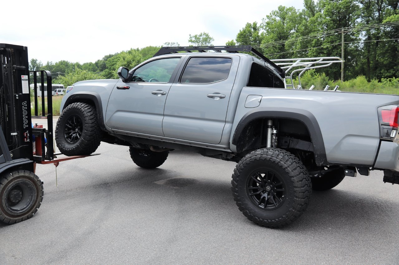

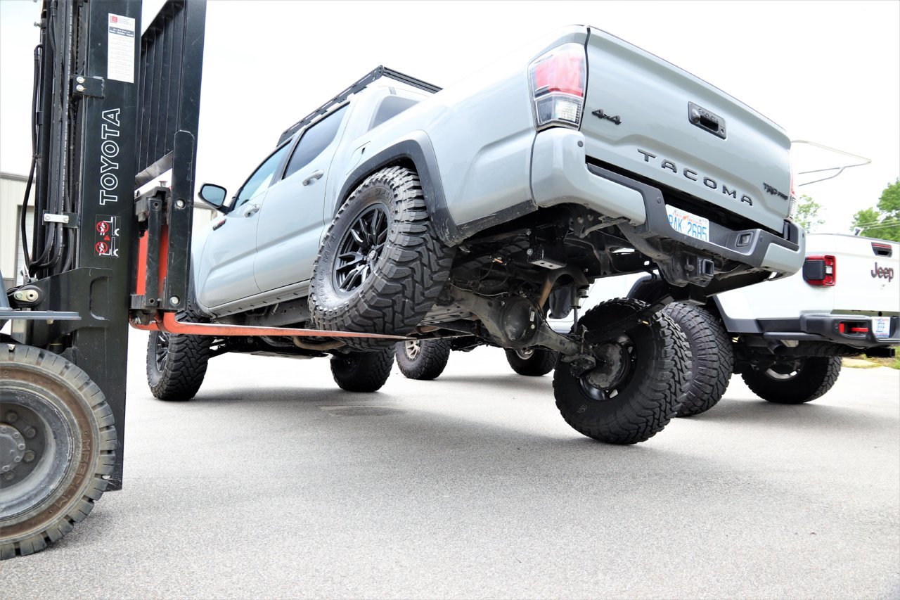

    How did the rear shocks work out? The resi looks close. What shocks are they?
  20. Oct 5, 2020 at 6:04 AM
    #40
    Deo taco
    Jan 11, 2020
    #315775
    598
    John
    Lots to come
    the rear did work. i have some adjustments to make but they package, but its tight.
