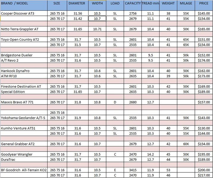

  5. Nov 21, 2015 at 8:42 AM
    SCHALICKE
    SCHALICKE Utahrd
    Nov 18, 2015
    #170049
    255
    S. Champ
    Clearfield UT
    2015 Tacoma TRD OFF Road
    Never Enough
    I posted this in another thread but you may find it helpful. You can see in the spreadsheet that SL & C rated tires are rated around 2600lbs each. That is just about all a Tacoma can handle hauling and towing anyways. Plus you get a smoother ride over D or E rated tires.
