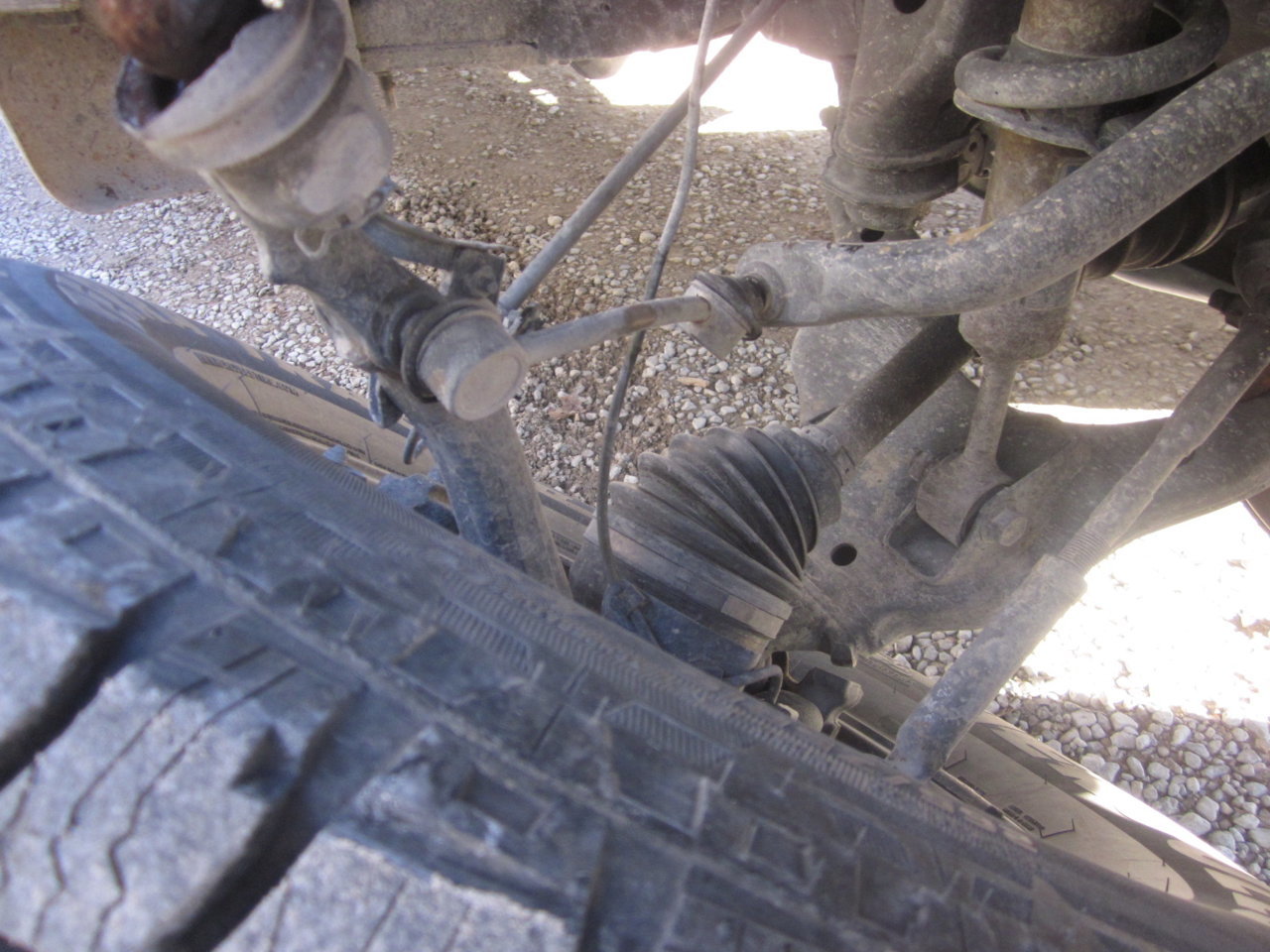

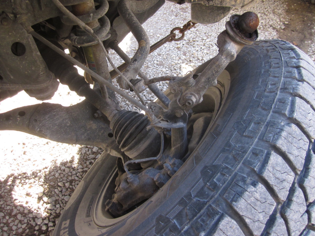

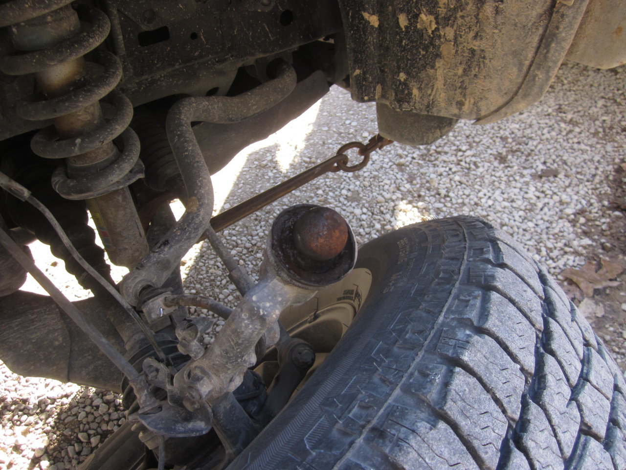

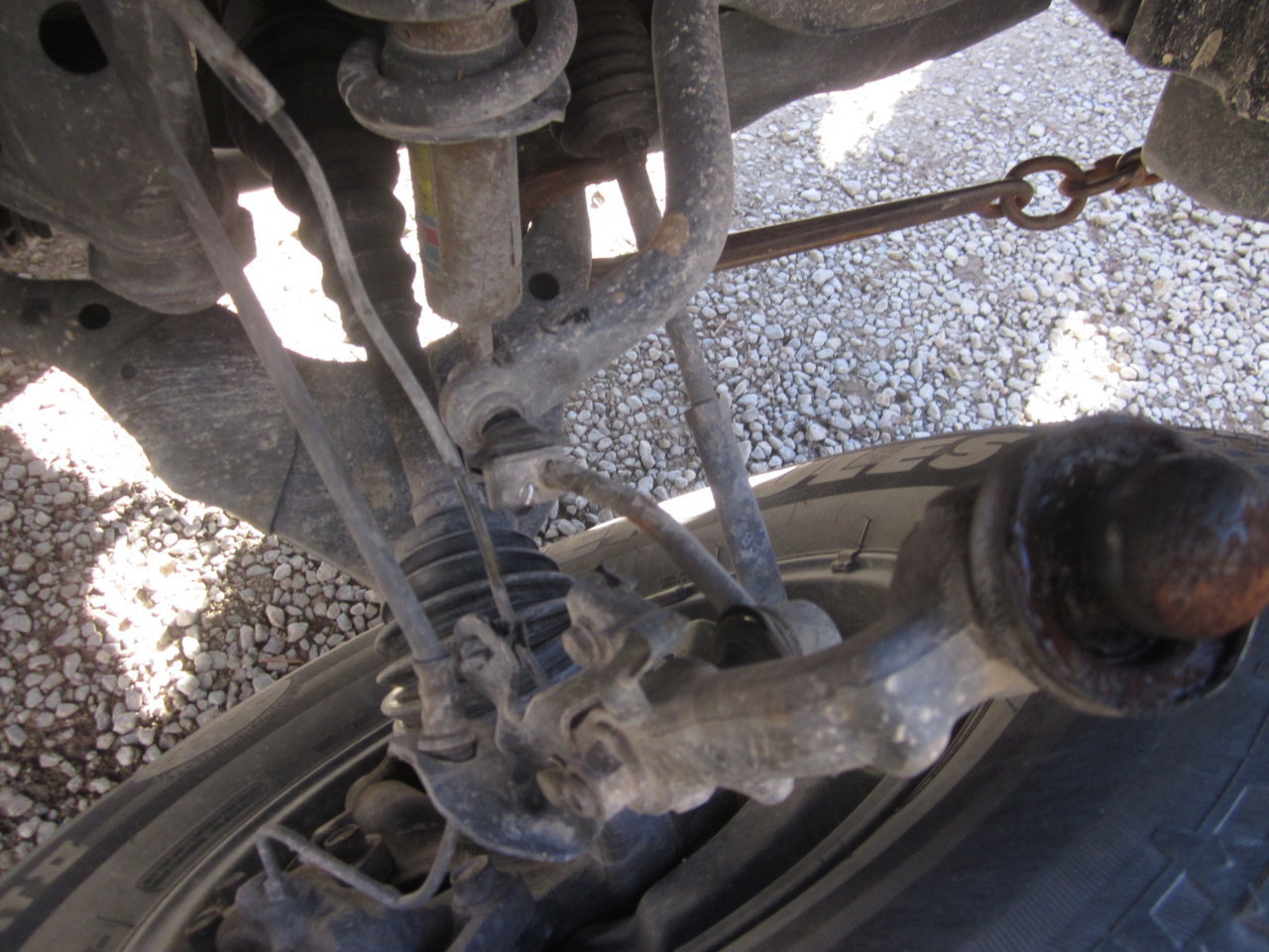

    Here you go... Pics.
    I am replacing both sway bar links, since the one is pretty bent, AND, the Axle on the Passenger side is being replaced since the CV joint is either damaged, or about to take a dump.
    But, it's not as bad as it could have been since I'm getting a bit of a break on the parts, and a local mechanic is doing the job for somewhat less then "Book Rate" for labor and the like.

    DAMNN MAN
    Looks like the sway bar end link was your saving grace keeping you from completely losing your wheel and dying.

    Glad you’re ok. That ball joint looks pretty old, worn, and rusty.

    I'd take a real good look at the brake line too. It's stretched pretty tight in those pictures. Don't just look for the obvious leak, make sure the rubber is still sound and doesn't have cracks or signs of damage from being stretched that could cause problems later on.
