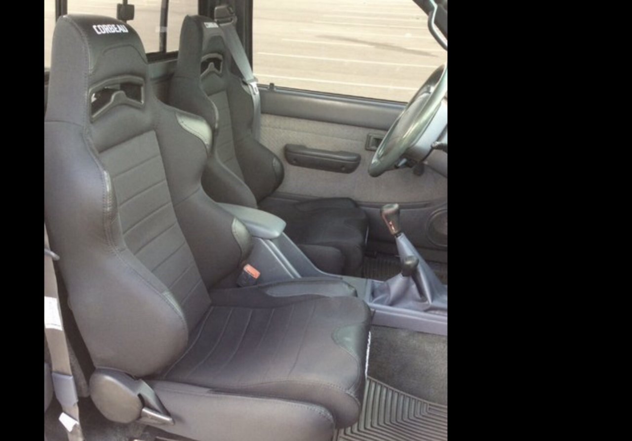

    I really like either the Corbeau or Recaro seats and their seat tracks that bolt right up to the OEM seat track holes on the floor. No need to fabricate or cut anything. That being said, I've seen some pretty good seat retrofits with car seats from other vehicles with some custom fabrication to fit the OEM seat tracks on this forum. I've also seen some people pull seats from a 4Runner Limited with the lumbar support. There's also aftermarket seat covers with pads that you can add to your truck seat yourself. Okole or Cover Kings has that type of seat cover with padding & heating in it.

    Corbeau Are direct bolt in with their brackets.

    I have early 2000s Celica seats in my 2000 reg cab. Just drilled new holes in the floor and made sure that the feet that need it got a spacer to level them out. Been holding strong for over 10 years now. I got rear-ended once back in 2014 and there is no evidence of them even budging. I race this thing at least once per month(or try to when the weather is right) doing autocross and they work great.

    Recaro is super expensive....
    Corbeau is way more realistic and available with bolt in brackeats. That's the way I'm going to go.

    I will say, a lot of Corbeau owners seem to be very unhappy with their seats compared to those that own other brands.
    More often than not I read about how uncomfortable they are (subjective), and most importantly, their lack of quality. Maybe this is the reason why they have a great return policy? So if you don't like them, you can always return them.
    I opted against Corbeau and went Sparco instead.
    If you can, I'd look up Authorized Retailers in your area and check them out in person before committing.

    I have a set of Corbeau Sports, and they were definitely an upgrade over the stock seats with worn out foam. But they really aren't the same quality as a good OEM seat in my opinion. My old 7th gen Accord with 180k on the clock had more comfortable seats that fit my body better. If I was doing it again, I'd probably look for some clean seats from a Honda/Acura coupe.
    That said, if I ever come into a big chunk of money I'll be buying Scheel Mann seats. :spending:
