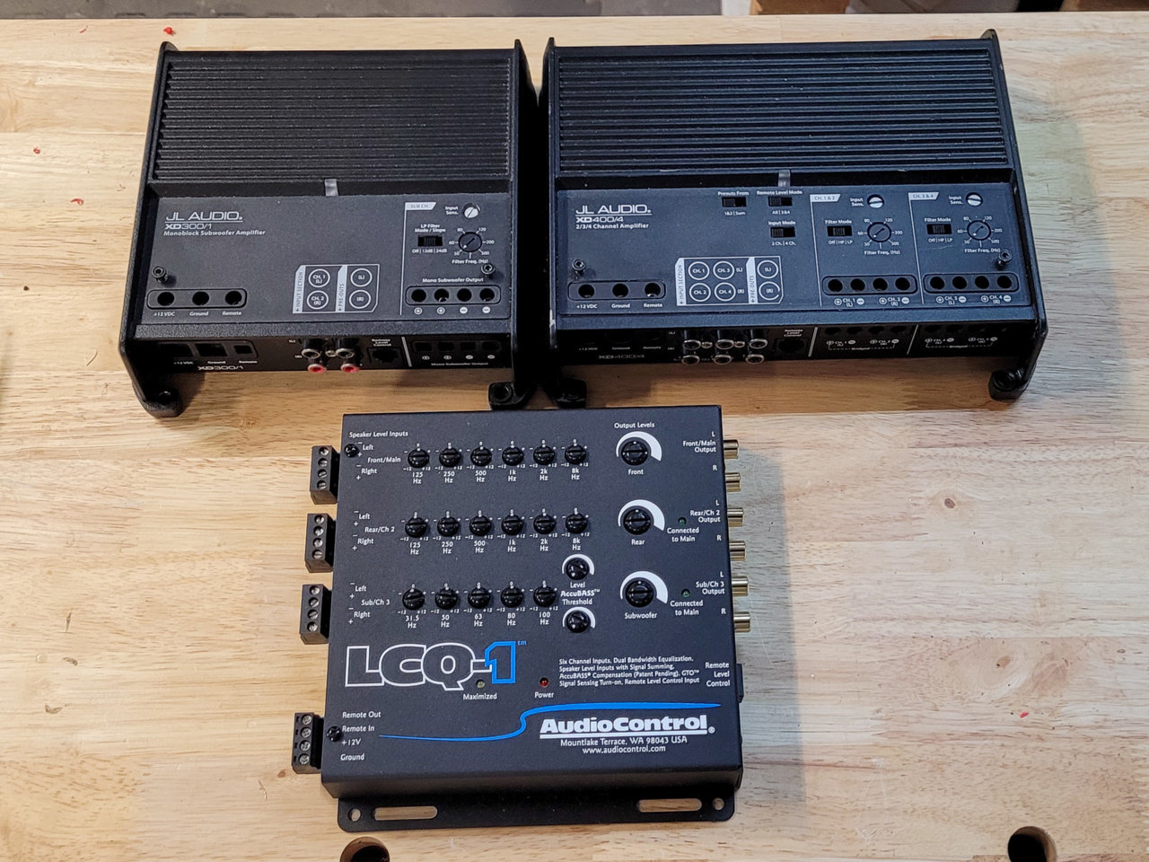

    I don't care for class D amps but let's be honest, the Tacoma doesn't leave room for big class A/B amps if you still want a usable vehicle. I've got people in the back seat regularly and still use the truck as a truck so I have to work within the boundaries given. That said, these little JL amps aren't too bad and will do for now.
    The XD400/4 will likely be bridged to the front stage and the XD300/1 for sub duty. Depending on how that goes I may swap it out for a 600/1 down the line.
    The LCQ-1 will be pulling LOC and EQ duties as well as restore any lows that the factory head unit processes out at higher volumes.

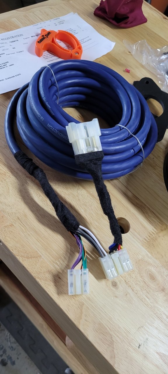

    Picked up a new soldering iron finally and got the wiring harness ready with the speed wire and pass through connections.

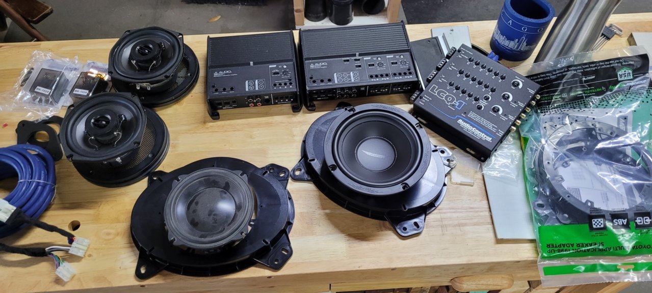

    Also trying to make a decision on which speakers I want to use. The Morel are a much better speaker but their only 5.25" vs the 6.5" on the Image Dynamics which will give more mid-bass punch. I may do the Morel first and decide later if I need the larger cone area or not.
    I have some smaller coax for the rear doors.

    I wish I had that option. No matter which mid I go with, I'll have to use the ID tweets.
    The damn Elate tweets to match the mids are like $800 which is out of the budget right now. The original tweets from this set were I think lost in a wreck from the previous owner and I got the mids and crossovers in a trade from him.
    The ID tweets are weak and there isn't enough room under the dash for horns. Some day I'll stumble across a pair of Elate tweets for some affordable price. Holding my breath.
